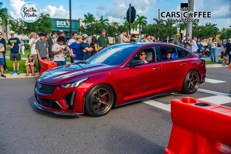

Dunno if it’s easier to see how much fender gap are there.  Really the ultimate goal of the lowering springs is to lessen the rear gap. Fronts on stock springs aren’t that bad upfront.

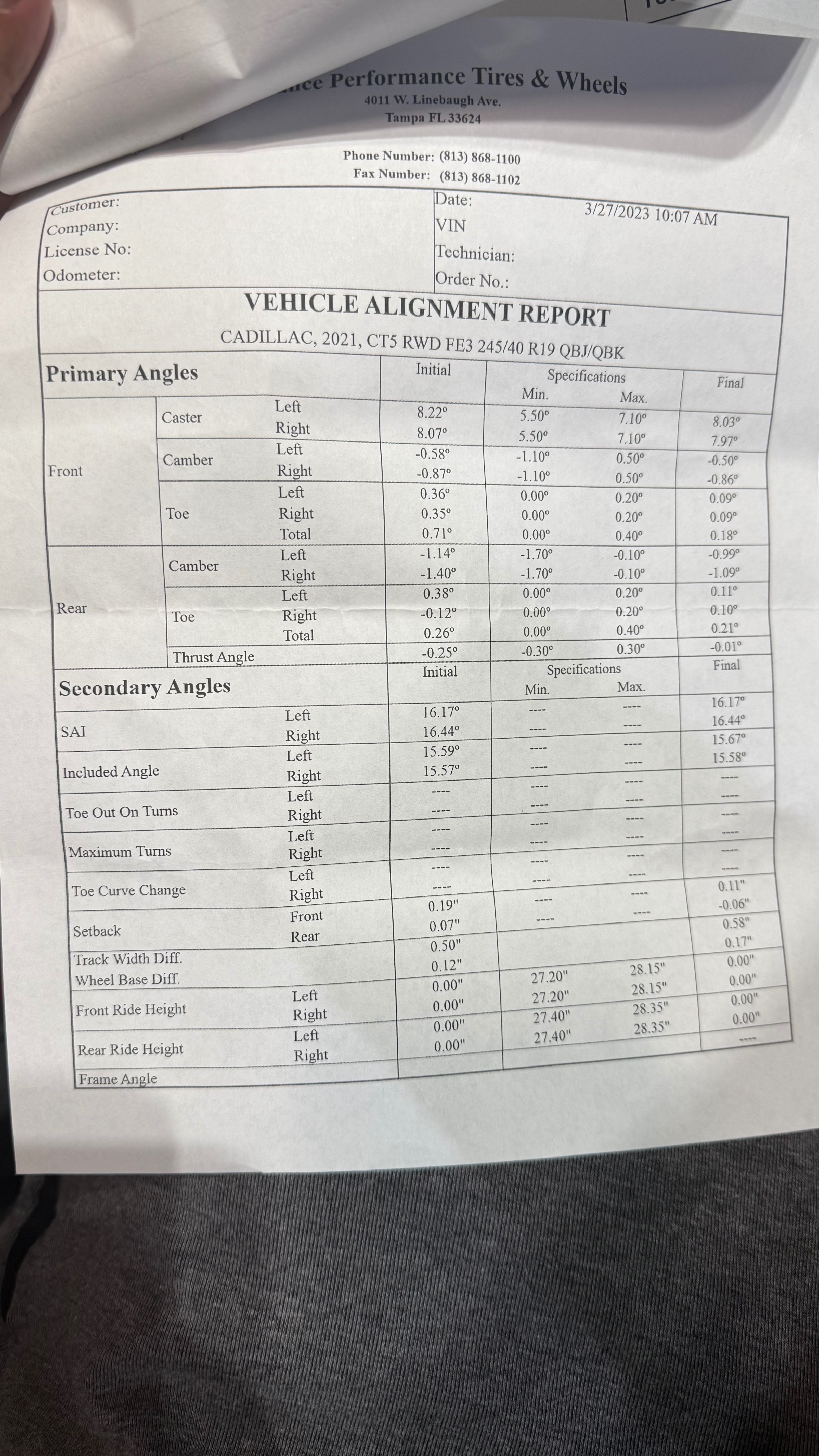

Also found my old alignment specs. Definitely have no camber up front. Probably should have adjusted it to -1 to -1.5. But again, pain in the ass to adjust since you’d have loosen the lower perch bolt, take the upper completely off since it’s knurled, shift, then put everything back together and recheck alignment. It’s basically a pain in the ass, I don’t believe there’s lower arm adjustment/eccentric bolts like in the older Vs.
