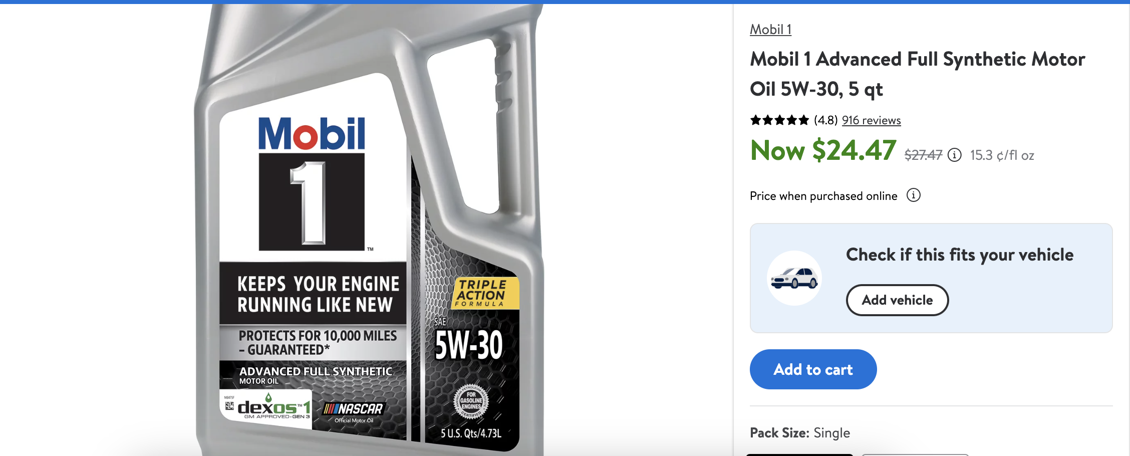

One of the benefits of the LF4 is we get to use the relatively inexpensive Dexos 1 5w30. I buy it at Walmart. :)

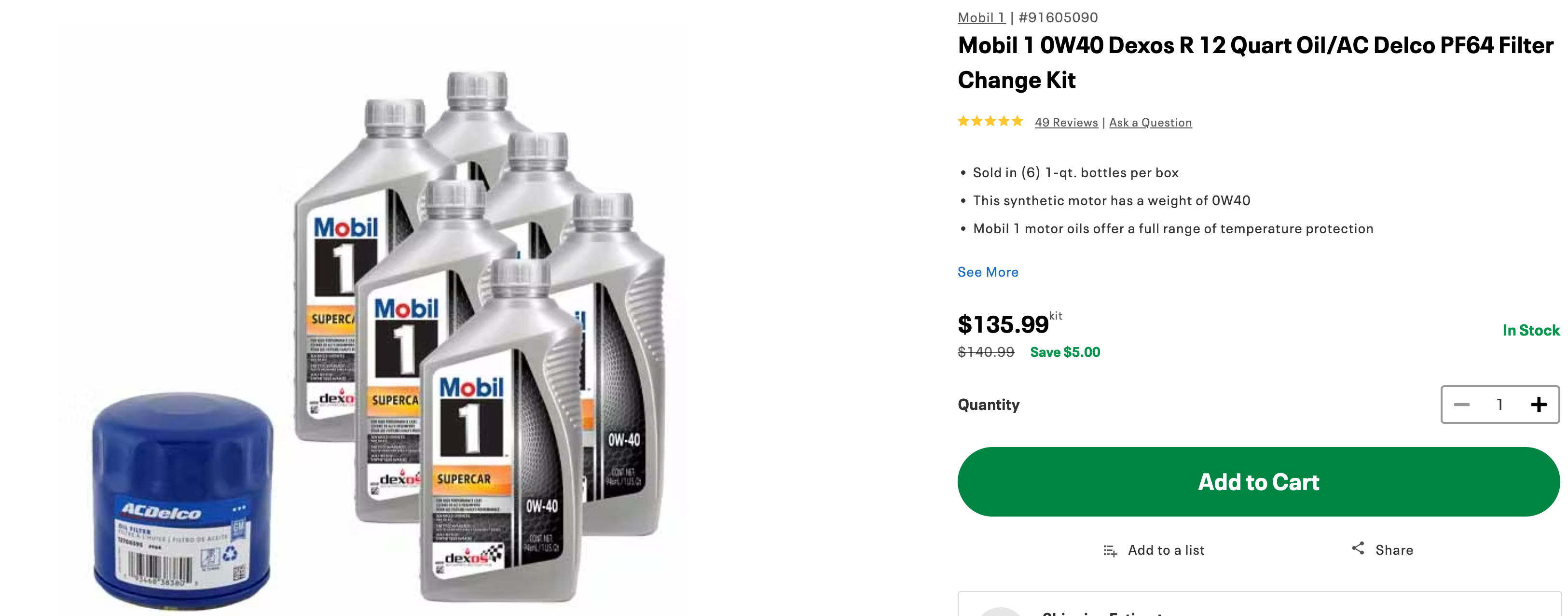

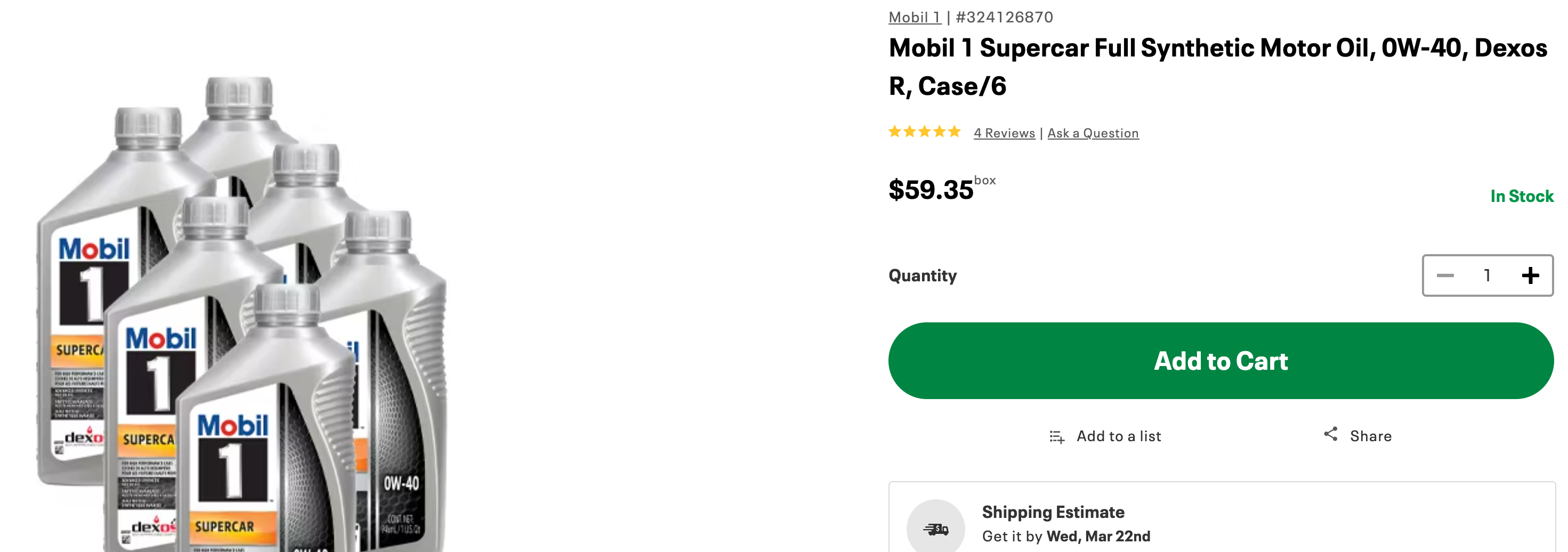

Speedwaymotors was my go to when I had my ZL1. They have kits as well (2) Cases, (12) qts plus a PF64 filter for $136. You keep the extra 2 qts and on your 3rd oil change you only need to buy 1 case. :)
How many quarts does the 4 take? My 5 takes 9, mobil cases come in 6 packs, so I have 3 extras for next change. I'm just about 3k miles did my own at 1500 and will monitor oil life for dealer freebie.
