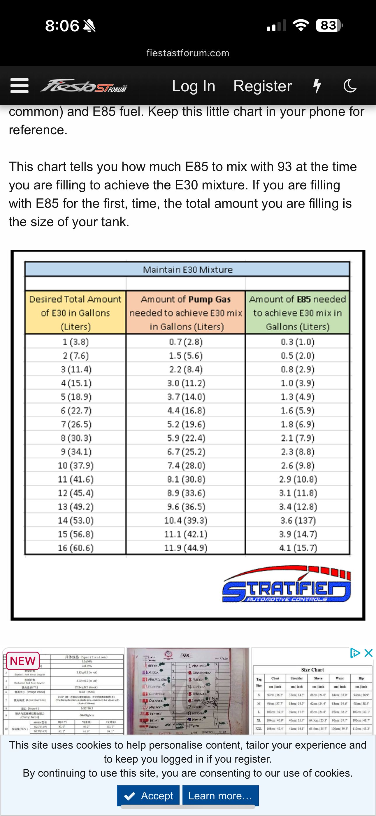

That might be why you didn’t see an improvement. Try a e30 mix again on map 3 and turn the fuel bias up to 40%. I got this direction from Terry and saw an improvement from map 2 to map 3.
I’ve heard anecdotally that it’s a 30-40hp difference.
Anyone use Map3 ethanol blend? If so how much E to 93 did you use? I know tapout never validated map3 and I’m a little hesitant to try it myself.
