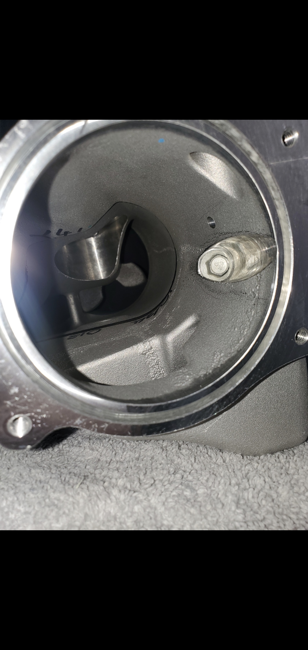

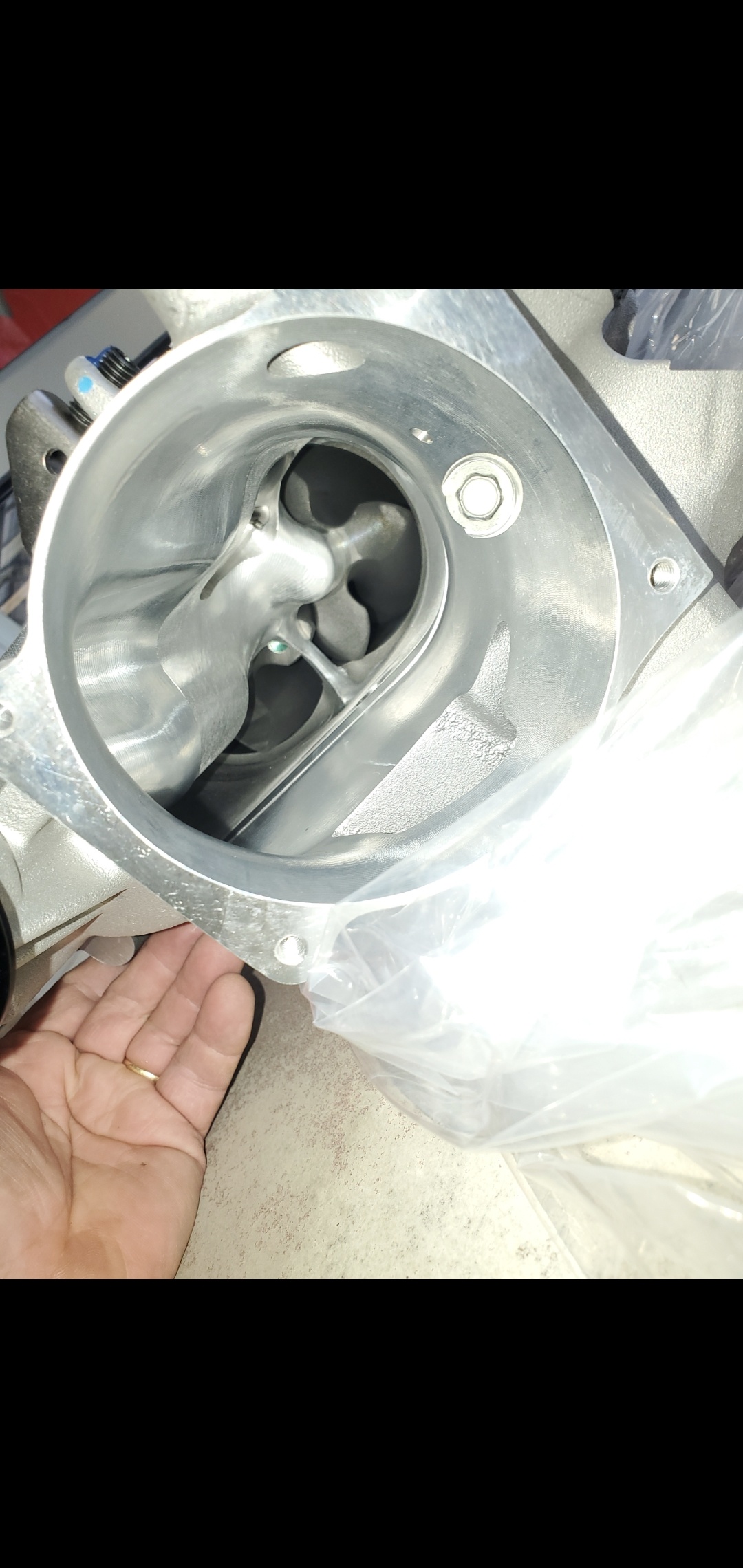

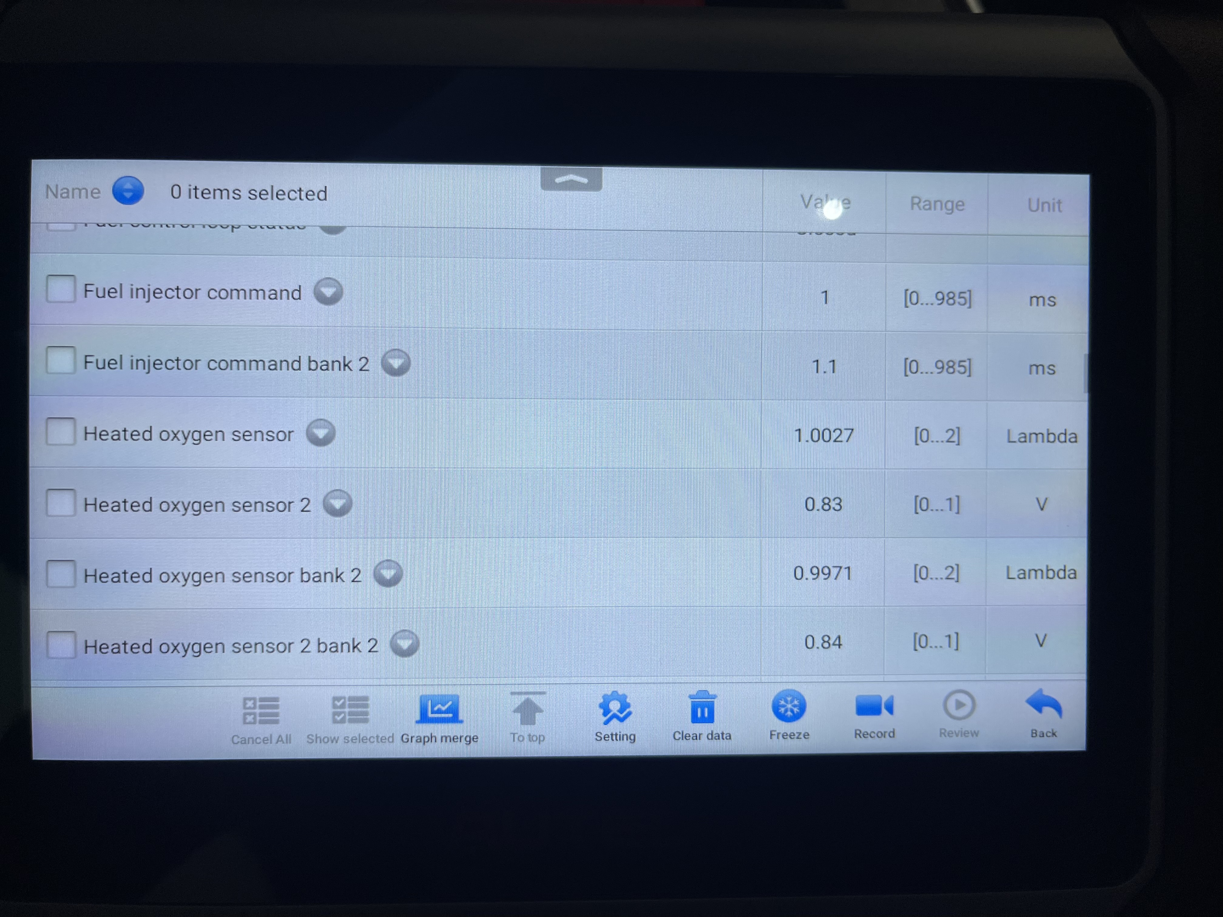

Still no CEL light? Sorry if I missed it if this was posted elsewhere.
Did you go with the 2 inch headers ? or the 1 7/8? Just curious I just ordered some last week from Scott. (2in)
The Kong X ported blower is a work of art...
