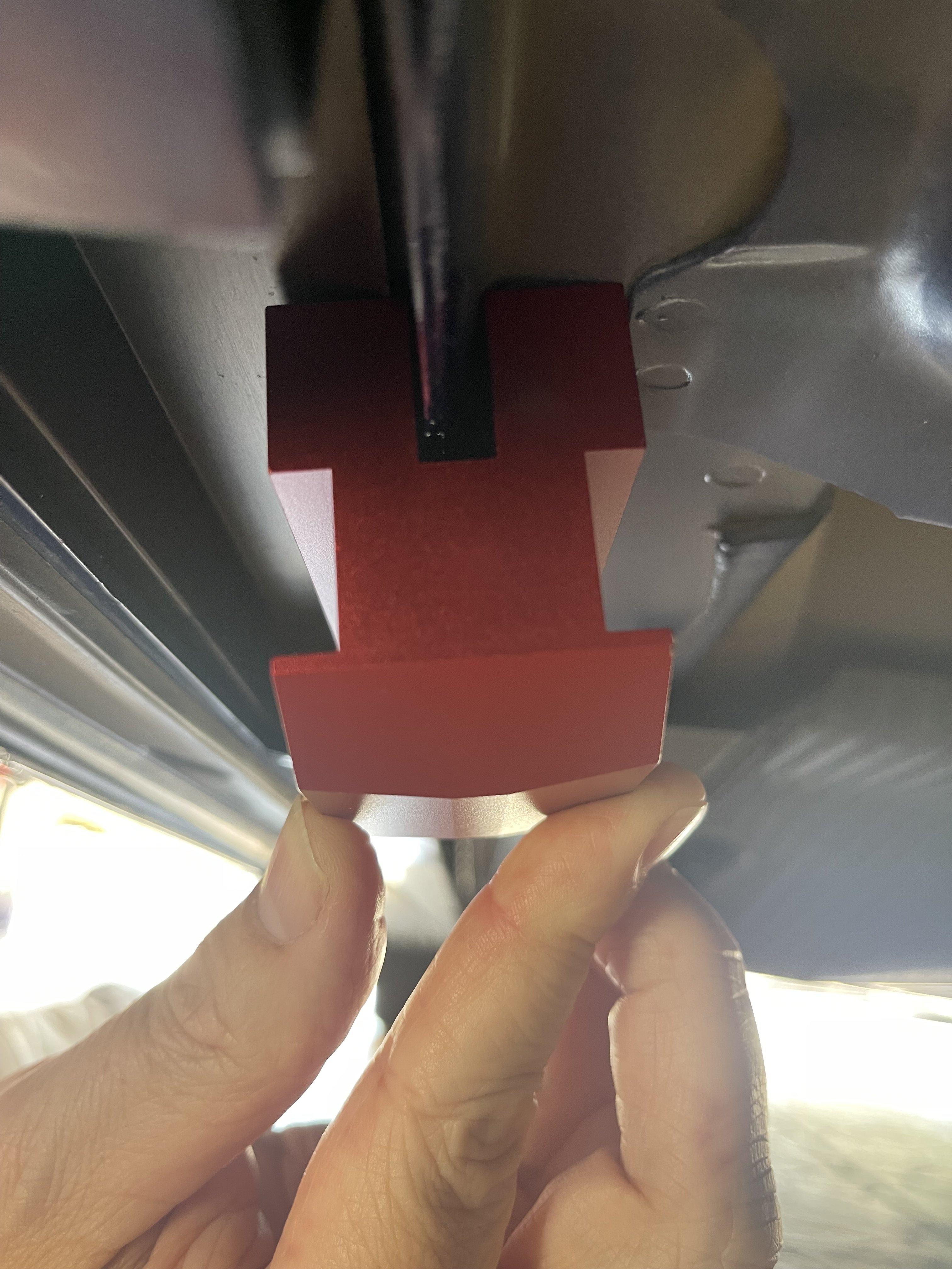

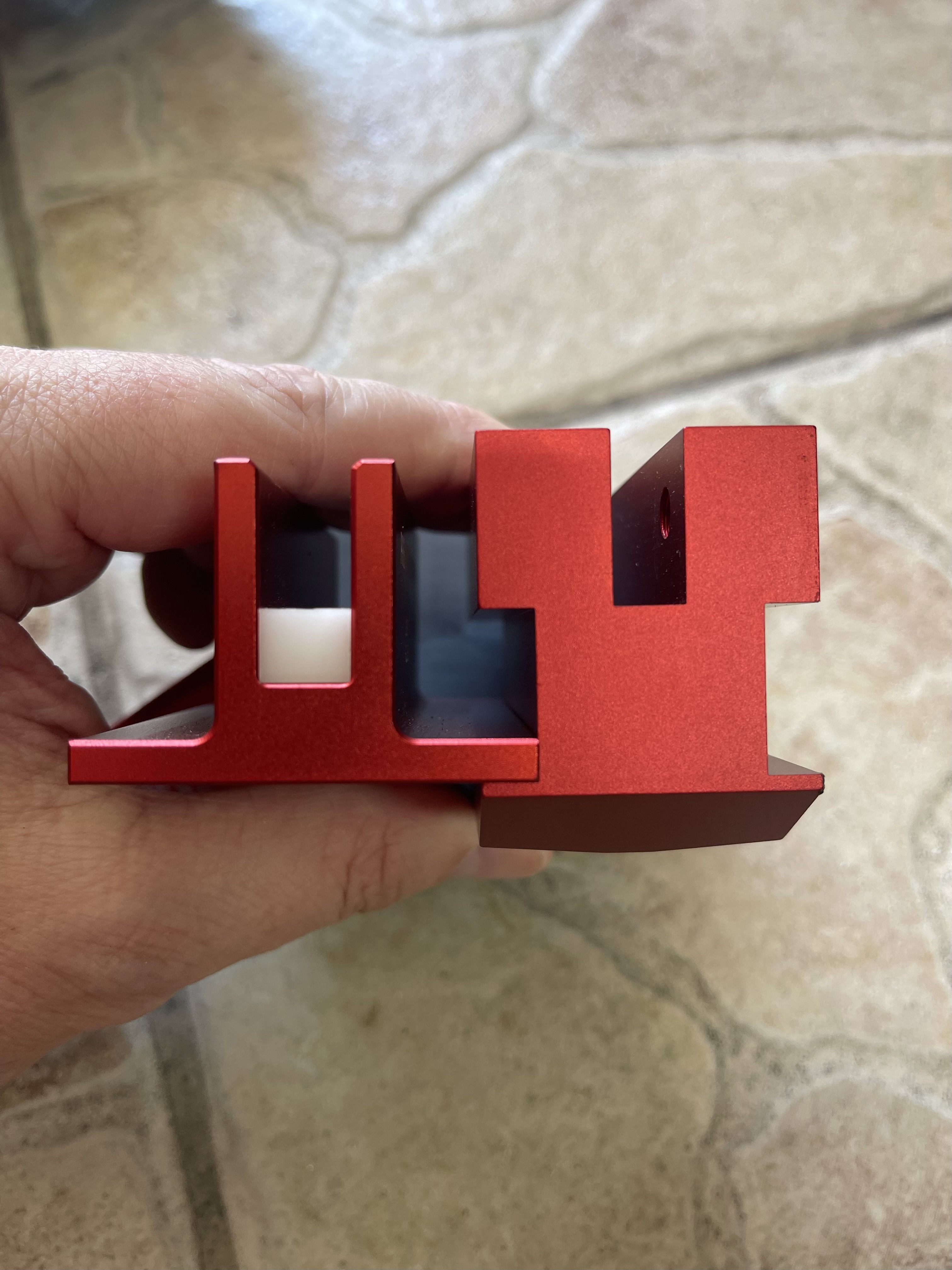

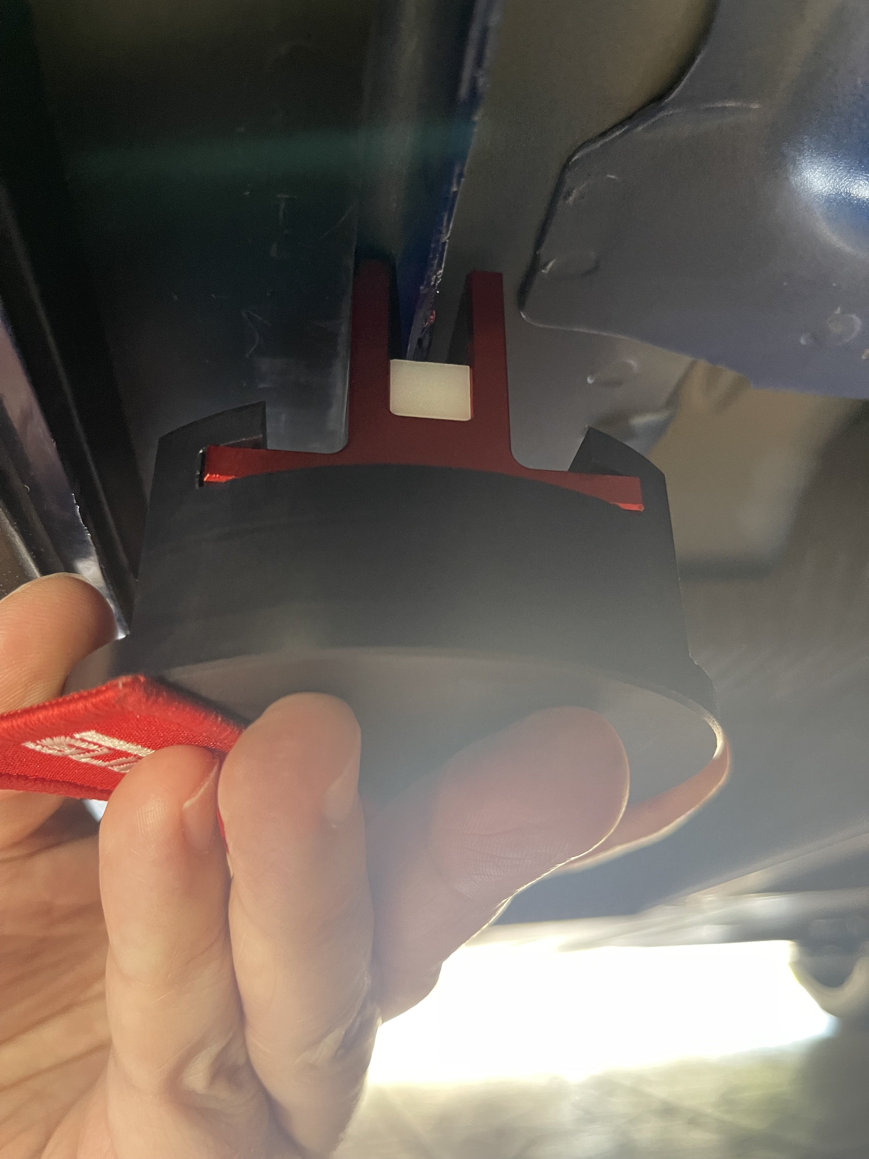

I am a OG user of the ZL1addons gear. Had them on multiple past vehicles.
Was excited to get the CT5 version of their lift points ordered and installed. They were an essential part of my Camaro toolkit.
I was shockingly disappointed to discover they don't fit.
I do not have CF2.
The inner and outer edges of the pinch weld are slightly different depths (inner edge is the shallower one). The adapter won't sit flush on the weld. It cants to the inside of the car. 100% it will bend the weld when you attempt to lift with it.
The ZL1 pucks are great and fit perfectly. If they would match the adapter with the dimensions of the puck, all would be well.
I have been in touch with them and await their response.
The other hassle (for me) is the distance between the lift points on the BW5 is huge.
I have a QuickJack 5000TLX and it won't reach. The front/rear spread is appox 70". You need the 6000ELX.

View attachment 17031View attachment 17032View attachment 17033
