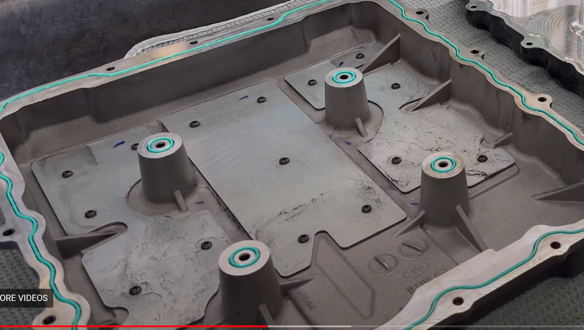

has more people removed the 3 plates under the lid?
Absolutely, Camaro and Corvette only use one but it seems that those covers are not as tall as Cadillac cover. Probably why seeing minimal HP gains over OEM lid. Mine are bagged and tagged. Did Kong X-port, 103 TB and catch can. Definitely hear a bit more whine but I left the insulation block behind SC.
