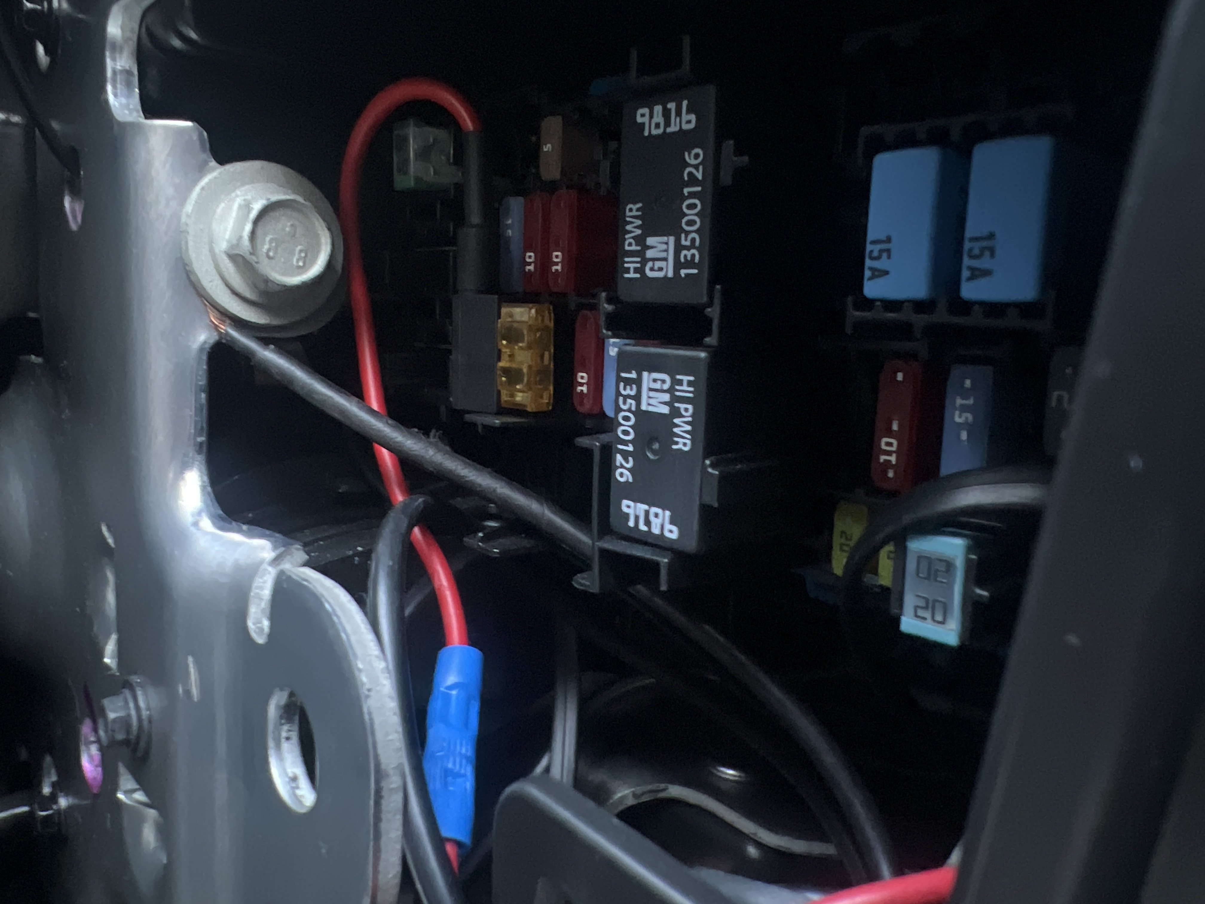

i went ahead and checked. I tapped into F30 which will power on with ACC

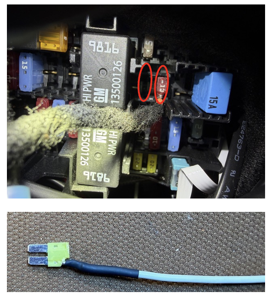

These two empty positions can be use for ACC. I use one for my radar detector and laser jammer and the other for the dashcam system I installed on Saturday. Made my own fuse tap. There is normally a second blue fuse to the right of the red circles but it is removed for this photo.

How did you create the fuse tap? How do you know it works?
I just used an X-Acto type knife to cut the plastic off the end and solder on a lead. I know it works in the same way I know a lamp works in my house, because all my electronics power on expected.
