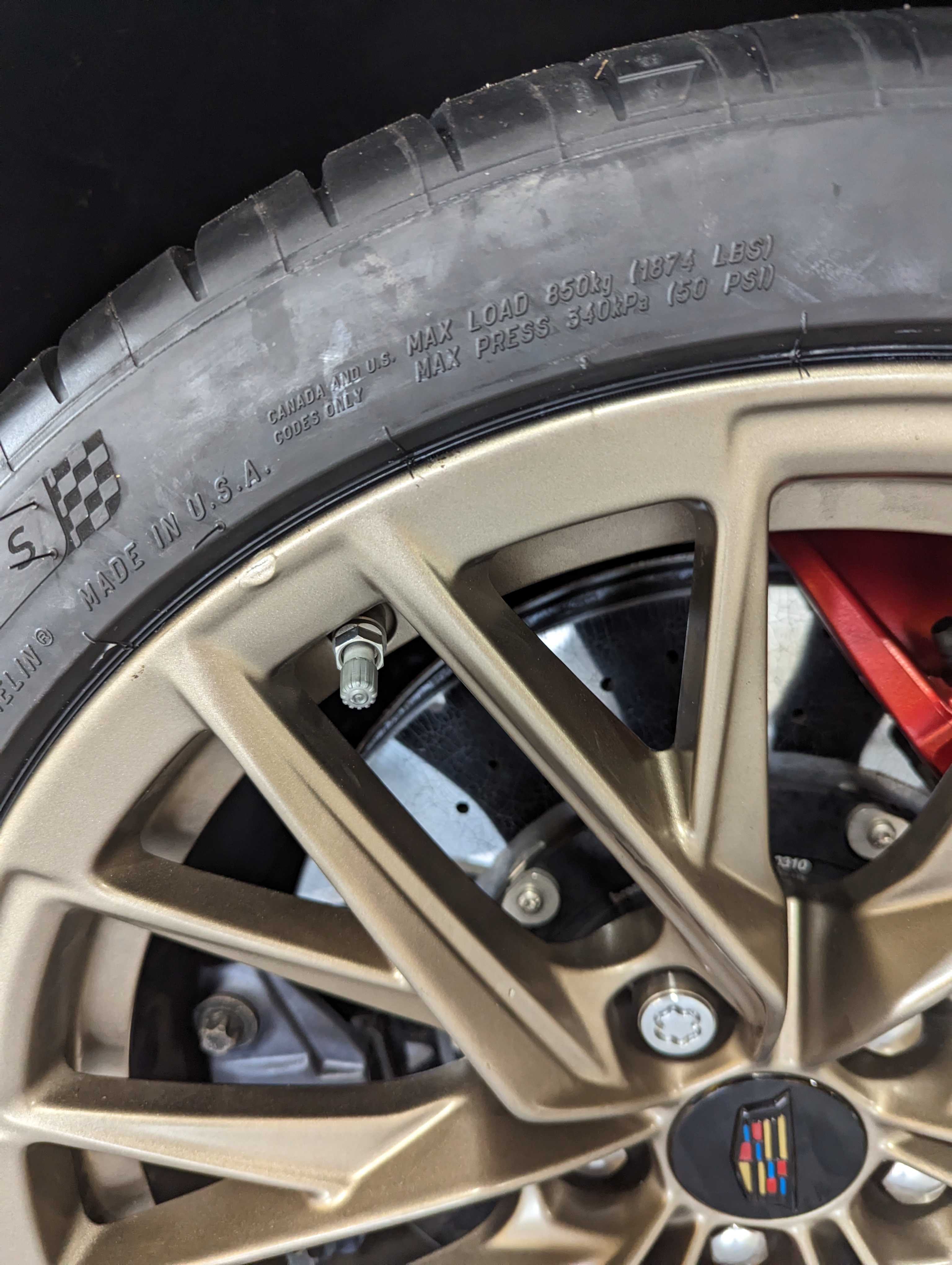

Took my car to the dealer to get a tire replaced under wheel and tire warranty and they ended up damaging the wheel. Is this fixable especially when matching the tech bronze finish? They said they will get their wheel repair place to fix it
Well that sucks and sorry you have to deal with it! I have seen some really good wheel guys do magic and you couldn’t even tell the difference on all kinds of finishes, so possible to fix.
Suggestion- Tell them you will let them fix it and if it doesn’t come out correctly, they need to replace the wheel. They need to make it right, period. Best of luck!

Thanks! Yeah that's the plan of action right now...but I am kind of anal and my eye catches stuff....so what is an acceptable job for them won't be acceptable for me....I know I am one of those customers 😄

It’s fixable. Getting the paint code right might be tricky though. I’m guessing that there might be some undercoat primer under the top gold paint. Gold paint can be hard to match. Can you even buy that wheel paint in a touch up application? I know for the 350s you could not buy the wheel paint at all.
Going to see about paint code but even two tech bronze wheels on the same car don't match

In my case they are going to give the wheel finishing a shot and if that doesn't come out right they will get me a new wheel. Only issue is there will be number of people touching the wheel again a few times leading to more things screwing up potentially

A common problem, even with the touchless machines, is that folks don't hold the tire down into the drop center as it's fed around. In that case, the tire can actually pull the mounting arm down to the wheel or can rip the bead - I've done both mounting stock tires for the C7. Based on your picture it looks like that's what happened. The arm that feeds the tire down over the lip also has a replaceable plastic piece that will wear and crack off, so if that's missing you're going to get metal to rim contact which will actually gouge the metal.
I have to make sure this doesn't happen again ...the less number of people that touch it the better.
