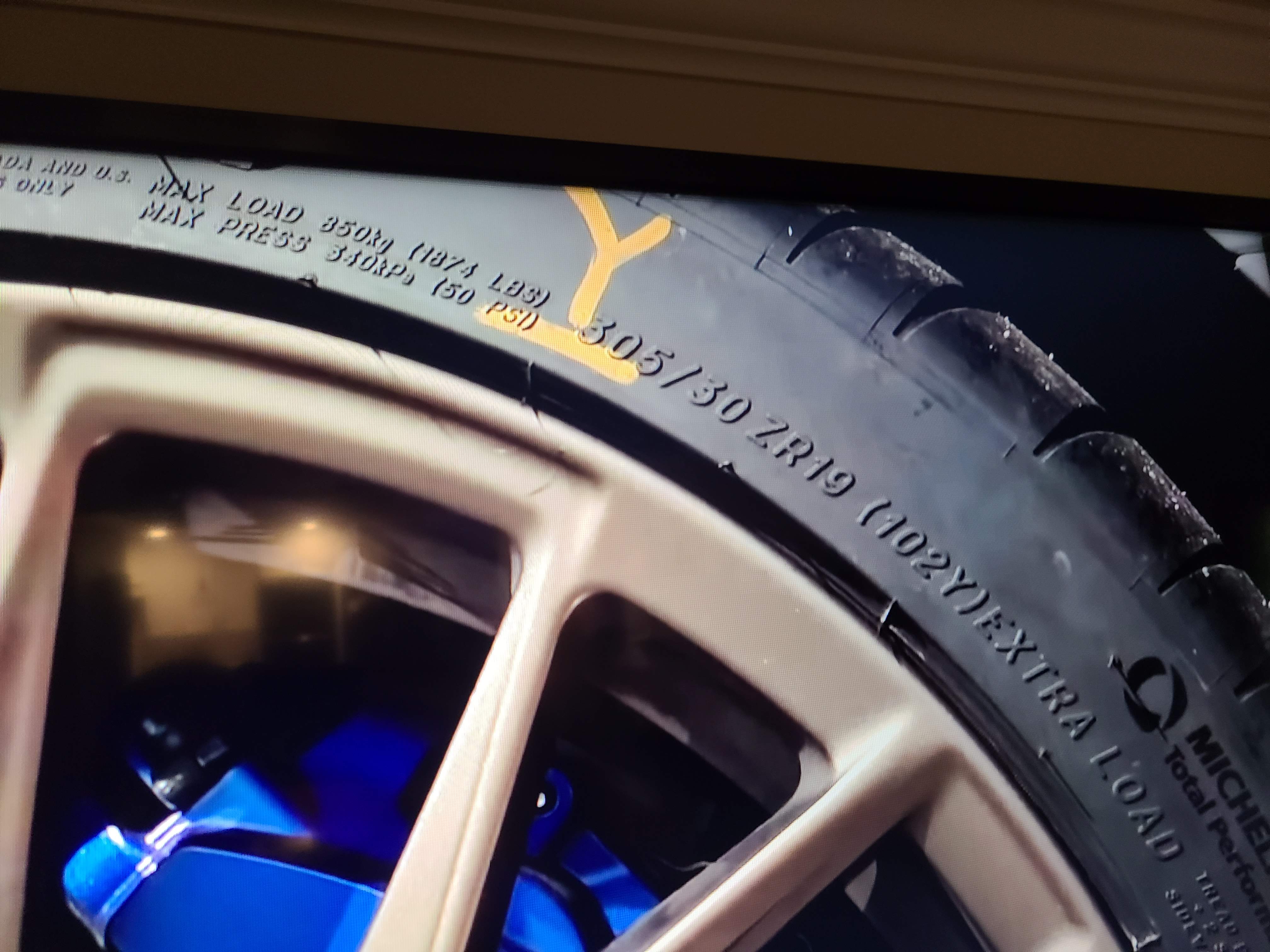

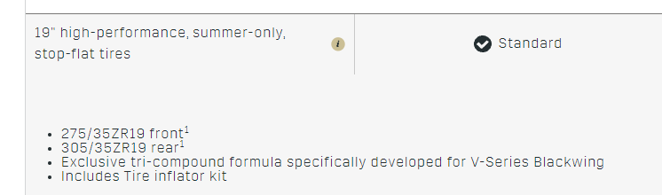

Question about TIRES. Specifically the rear tires. I'm seeing conflicting information.
Does the 5BW use 305/30-19 or 305/35-19 tires?
From the website:
And as seen in a YouTube review:
The 4's are both 35s.
