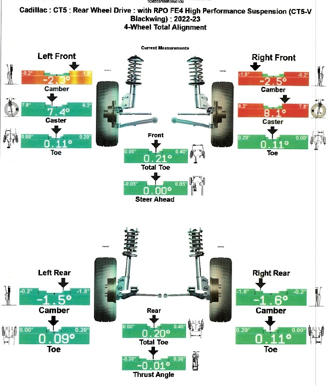

You measure the toe links when you install them to basically mirror the measurements of the old ones. Following, you should really do a 4-wheel alignment. They didn't show me the before/after alignment results like some of the specialty alignment shops do...Alignment wasn't checked prior to installation of toe links just after?
What the ZL1 people and some CT5V people were saying is that the original toe links were stamped steel pieces of crap with rubber bushings (which they are) and they tended to flex under acceleration.The reason i asked about alignment before was my ZL1 6th gen also had the extreme wiggle issue under hard acceleration, alignment alone fixed 98% of that, i do not remember the numbers but my guy just about maxed out the adjustment to get it center of green on the screen (Hunter) i was in bay watch/talking to him while he did, now its a pleasure to do hard pulls when traction allows.
V3s were notorious for it too. Somebody who made cradle lock out kits made a clip with a camera inside the wheel well that showed the deflection underload. You can see the arms bend and see the wheel shift to toe out. Thats what causes the rear end sway, even if alignment is good, its not accounting for that deflection when it loads.The reason i asked about alignment before was my ZL1 6th gen also had the extreme wiggle issue under hard acceleration, alignment alone fixed 98% of that, i do not remember the numbers but my guy just about maxed out the adjustment to get it center of green on the screen (Hunter) i was in bay watch/talking to him while he did, now its a pleasure to do hard pulls when traction allows.
Kevin, I did get the AFTER alignment specs from the dealer.Alignment wasn't checked prior to installation of toe links just after?
Red means out of stock spec.Kevin, I did get the AFTER alignment specs from the dealer.
I'm not sure why some of them are in red....
I figured that. Negative 2.5 degrees camber is what is recommended for 'track use'. I'm not sure why they used that spec.Red means out of stock spec.
