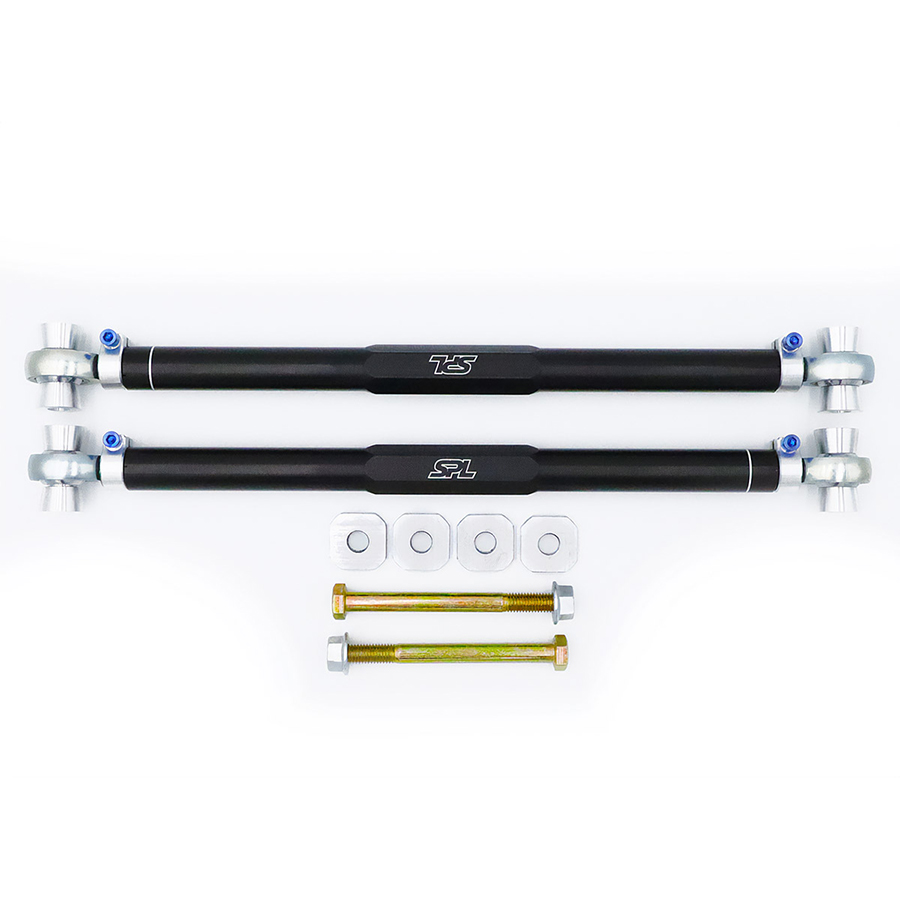

After 10,000 miles, my CT5V is experiencing severe rear end wiggle when you jump on the throttle at higher speeds in 3rd and 4th gear.
There have been pretty significant discussions on this issue on the Blackwing Facebook Group and people have tracked it down to a couple of issues:
- Wheel alignment: Evidently the rear wheel alignment can fall out of spec and cause this issue
- Rear Toe Links: The reason the wheel alignment gets out of spec is due to the stock toe links not being strong enough.
In cross-discussions with the ZL1 Camaro guys, the Facebook posters found they were having identical issues with rear-end squirrelyness, and they had replaces their toe links with the SPL versions and it corrected the issue. One of the CT5V guys replaced his toe links and reported the car is much more solid now and the rear end doesn't kick to the side when he goes WOT at speed.
I attached a screenshot of his post which shows the stock toe arms and the SPL toe arm links side-by side.
The part they are recommending is: SPL Parts Toe Arms with Eccentric Lockout (Rear) - Chevrolet Camaro 2016+ / Cadillac CT5 Blackwing 2022+
Part Number: SPL-RTAEL-CAM6
link to the part is below:
Here's what it says about those toe arms: "The stock eccentric bolts that allow for small toe adjustments tend to slip under high cornering loads, causing changes to the rear alignment. SPL Parts Eccentric Lockout (EL) kit eliminate the stock eccentric bolts to keep your rear alignment where you set it. SPL lockout plates are CNC machined from 6061-T6 Billet Aluminum and supplied with Zinc plated grade 10.9 hardware for absolutely zero-slip."
Please let me know your thoughts.

This is great information. I have posted elsewhere about noticing this phenomenon in 3rd and 4th and it definitely can be disconcerting. I may start with the SPL arms and see if I need to go any further.
@WONT TAP - any thoughts on this issue or these arms?
Maybe i am over simplifying-hard to “feel” a feeling through words, but what youre describing sounds to me like n LSD hunting for grip in a high tq/hp car…. Which is even a bit more stnthetic feeling since its an ELSD.
While i would totally buy rear control arm bushing wear as making this feeling worse-not on a car this new. Regarding alignment-maybe. When the car squats under load it drives a bit more toe-out dynamically. But thats easy enough to check-go get an alignment and dial in some negative camber while you're there.

Seems like a simple/inexpensive mod that is worthwhile 🤷🏻

Thanks for sharing this. I just came across this thread after googling squirrely black wing rear end. I’m right at 5K miles and my car does this bad. On an empty highway I’ve ended up a lane over because of it. I noticed that the car I drove at Spring Mountain did none of this too, so I thought maybe it was alignment. Think I’ll try a proper alignment from a performance shop and if that doesn’t work, I’ll come back to this link and buy those.
I just received the SPL toe arms.
Going to have them installed next week and get an alignment as well. I'll report back.
This will be interesting to hear about results… A crappy toe link will usually lead to dynamic toe in under load whereas the behavior of the vehicle sounds more like rear toe out. It will be interesting to see what alignment settings look like before any changes, however, the fact that is 600 hp plus Rwd car wants to trade ends under heavy power also sounds fairly normal

I did get my new SPL Toe Links installed and an alignment done. That's good news!
