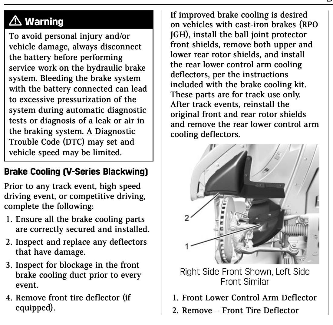

According the the manual, the front tire deflectors are supposed to be installed for street use and taken off for track. Those are the only parts I believe I need to install for street (CCB car).

For a CCB car, the front tire deflector does seem to be the only part that needs removed. Everything else follow the wording of "with cast-iron brakes RPO JGH." Even though JGH is not the brakes RPO, it's J6H.

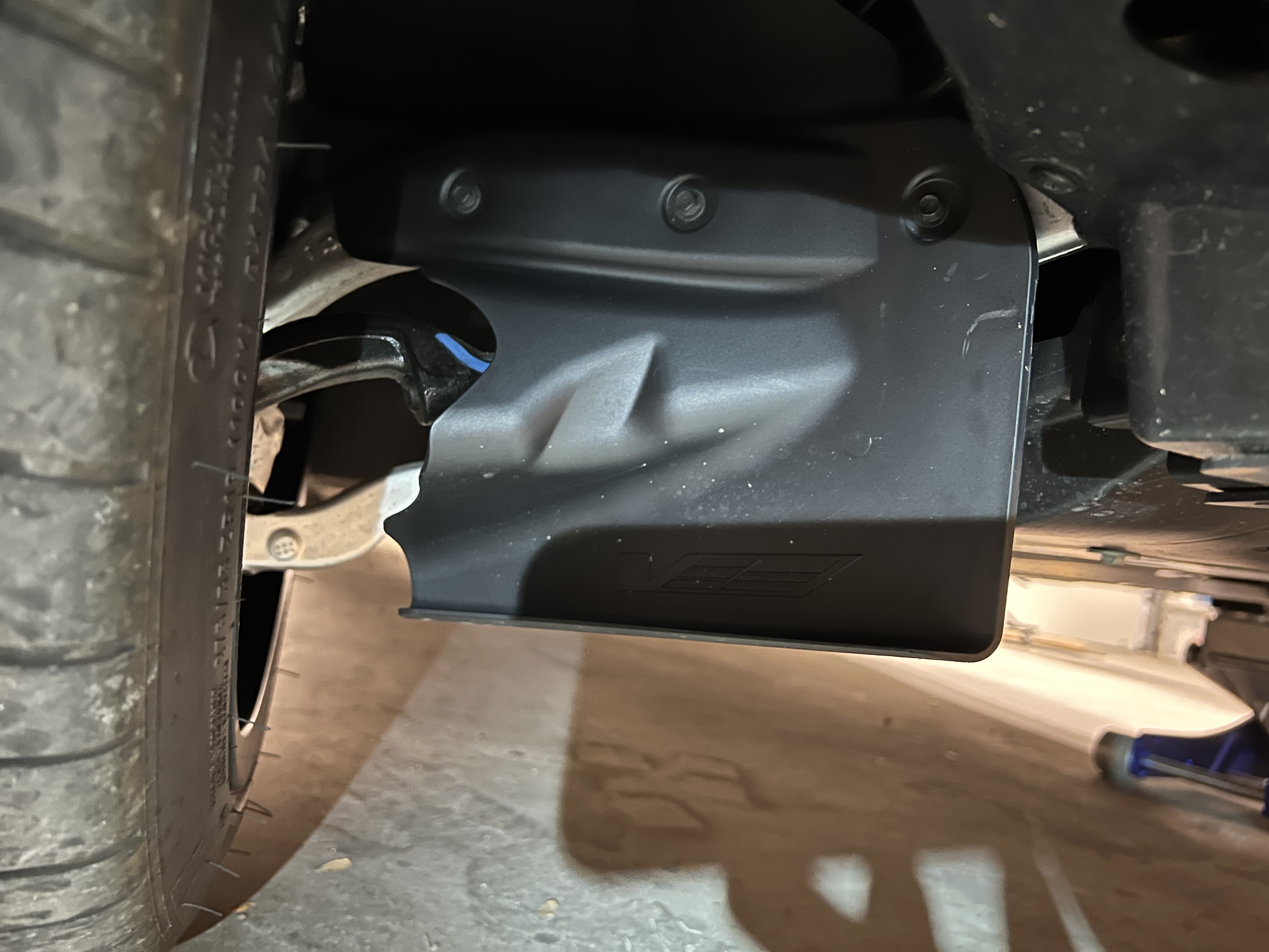

Got under the 5BW today and found there are the regular front rotor shields (no tomahawks) and the ball joint protectors (aka Front Lower Control Arm Deflector) were installed. Removed those (pictured) and installed the Front Tire Deflectors. This is for street with CCBs.

The tomahawks ARE the "front ball joint protector shields." They replace the standard dust shield. The big air deflector pictured is the the lower control arm deflector. It stays on all the time, track or street. The "front tire deflector" comes only on non CF1 cars and is removed for track use. Removing the lower control arm deflector is fine if you don't track the car.

My car didn’t come with the tomahawks and I don’t know for sure if I was supposed to get them with CCBs. Looking at the Lower Control Arm Deflectors installed they look well designed to funnel road debris (and air) to the rotors. I think it be a lot safer for the CCBs on the street with them off.

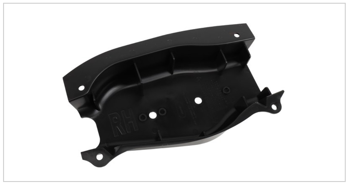

Here are the parts in question, 22823592 and 22823593. I know where they go, but what are they for? They came in the trunk.
