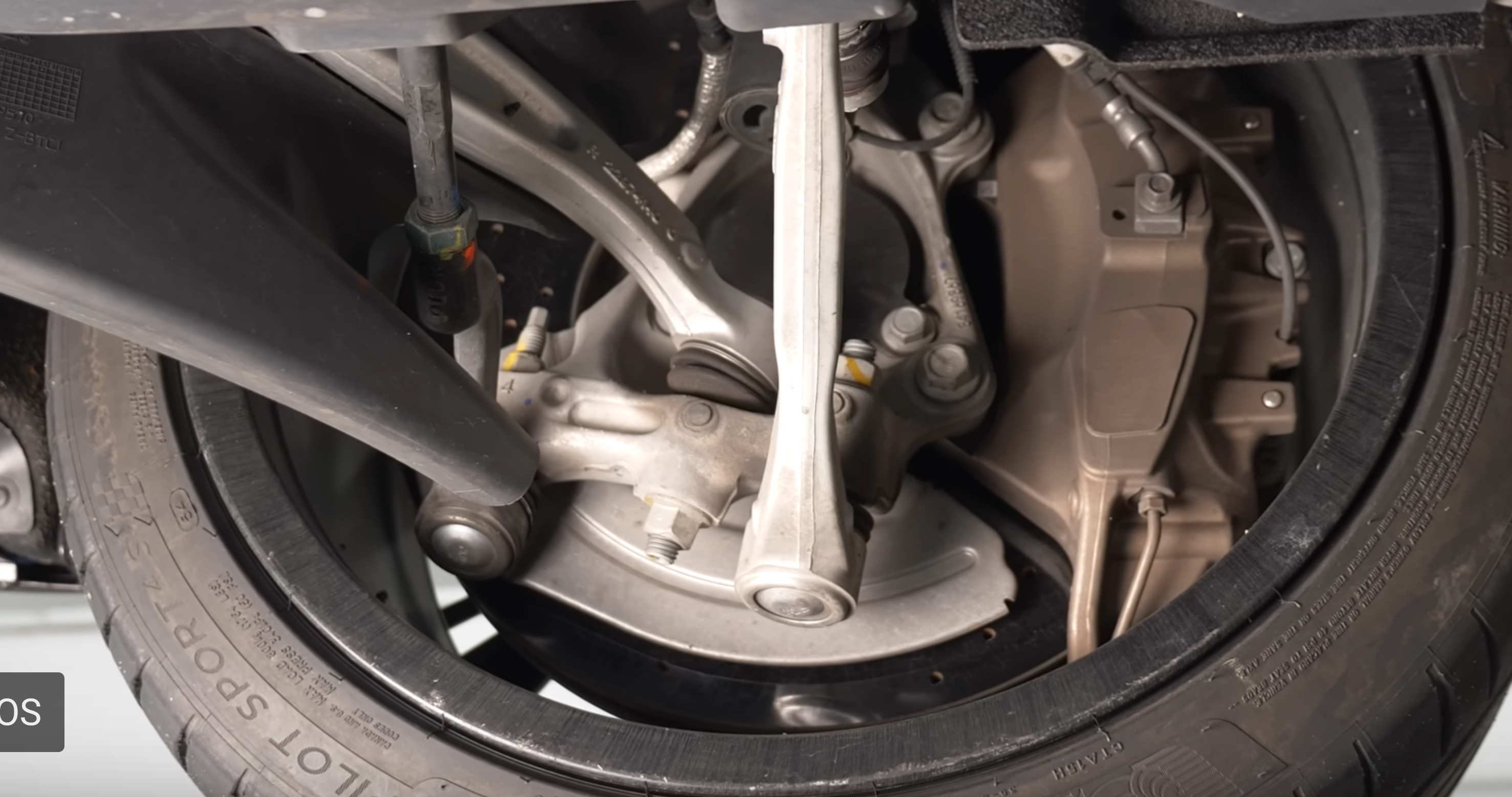

the steels come with smaller shields that protect the balljoints from heat. per what you quoted from me and per what came in my trunk and is on my car now (and has been gone over several times in this forum). if you removed the shields from the CCB you'd then subject the balljoint to the heat the engineers are trying to prevent by providing the smaller tomahawk looking shields. the CCB lower shields don't protect the edges of the rotors either. must be a reason for all of this. maybe you should ask one of your GM buddies?

FWIW the steel brakes also come with a lot more cooling capabilities vs the CCB as the rotor shields can be removed and swapped with ones that only cover the balljoints to protect them from heat. CCB must keep the shields on restricting airflow so as not to risk damage.

You are really hung up on this. The Iron brake has more ducting/prep because it needs it. In the Track Prep guide, you are to remove the front shields for track use. Not leave them on. Where in the world did you get that idea? I leave mine on for daily and even AutoX, but they come off for track.
There is no track prep guide like other GM cars. Just a reference in owners manual. As I said before, you remove the regular shields & replace them with ones that protect the ball joint from heat. You do NOT remove the shields from the CCB per this guy you may have heard of called Mirza. Check the duct cooling thread.
