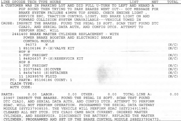

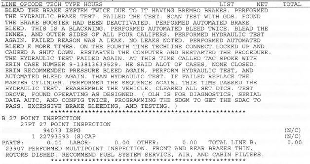

Took it in and after a bunch of bleeding and testing and stuff multiple times, they had to call GM TAC and ultimately replace master cylinder, brake boost, and ecm with programming, etc.

2.) The notes say that when they called TAC, the TAC guy said "a lot of cases, none closed". Ultimately recommended to replace master cylinder which obviously worked.

My understanding is when the BBW "fails" there is a physical plunger that offers brake operation. I think this is 100% BBW failure and it went to fail safe mode, like its supposed to. The OP will have to clarify, but sounds like he still had brake power so likely not a traditional hydraulic failure (line break, or similar).
hey all, some responses here. When I stopped (perfectly in the target spot BTW :_rock), the pedal felt like it went to the floor to me. I was with an Attorney (mental note: could be good or bad situation there) and she said "just restart the car and maybe that will fix it". Funny, because I run IT for our company so I said "This isn't a computer! but I will oblige since I'm impressed you have listened to our sage IT advice to fix your computer when you screw it up!" Before I restarted the car it said "brake system failure, max speed 62mph", when it came back on it said "brake system failure, max speed 43mph". So we both agreed it appeared to be a leak. We checked and no leak anywhere. After lunch, turned car back on and same message, still no leak. I didn't attempt to drive the car and had it towed to the dealer which is funny because my attorney pal said to just limp it in!
The dealership tech noted when he tested the car, the "pedal is soft". I have non-CCB brakes with a manual, no tracking of car, and don't really beat on the car (at least braking-wise). However, they noted my brakes are 3mm and "dished rotors". My favorite part of the whole documentation is the statement mid-paragraph, "THIS IS A BLACKWING". :cool!:
