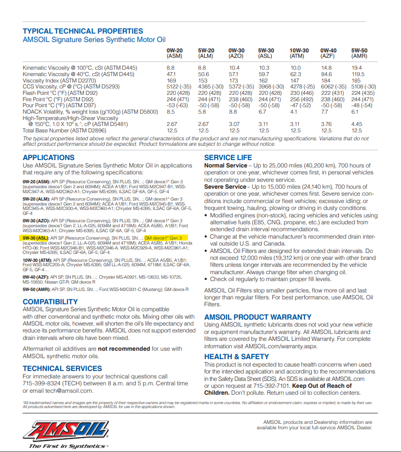

AMSOIL 5W-30 Signature Series oil has the Dexos Gen 3 approval.
