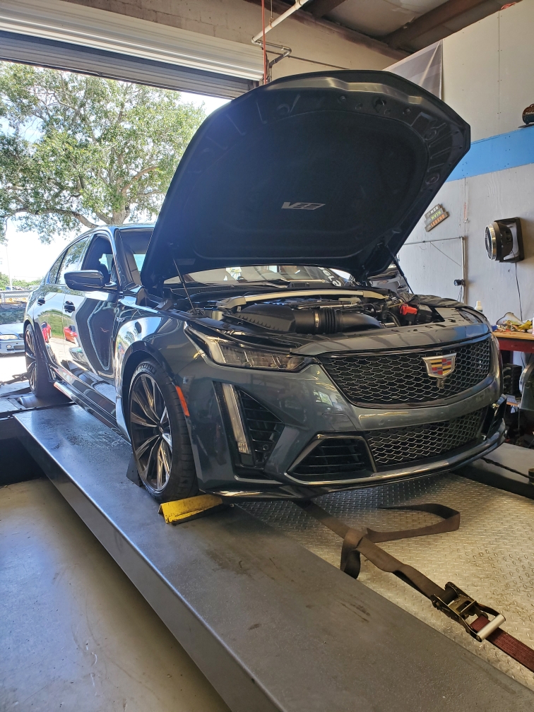

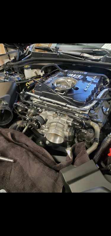

Well here we go, before and after pics...

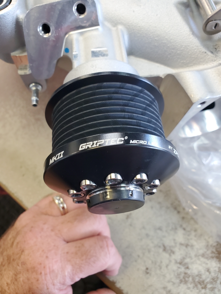

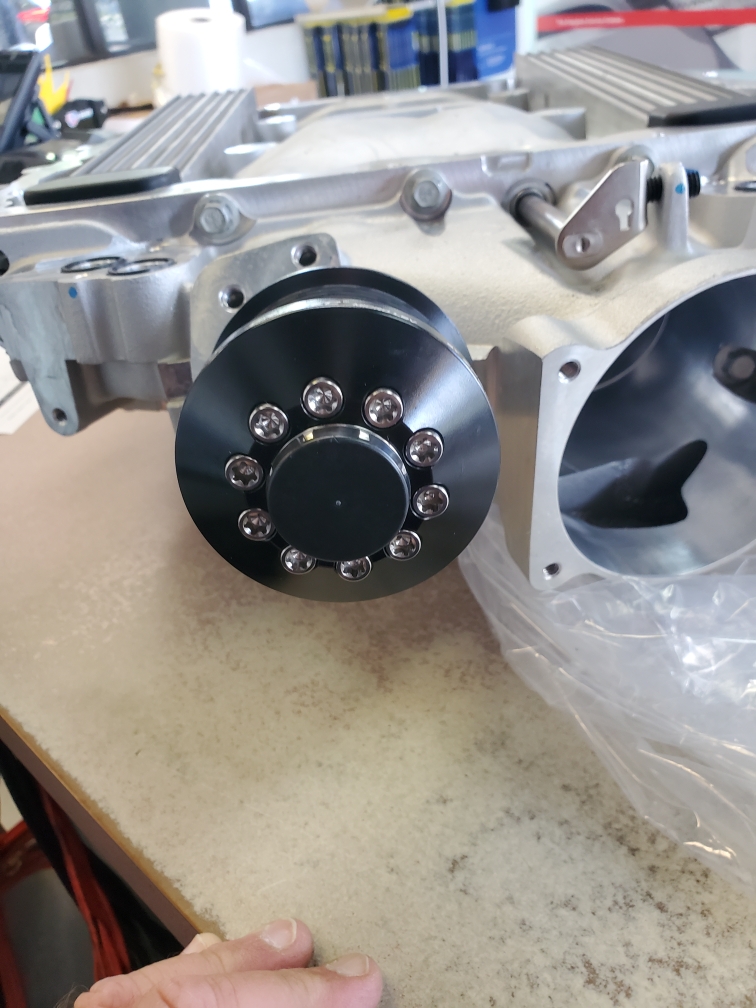

Specs on the pulley and any performance gains?
Haven't installed the blower yet, I kept the stock size (2.5) because I wanted to see the gain from ported blower only. Sometime in the future I will play with different pulley sizes...

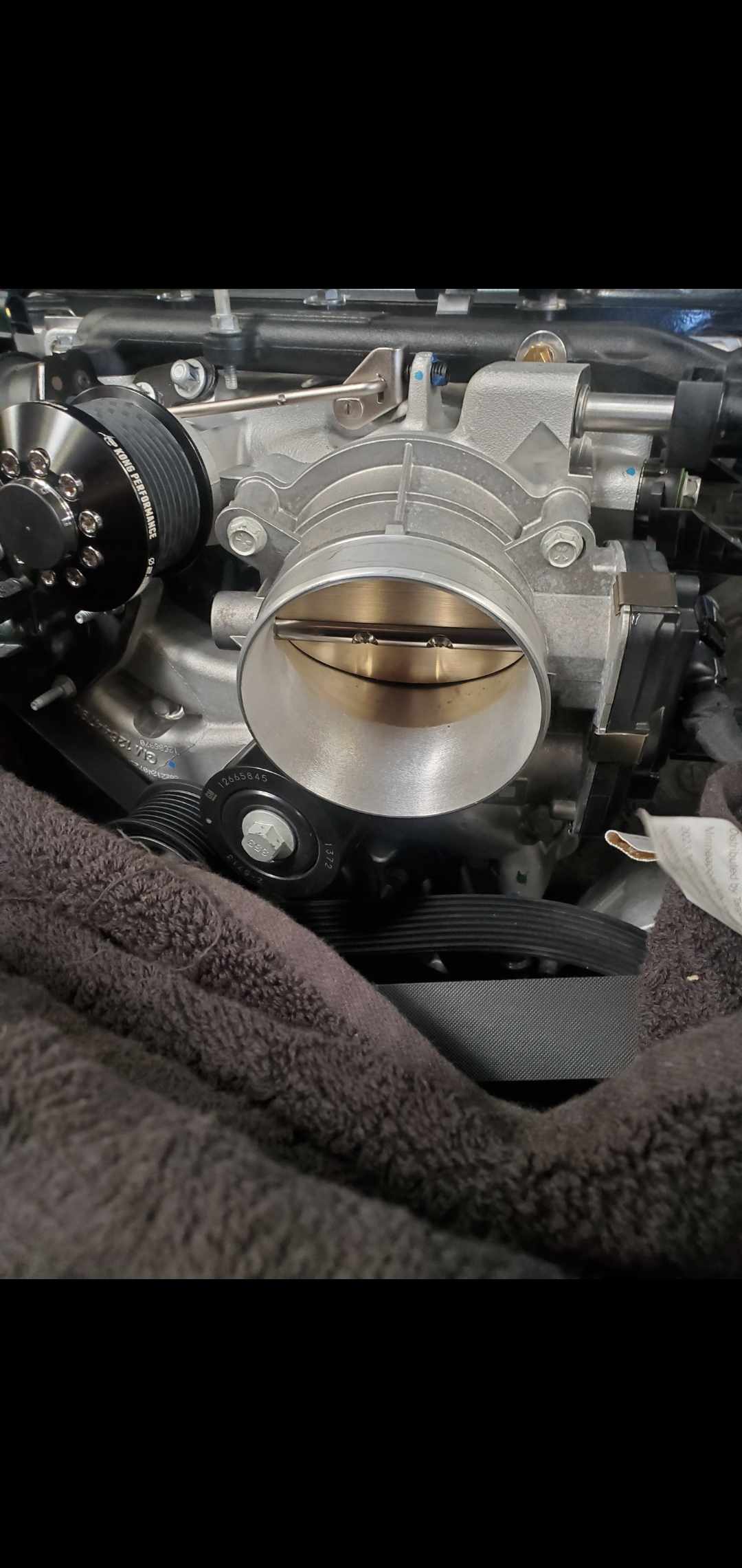

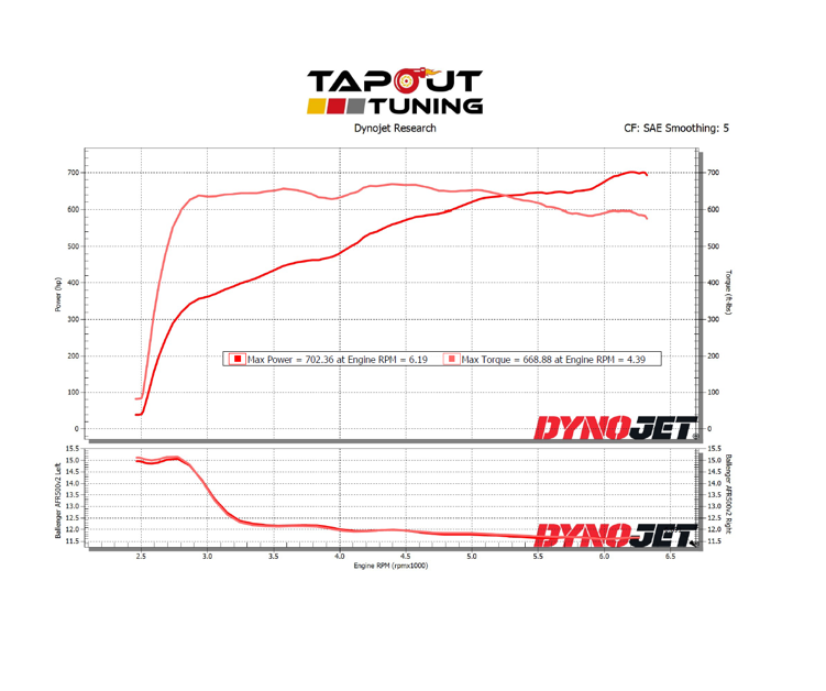

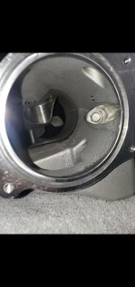

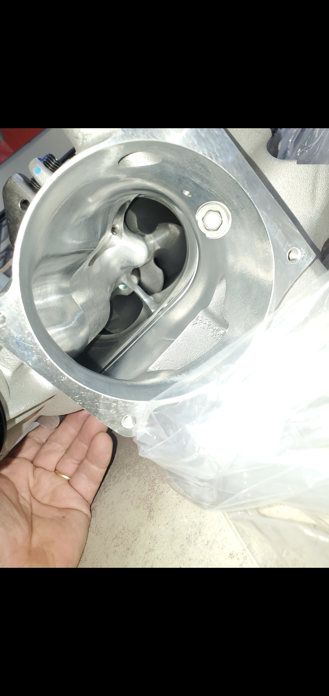

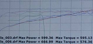

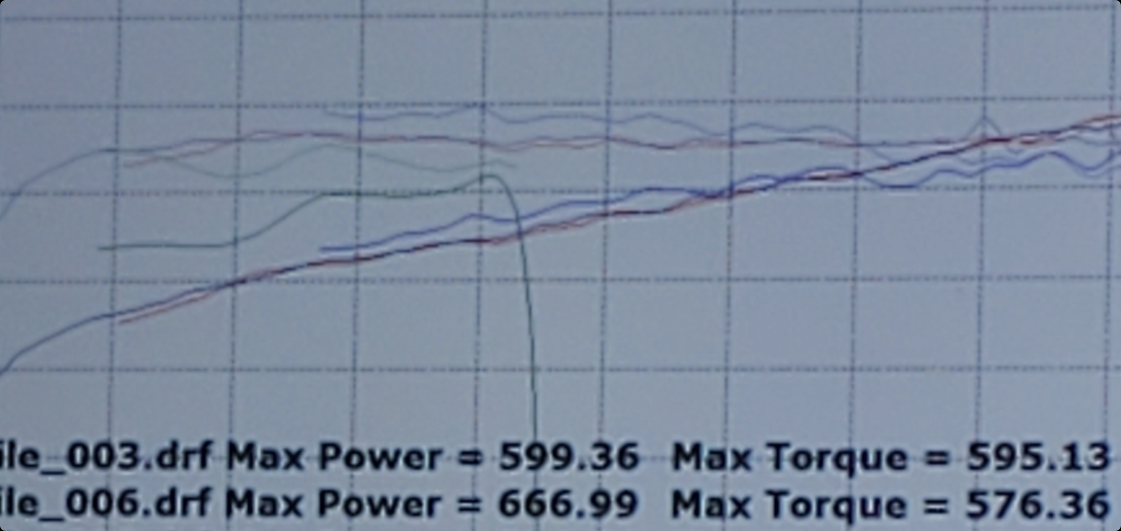

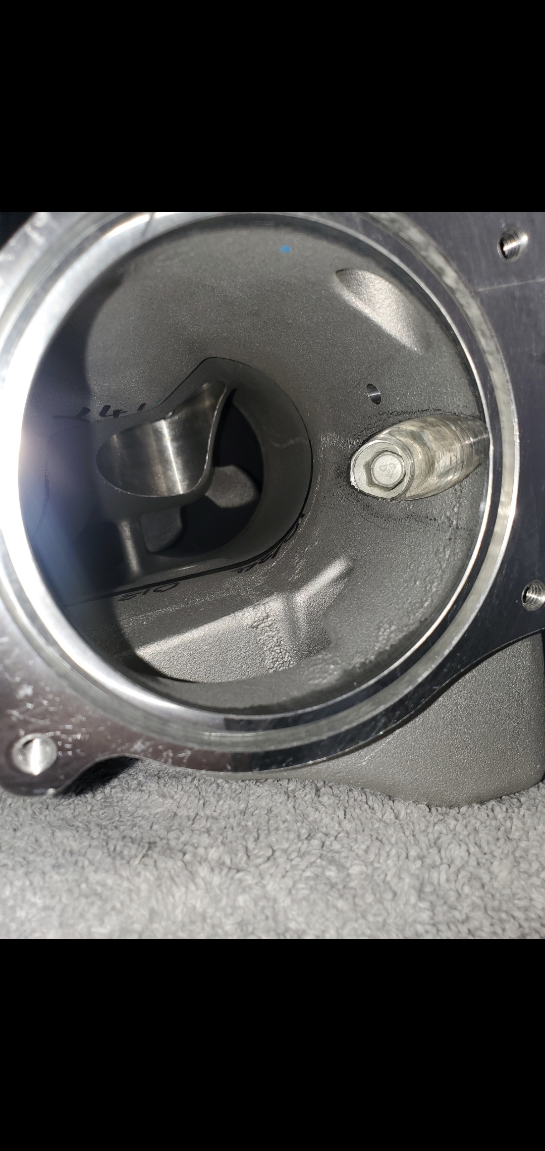

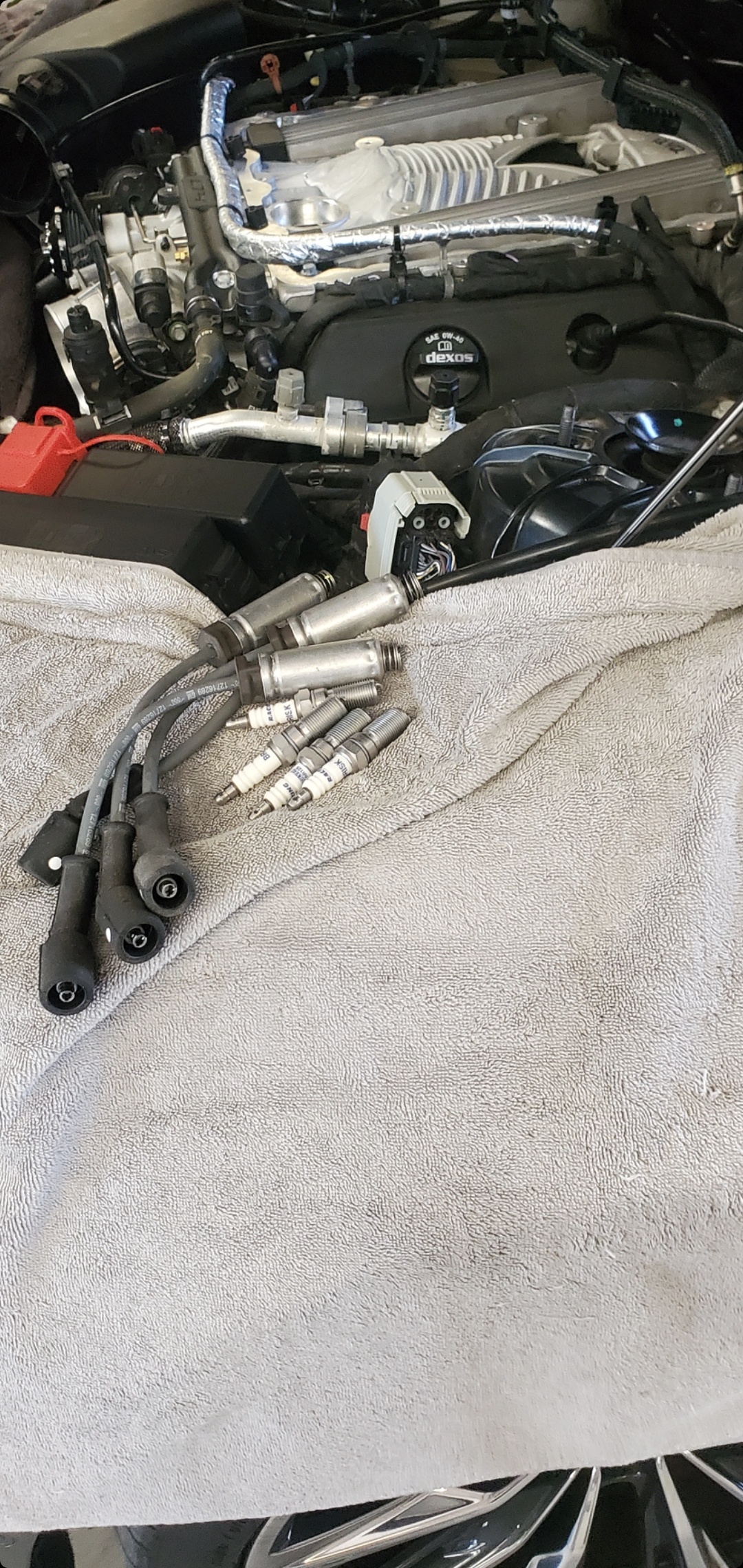

Installed the Kong X ported blower and the Tony Mamo ported 95mm ZR1 throttle body yesterday. Also swapped the spark plugs to Brisk and removed the sound plates from the lid. Best base line was 599 - 595, third pull after the swap was 669 - 576 so lost about 19 on the torque side but gained 70 on the hp side. The car is definitely more responsive & quicker around town even with the 19 lb torque loss and flat out nasty at full throttle. Also went front 10 psi to 12 psi with the stock pulley size.

What made you decide to go with ZR1 TB instead of 103TB? Also, this is with the X-port? I’m debating on whether to go with normal or go with the x-port upgrade.

You can run the 2.3 without a tune, a 2.175 will be too much for the ECU to compensate for without a tune.
