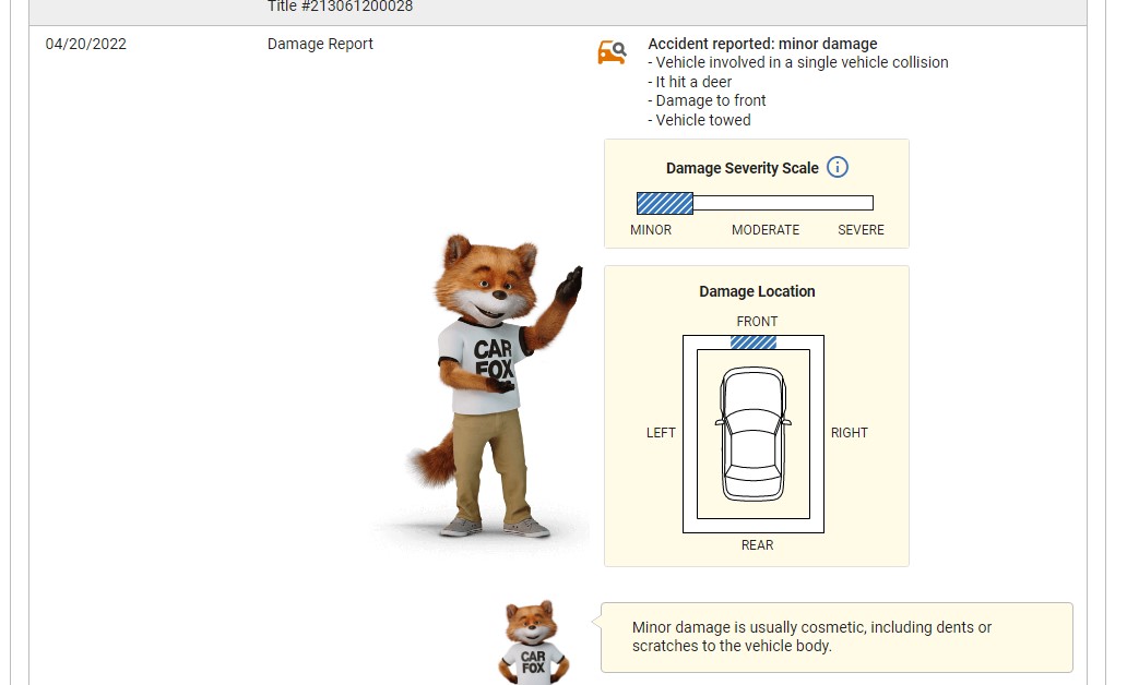

Some of you are placing too much faith in Carfax.
I traded this in on my BW....
I hit a deer on 4/20, did 28k worth of damage and Carfax shows a minor accident......
IMO it wont catch the engine being replaced.
FYI, the deer didn't make it......
@MattH ....well, yes and no. As Joe Average Consumer, you have to use the tools you have available to you. There's also Autocheck and some independent companies too. I have also used GM Global Connect when looking at CTS V's. That tells many stories too. But, at any time that I looked at preowned, it was a helpful tool.
