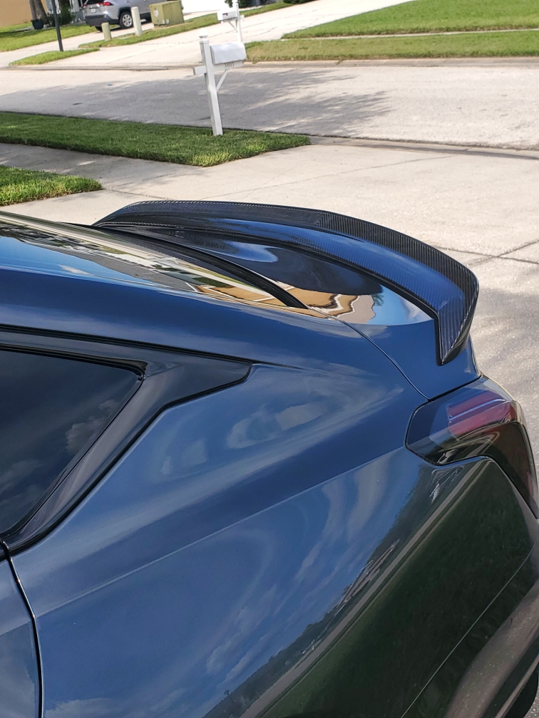

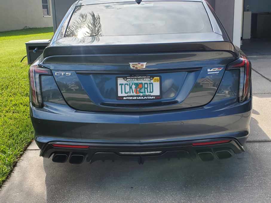

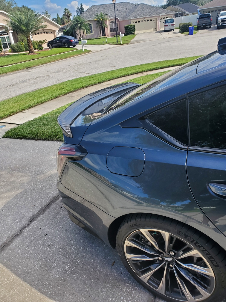

Installed mine on Labor Day, just before the Kong X ported blower and Tony Mamo ported 95mm ZR1 throttle body yesterday. Thanks to all who shared their install info and experiences, it really made the process go smooth.

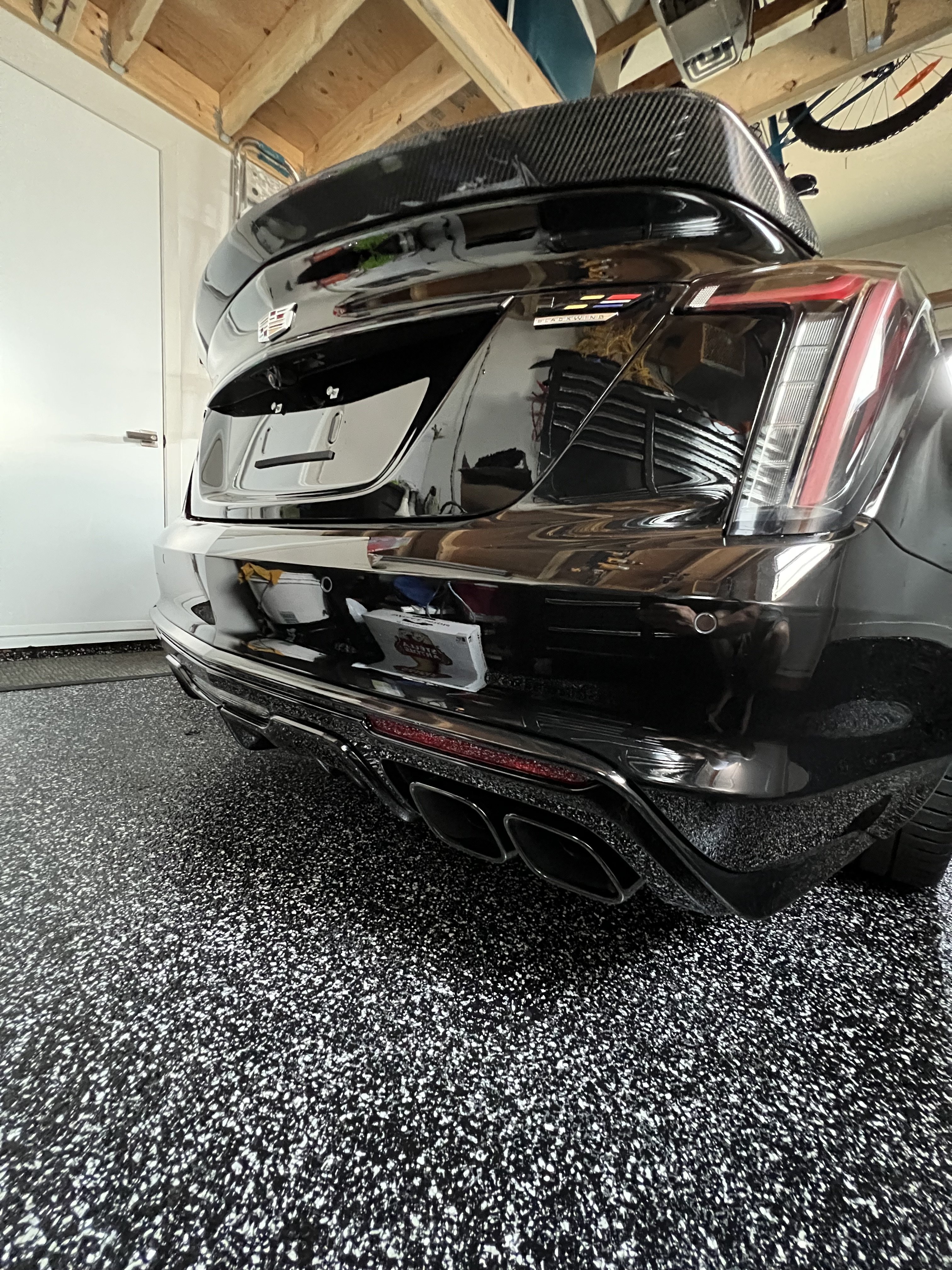

I got my rear spoiler. Great product. Great fitment and finish
