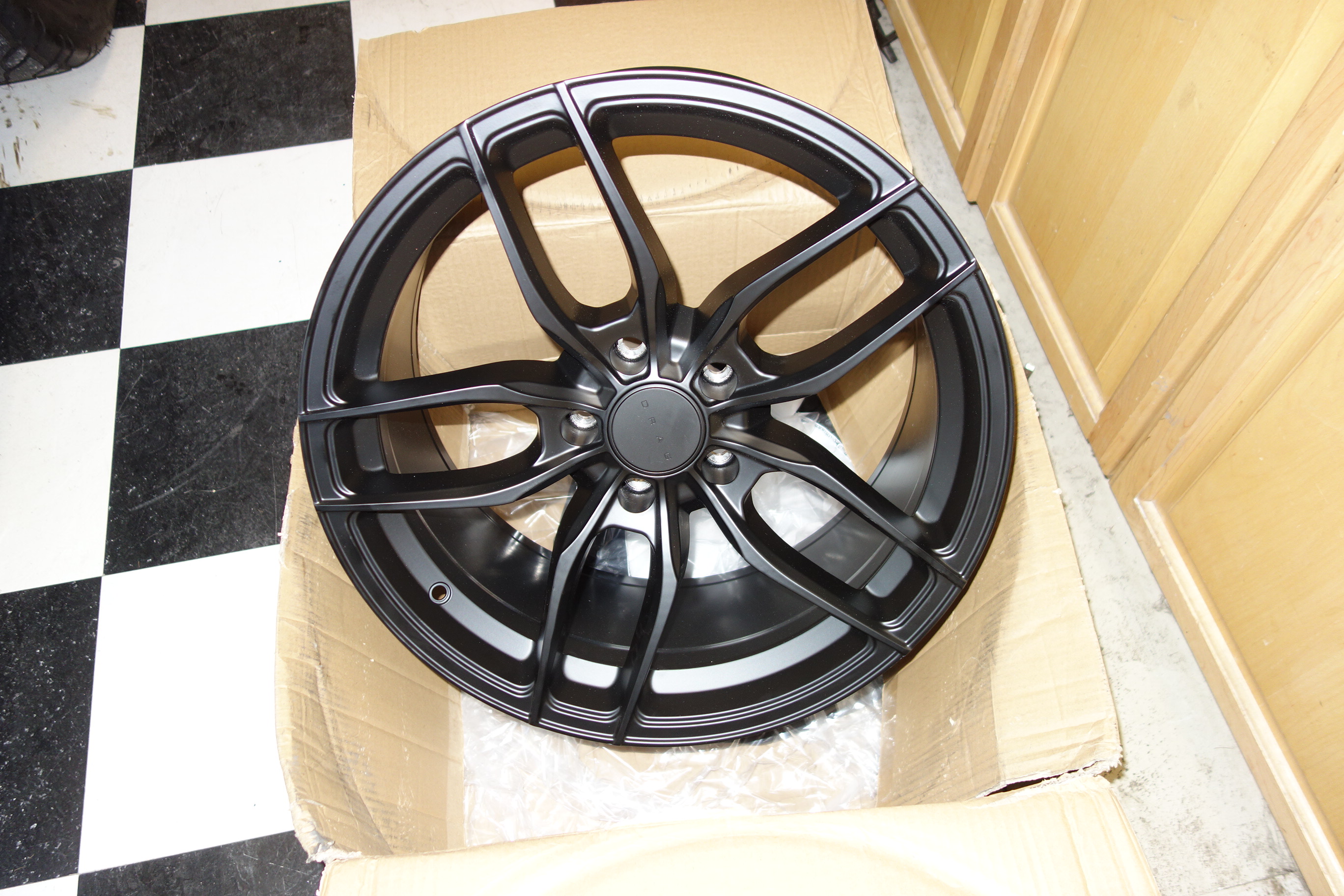

here is the DR-80 wheel that is 19x9.5 the center hub is much larger than stock. centering ring optional but suggested. the bolt pattern is 5x120. technically GM uses 5x120.65mm. Audi and others use 5x120

I'm biting the bullet - ordering 1 Apex wheel 18X9 ET30 to check fitment. I assume there should be no issues in the rear (it will poke 11mm more than stock) , and hopefully it will clear the 4BW calipers.
Mbar - were you able to check if the wheels fit over the brakes?

the Drag Wheels wheel i listed a bunch of posts ago, seems to fit, at a great price!
i'll send pics of mounted on the car when I mount them in about a week

Well I will have my snow tires mounted up in a week or 2. It is possible I will add a spacer to the fronts to get back to stock offset. I would not put a 275 tire on an 11” rim but what do I know. I was thrilled to find an inexpensive wheel that fits. If anyone can find me a made in USA wheel for a reasonable price, I am in.
