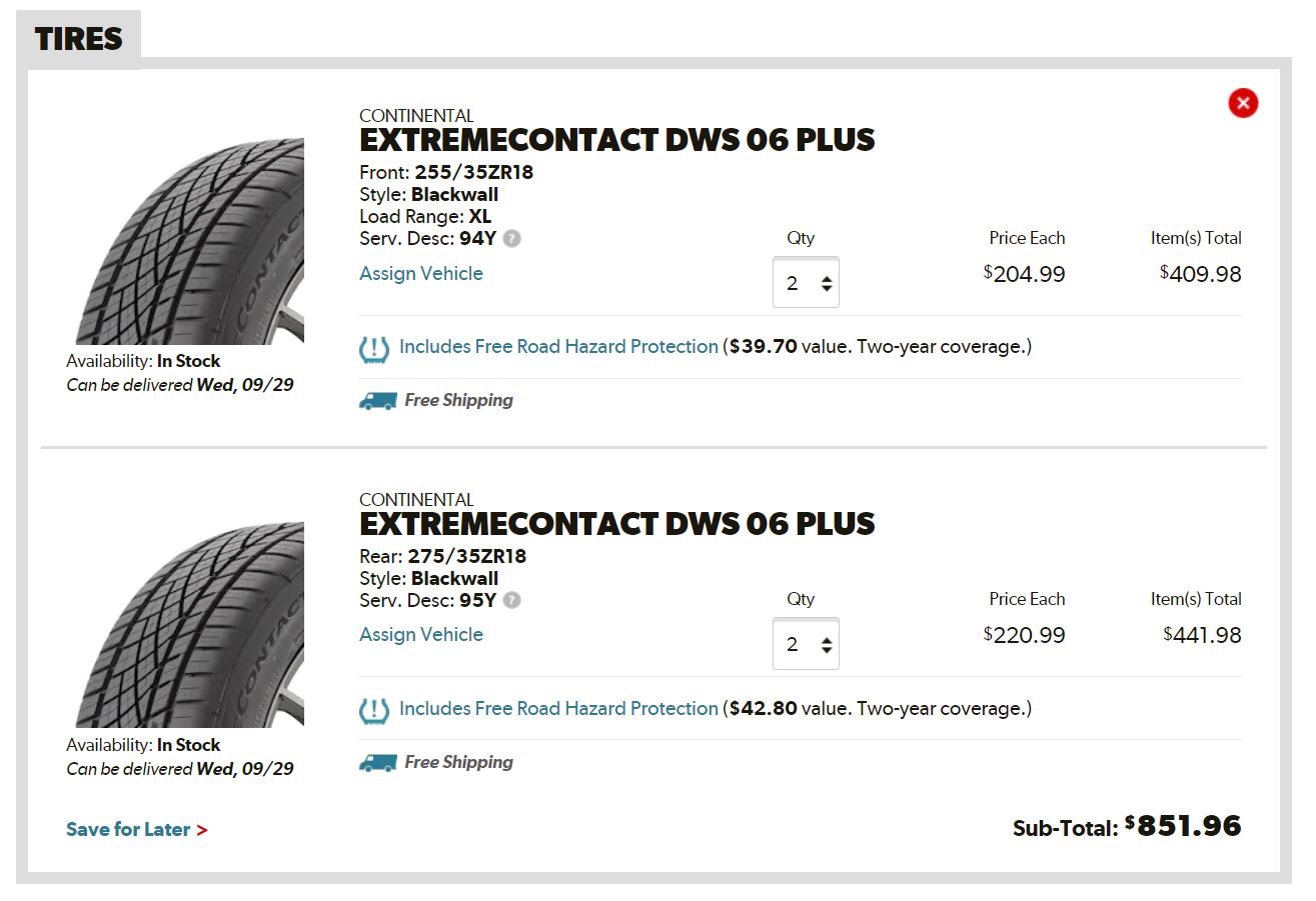

Any reason these wouldnt work on a CT4-V Blackwing? I need to get something so that I can drive it in Germany during the winter months and I havent been able to find a dedicated winter tire yet so all season it will be. Found out my warranty will follow since on military orders.
Any reason these wouldnt work on a CT4-V Blackwing? I need to get something so that I can drive it in Germany during the winter months and I havent been able to find a dedicated winter tire yet so all season it will be. Found out my warranty will follow since on military orders.View attachment 5039
If you're not planning on carrying around a lot of passengers/cargo, they should be fine. The main issue is the lower load rating for the rear tires, hence the non XL designation.
Perfect, yeah I keep it pretty empty. At worst for a little bit IT will be my wife, me and the baby. Until we pick up a second car that is.

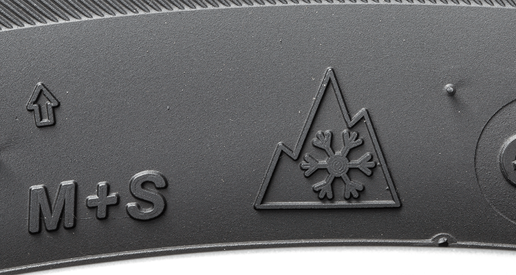

Most parts of Germany and Switzerland by federal law require winter tires. Most people follow the “von O bis O.” October to Easter. Not sure that all season tires will meet the requirement i.e tread depth and have the following symbol.
Where I lived in Switzerland on the boarder of France and Germany we got very little snow and I still had to swap out my tires yearly.
Yeah as long as the all seasons have a winter symbol it's good. I'll just have to check. Last time I was there I had all seasons on my SUV. My M2 had dedicated winter/summer
