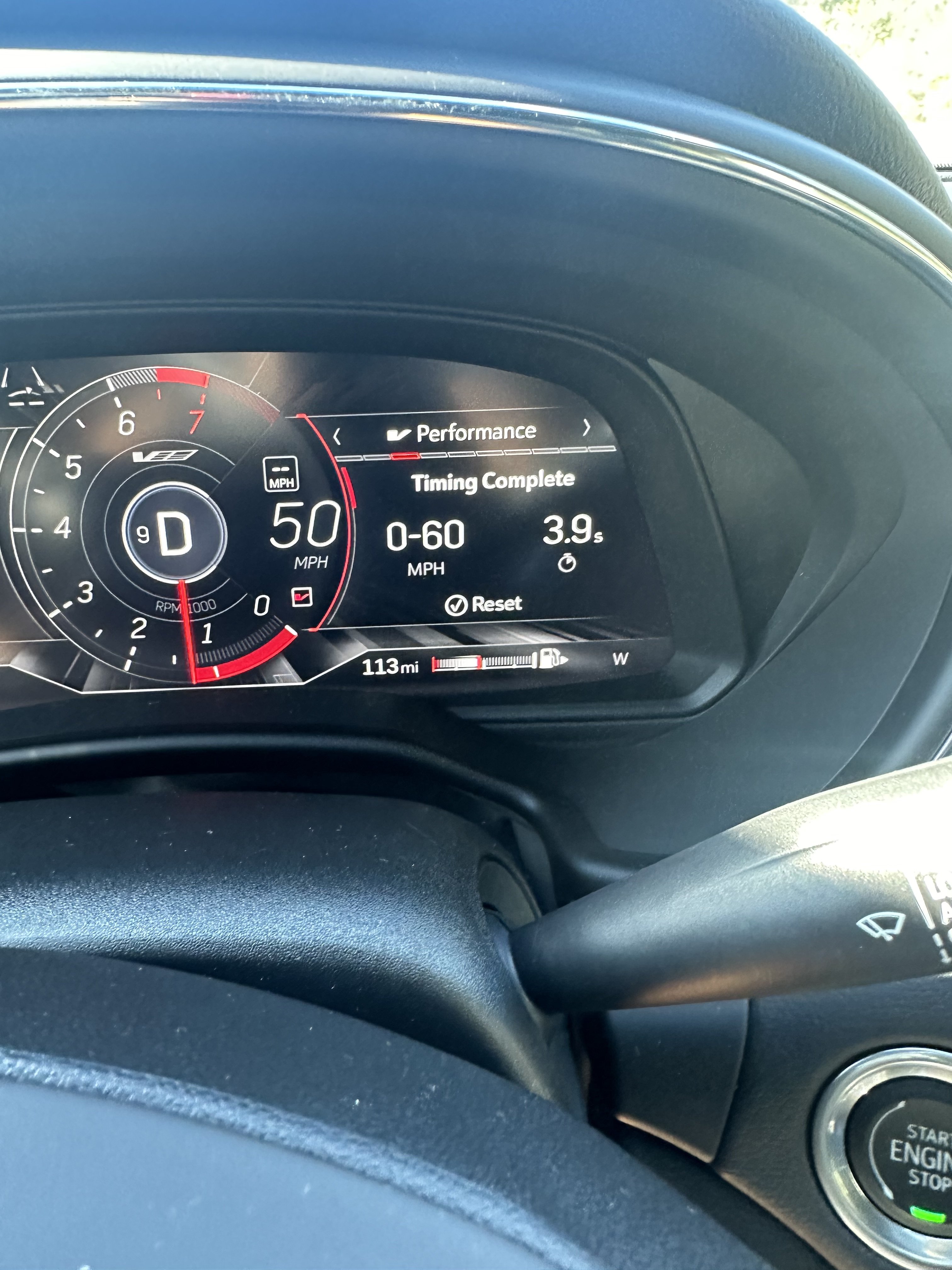

Hi Everyone,
For the first time today, I wanted to try the 0-60 best time on the cluster on my ct5v Blackwing. I was on v-mode completely stopped (on the cluster it said ready). Once the light turned to green, I pushed the gas pedal all the way down and I went over 60mph, but it didn't record the time. Not sure what I'm doing wrong. When I got home, I checked the PDR and the SD card is full and under setting overwrite was not enabled (I enabled it). I think that it should still record and show the time for 0-60 in the cluster even if the SD Card is full. I’ve attached a video for the screen reference (this video was done a couple days ago)
What am I doing wrong?

The one in dash is the one that does not show the 0-60 time (under performance timer). Do I need to change the drive mode under ptm to get this to work? I think I don’t think I need the ptm to be able to have the 0-60 time recorded.

Hey - easy mistake to make. Once you get to the “Ready” screen you have to hit the “select” button (push in on the click wheel on right side of steering wheel). THEN it’s actually engaged and will read “Accelerate to Start”
Have fun :)

Thank you. It worked. I still need to learn the settings. Want to get closet to 3.4. I only did on v mode
