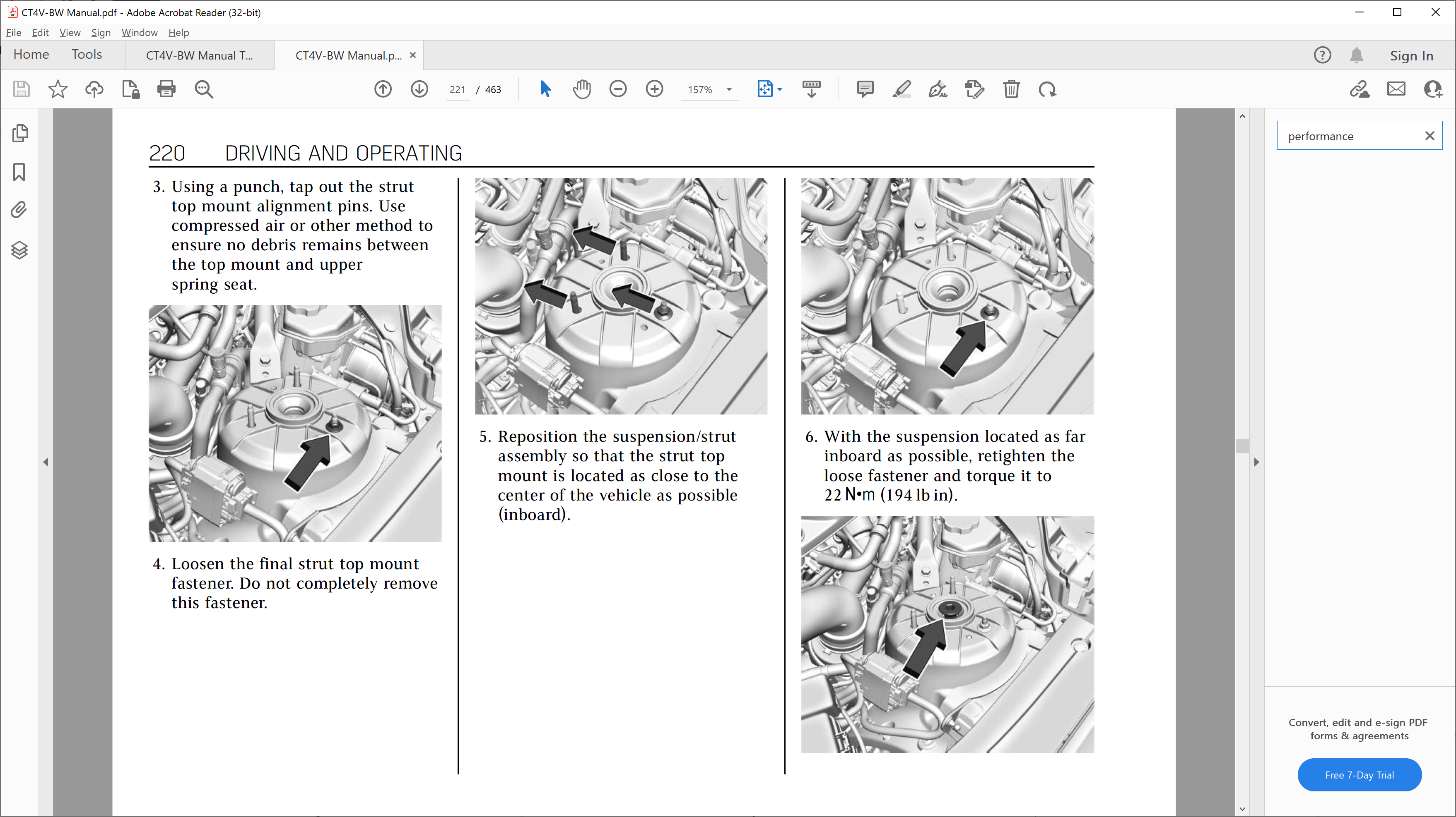

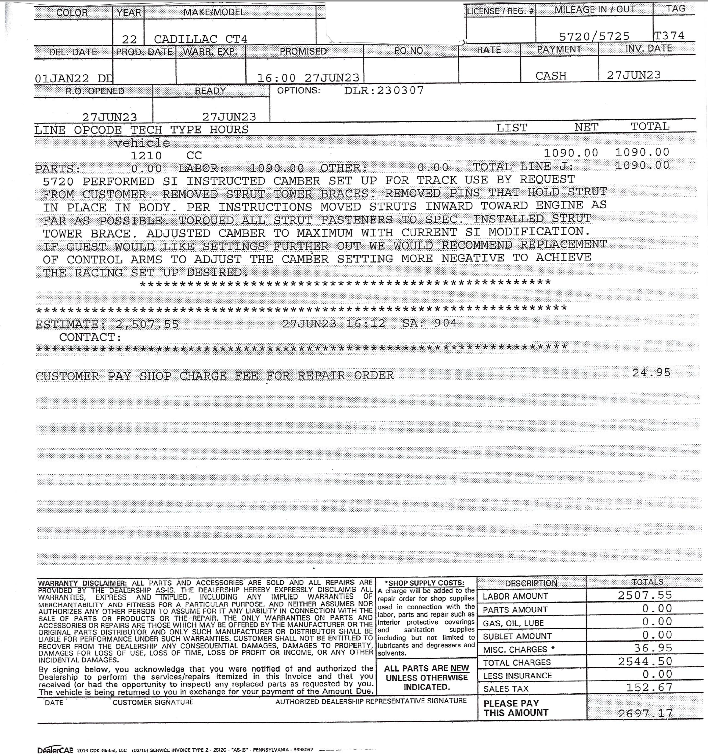

Here is the front suspension item:

Not being able to do your own work on the car definitely drives up the cost. If you could do most of the labor, then you’re paying half. The labor cost to push the front dampers inward is ridiculous. It sucks you don’t have the facilities to do it yourself. That’s pretty easy to do at home. I’d push the top hats inward in my garage and get it aligned the next day.
I don't understand the 1k for front suspension configuration, I taught you just punch the pins, lossen the top plate, push them as far as you can and get an alignment done. It shouldn't be a 1k job.

You are right, I think I got scammed on that item. There is no way that would take 5 hours of tech time to do. There were no parts involved. But once they had the car and I said to do the work they had me.
What in the world… $1000 alignment? What was that for?

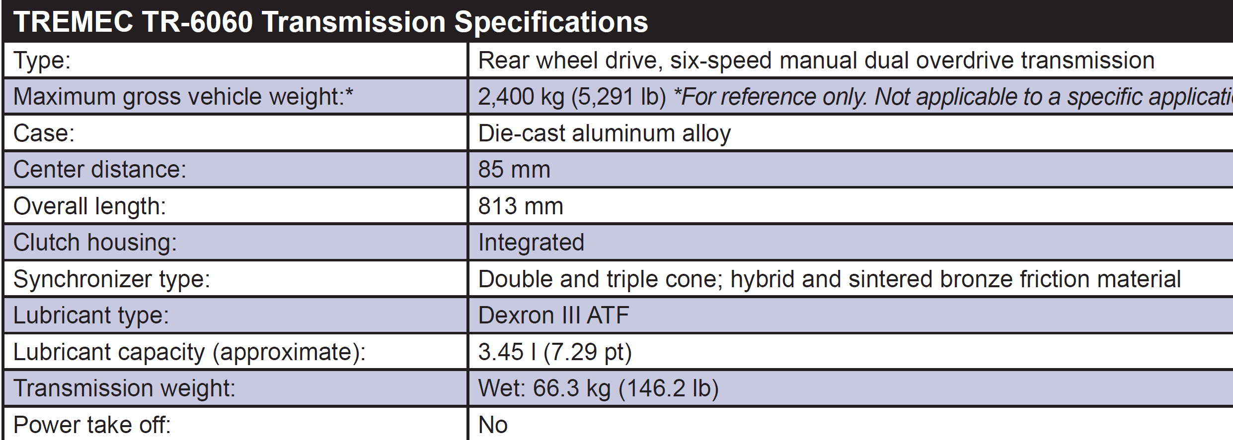

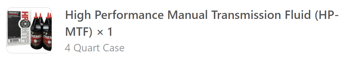

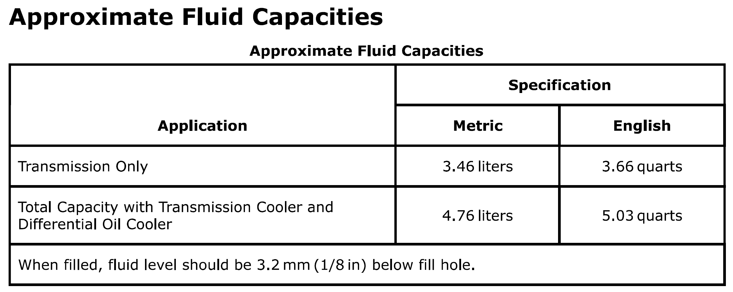

Why did you need 4qt Manual Trans Fluid?
The Tremec 6060 calls for 4 qt of fluid.
I was afraid that I was 1 qt short for the cooler. You cannot get 1 qt of the HP-MTF, you need to buy the case. The dealer did the fluid change with the 4 qts that I provided:

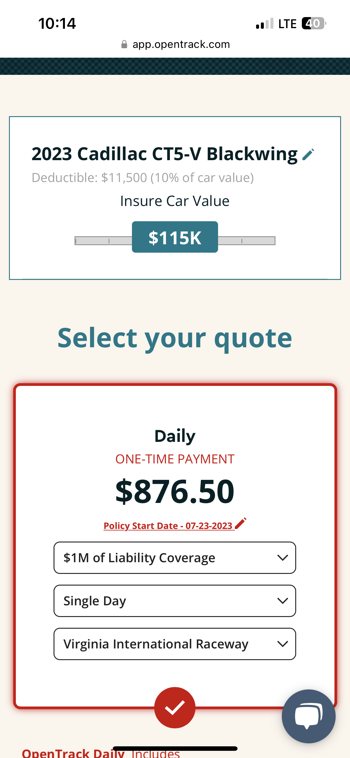

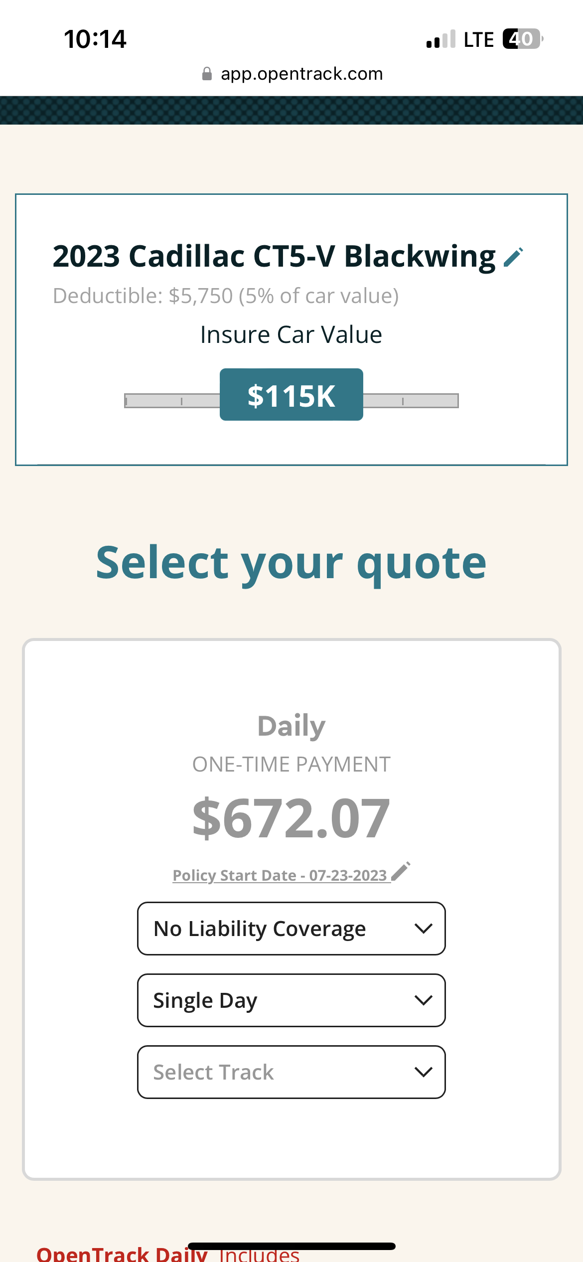

Now I'm in need of all 4 tires (9000 mi), and in CA track day insurance is closer to $400/day!
I agree with your numbers.
$400? Send me the quote - I got quoted $800/day for my 5V
Oh no, the alignment was another $234. The $1090 was for the front suspension modification work.
Guess I’m confused - what front suspension modification was needed? I’m prepping my 5V for VIR and haven’t sent anything about suspension

So it wasn’t a fluid change, you were just adding 1qt to be safe? I have an M6 so just making sure I check all the boxes. Haha

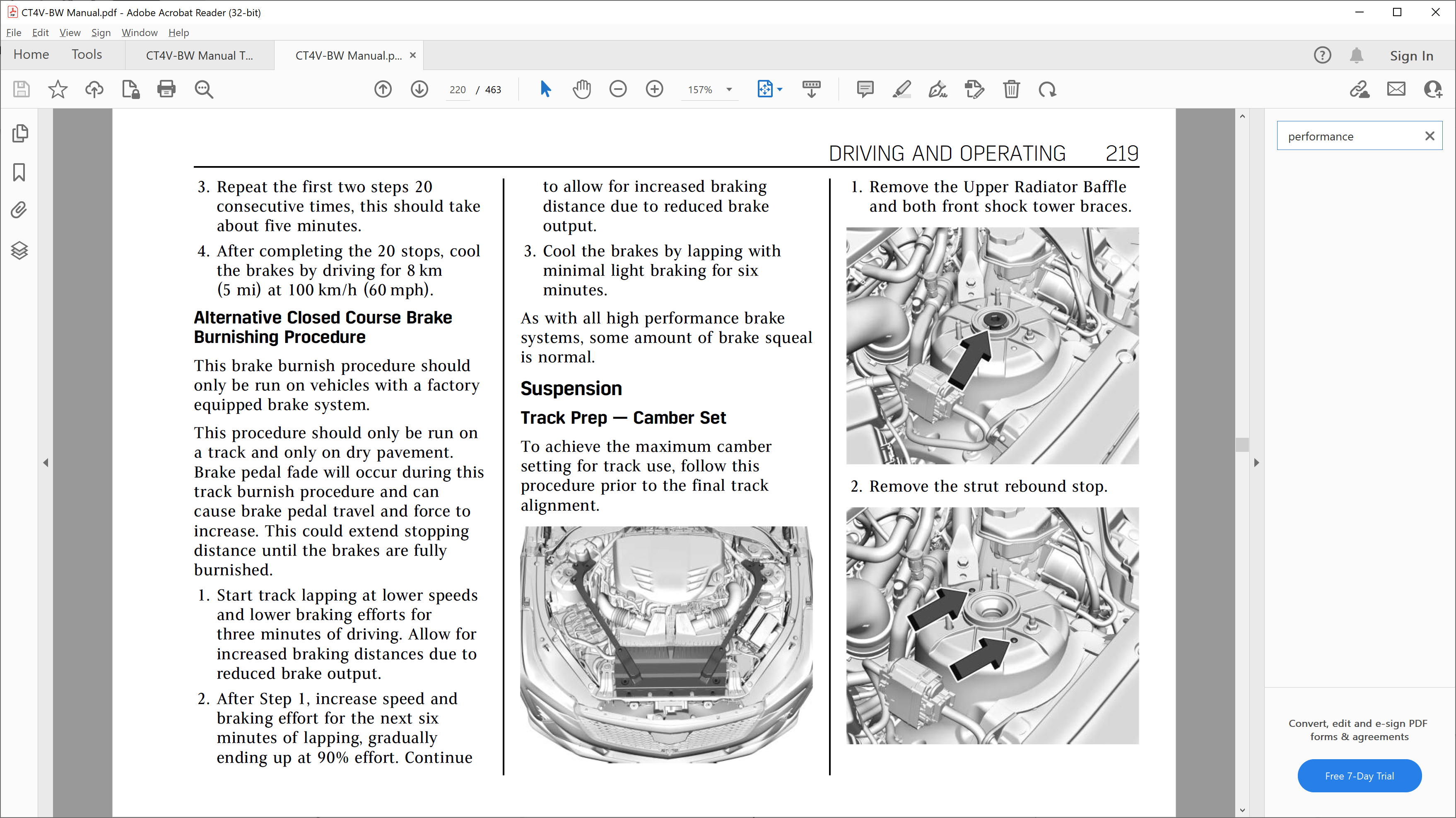

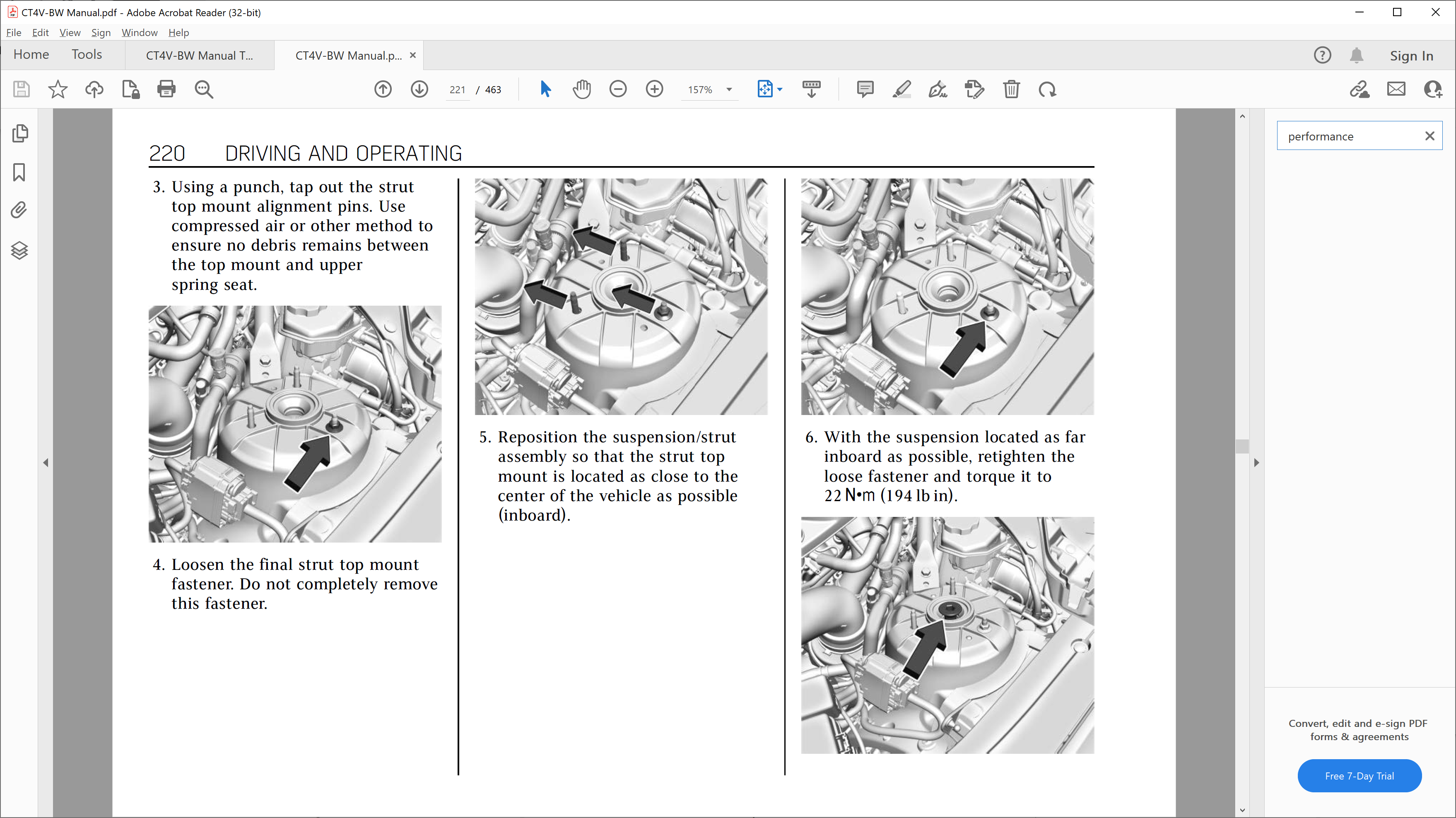

Check in your owner's manual for a section - Track Events and Competitive Driving (V-Series and V-Series
Blackwing) ... You might need to add the front brake cooling ducts (CT4V-BW). This is the one time setup that then allows track wheel alignment :

But they have the cooling duct kit install included on a different line item for no charge. Surely the plastics being installed wasn’t $1000. It has nothing to do with suspension either.
