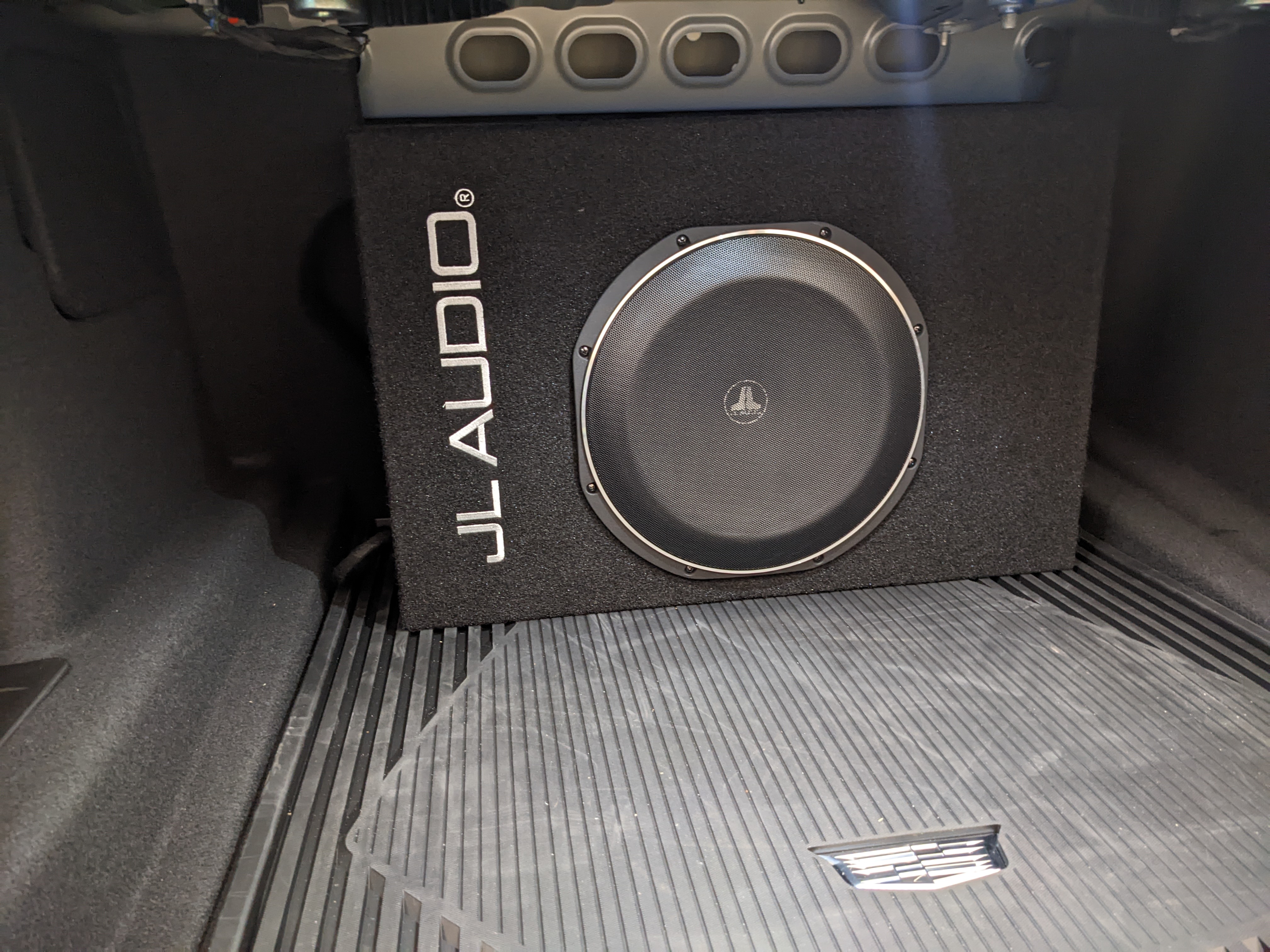

Edit: I went ahead and had a 12" JL Audio Sub installed.

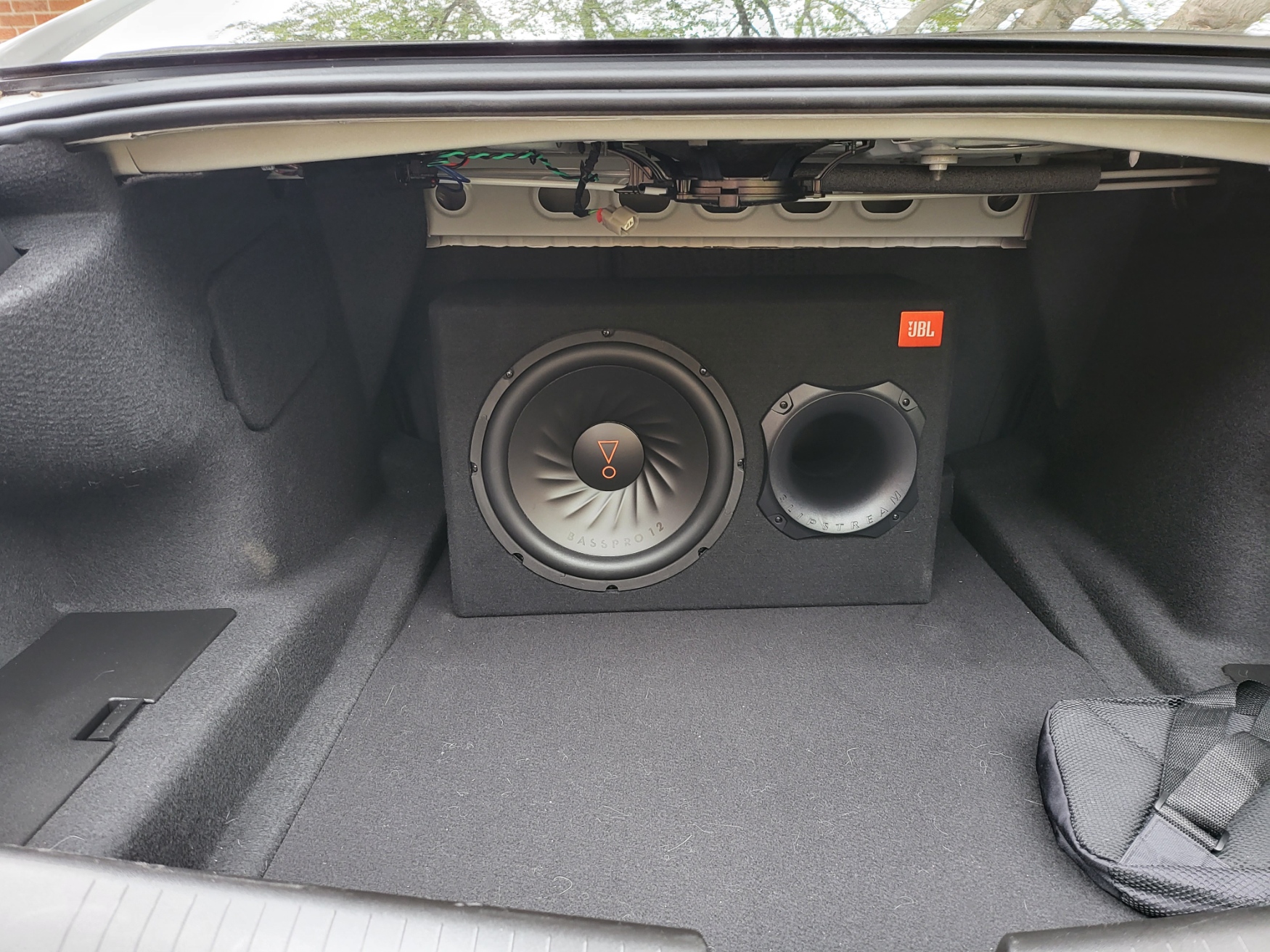

Disclaimer: This is on a CT4BW and I did not do the install, but previously upgraded the audio in almost every car I've owned.
I was/am very satisfied with the AKG system but longed for some more punch at lower volumes like you mentioned. I went to look at a car audio place nearby and they had some AIO sub boxes for pretty decent prices including install. Cheery on top is they also did window tint which I was also in the market for.
Again, I didn't do the install but it seems like it would be very easy on this car. The shop grabbed power from the battery, conveniently located in the trunk, and used a line-out converter from the existing sub in the rear shelf to provide low voltage RCA input to the box. Not sure where or what fuse was used for the remote turn on. I wanted the same option of having it easily removable and installed and harness on the power and ground to easily disconnect (https://www.amazon.com/dp/B07C69HJ2B?ref=ppx_yo2ov_dt_b_product_details&th=1). Thought it was weird the shop didn't offer this, but it was easy enough. Still have to manually unscrew the remote activation and need to install similar on that smaller wire. Otherwise the box is secured with Velcro strips on the bottom.
One big thing: That rear shelf is not very well sound-deadened. Vibrates a lot. Haven't done it yet but plan to use butyl matting to reduce the vibrations, as it is obnoxious at high bass levels.
Went with a ported box for maximum thump, 150w RMS. JBL Basspro 12, with install under $400. They did install the remote volume control just to the left of the HVAC controls. Running that wire was probably the most difficult part of the install. All in all I love the result and it gave me just the punch I wanted, and the external control allows me to dial in just the right level. Oh and we disconnected the stock sub

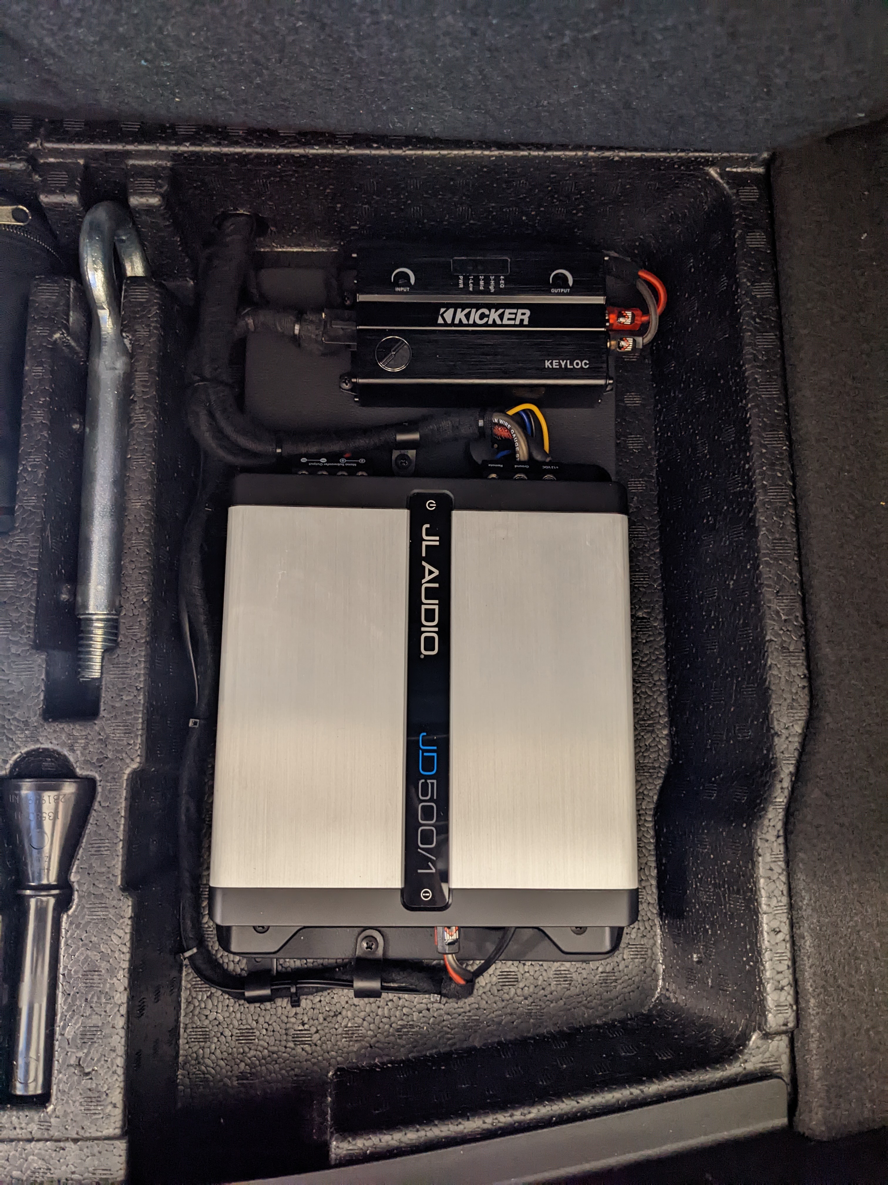

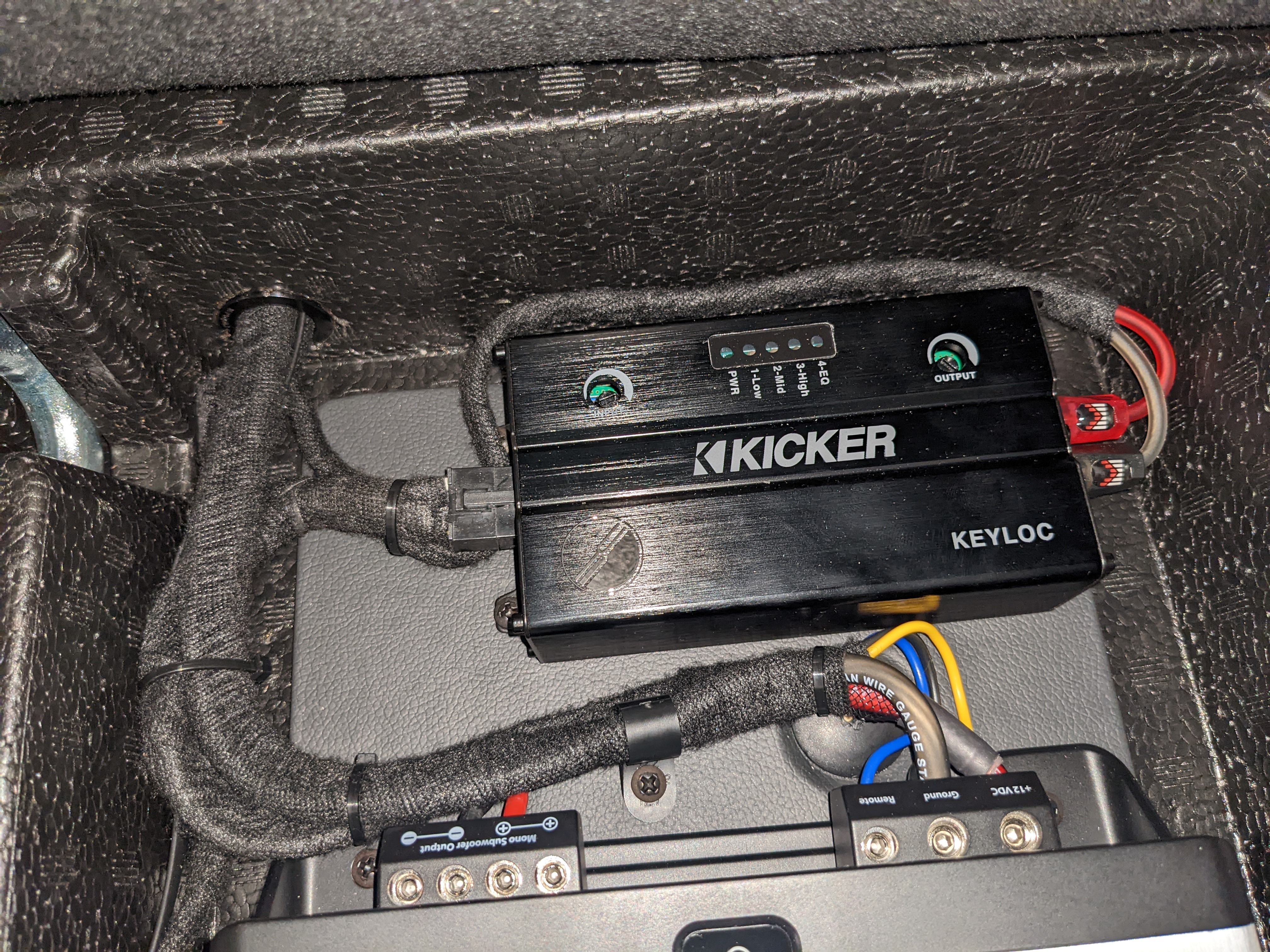

-JL Audio CP112LG-TW1-2 Microsub 12" Ported Enclosure
-JL Audio JD500/1 500watt, single channel amp
-Kicker KEYLOC
-JL Audio Remote Bass Controller
Signal goes from the speaker level inputs from the rear 6x9 "subwoofers" into the KEYLOC, then to the amp and sub. We left the rear deck subwoofers disconnected since they only provide low frequencies anyway. We depinned the 3 ANC microphones from the harness at the factory amp. ANC no longer works, but I think the exhaust is now a little louder inside the car (could just be in my head). My goal was for just a little increase in bass at low levels, and a super clean install. I think it sounds great, nothing rattles, and I can easily pull the sub out for track days, and when I need the trunk space.
-Kicker KEYLOC
View attachment 13611View attachment 13612

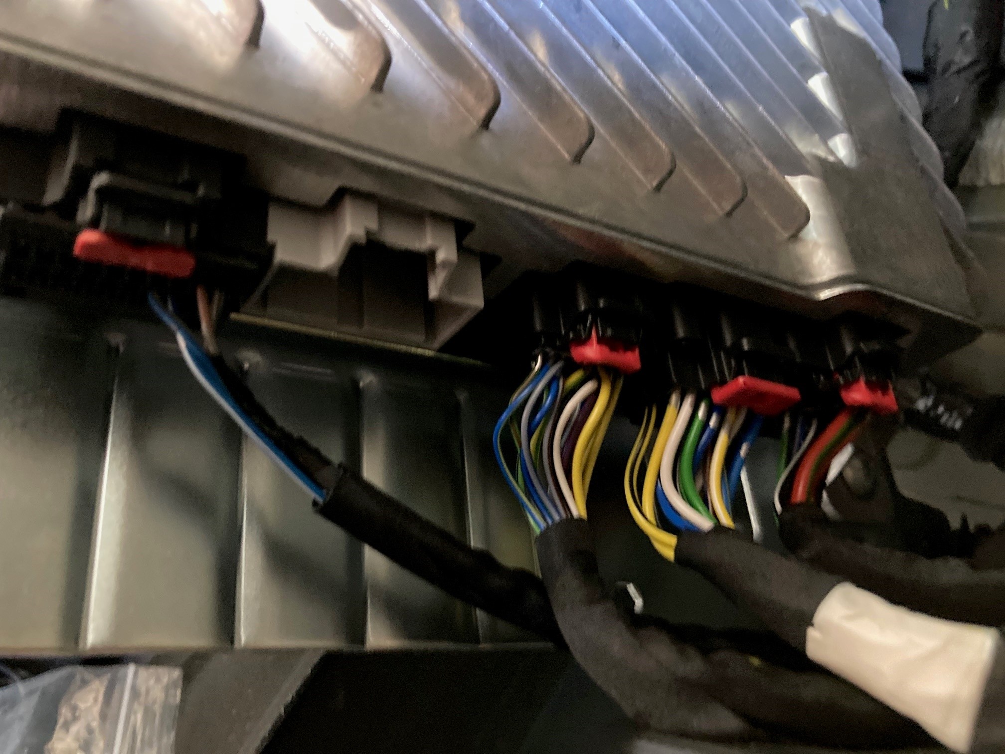

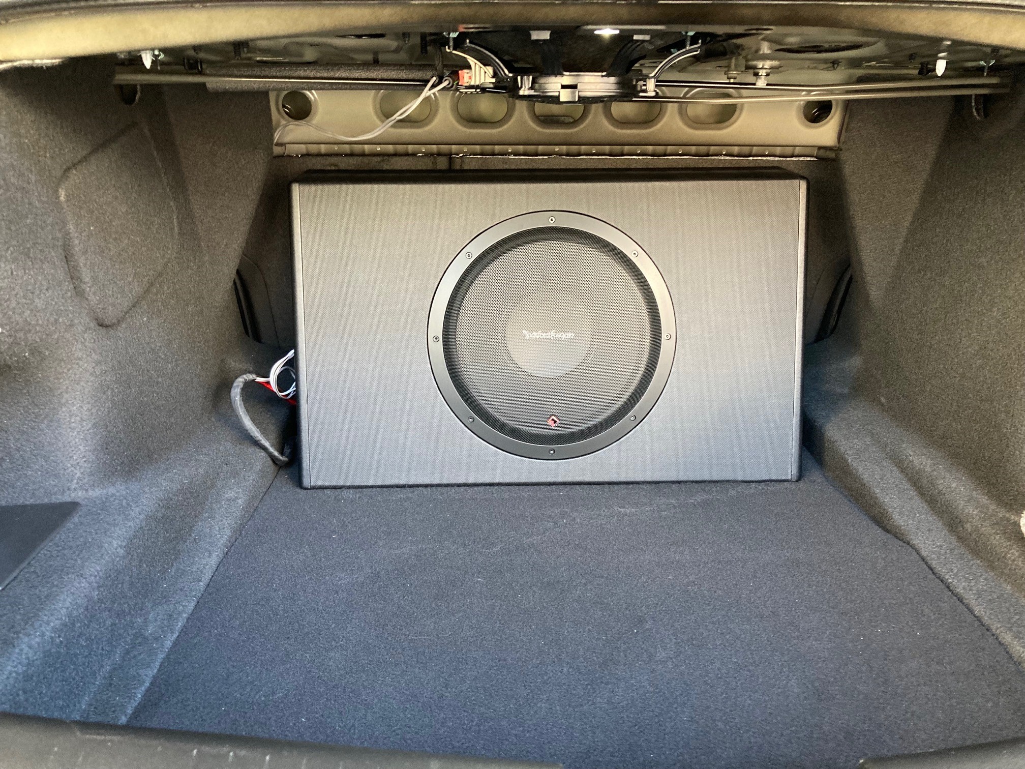

Any advice on this part (ANC AMP pic attached)? I installed a P300-12T (the slender truck version) in my CT4 BW and have the ANC feedback. I reached out and am still actively communicating with lljcustoms but the last message we shared was them telling me that "if I have a factory sub I cannot have ANC." I sent pictures back to them of the mics in the car's headliner and believed that cleared it up but no solution yet. I did the install myself and overall I am happy with the fit/finish/sound when the car is stationary but the ANC feedback when moving is a deal breaker. I see in the manual about the ANC it states "Deactivation is required by your dealer if related aftermarket equipment is installed." I really don't want to go to the dealer for this. Any help is appreciated. PS. ignore the wires in the pic, I am still working on the install.

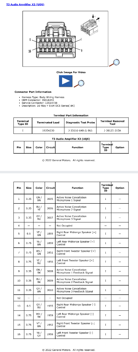

I believe the 4BW and 5BW are the same, but I am not 100% sure. They have the same RPO code for the stereo (UQS). I didn't download the diagrams for the 4, but this is for the 5.
Unplug the X3 connector. I cannot remember which one it is in your picture, but match up the color of the wires with the diagram, and if they all match that's the one. You can either cut the wires 1, 2, and 3 (all of the ANC mics). Or, get a depinning tool (the correct tool is J-38125-215A) and disconnect them from the harness. You might need to Google how this connector releases because it is a little odd. It has a part that slides then you can get to the terminals. Also, I'd make sure all the colors are the same as what is in my diagram, otherwise you'll need to get to the factory service manual for the 4.
