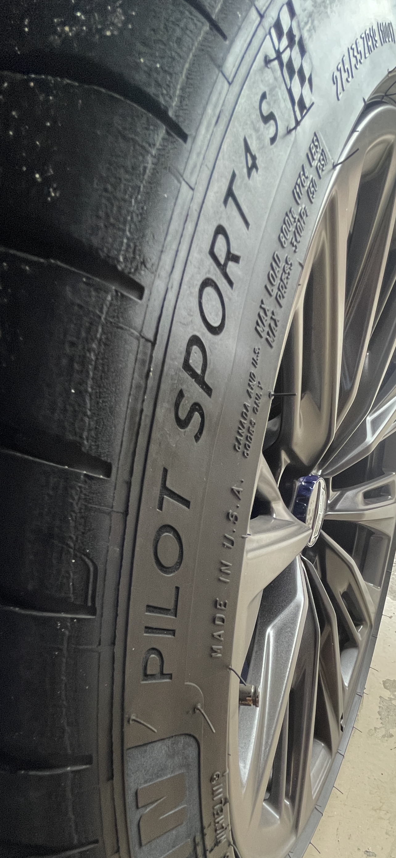

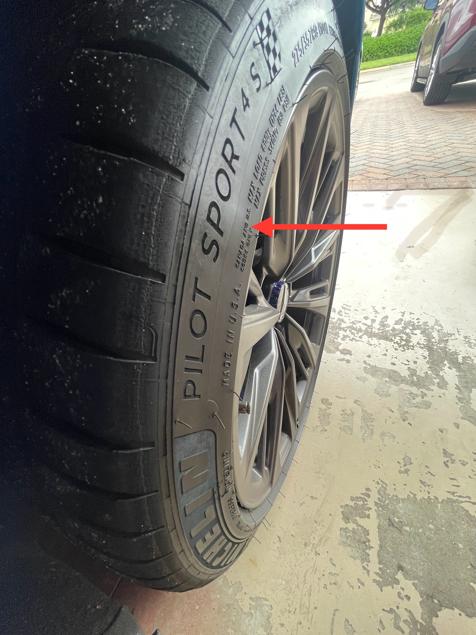

Found a minor sidewall bump in my front passenger tire today. It’s not too pronounced bump or golf ball like I’ve seen before.. how many of you all would rush to replace the tire?

You might need to run it through Michelin. That's internal damage and, judging by the lack of damage to the finish of the sidewall (i.e. like if it was scuffed or torn), that just proves it's not driver error.
IIRC, the vehicle came with a tire warrany from Michelin. Look over all the paperwork provided by your dealer when you picked up the vehicle. Even if you don't have it, I'd still contact the dealer &/or Michelin about possible warranty coverage.
The Caddy dealer will tell you to talk to Michelin. Hopefully you have a good relationship with a tire dealer that will help you.

Yea... I'm guessing it'll go the same way for me. Appointment with Caddy tomorrow. Tire warranties are such BS...
Discount Tire submitted a claim to Michelin on my behalf when I still had my CTS-V. I think they covered half the cost of a replacement which I was pleased with.

Prior to bringing into the dealer, I found another, albeit smaller bump on the front driver side tire in addition to the previously found front passenger. I spoke with the service manager and GM will be replacing both tires under warranty, which is great news.
