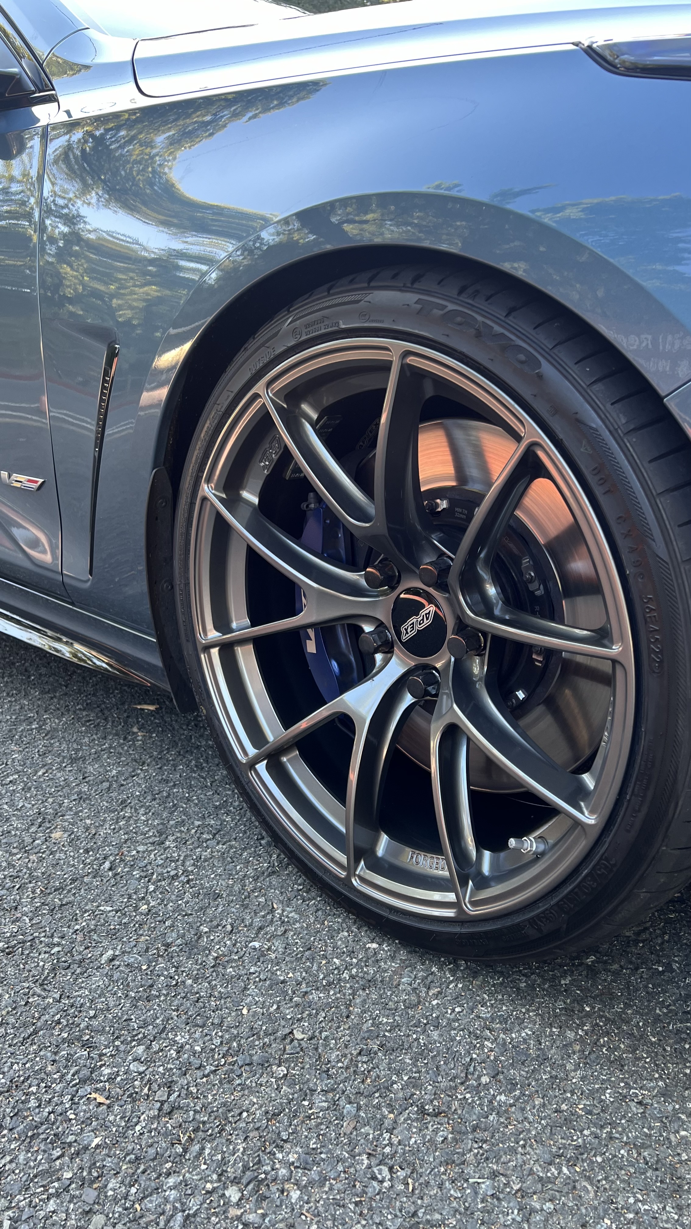

So I’m currently running apex VS5-RS wheels fronts are 19/9.5/et22 and the rears are 19/10.5/et45 the current tires I have on are Toyo proxes sports in 265/30/19 and 285/30/19. These Toyo proxes are not great and hold the car back a lot in performance. Now since I have a 19inch wheel and a wider diameter I can’t run the OEM TPC spec tires so that leaves me to either running the regular PS4S or I was thinking of Cup 2 Michelins. The OEM TPC spec tires uses similar rubber the the cup 2s so I think they might perform better at 10/10. What do you guys think I should do?
