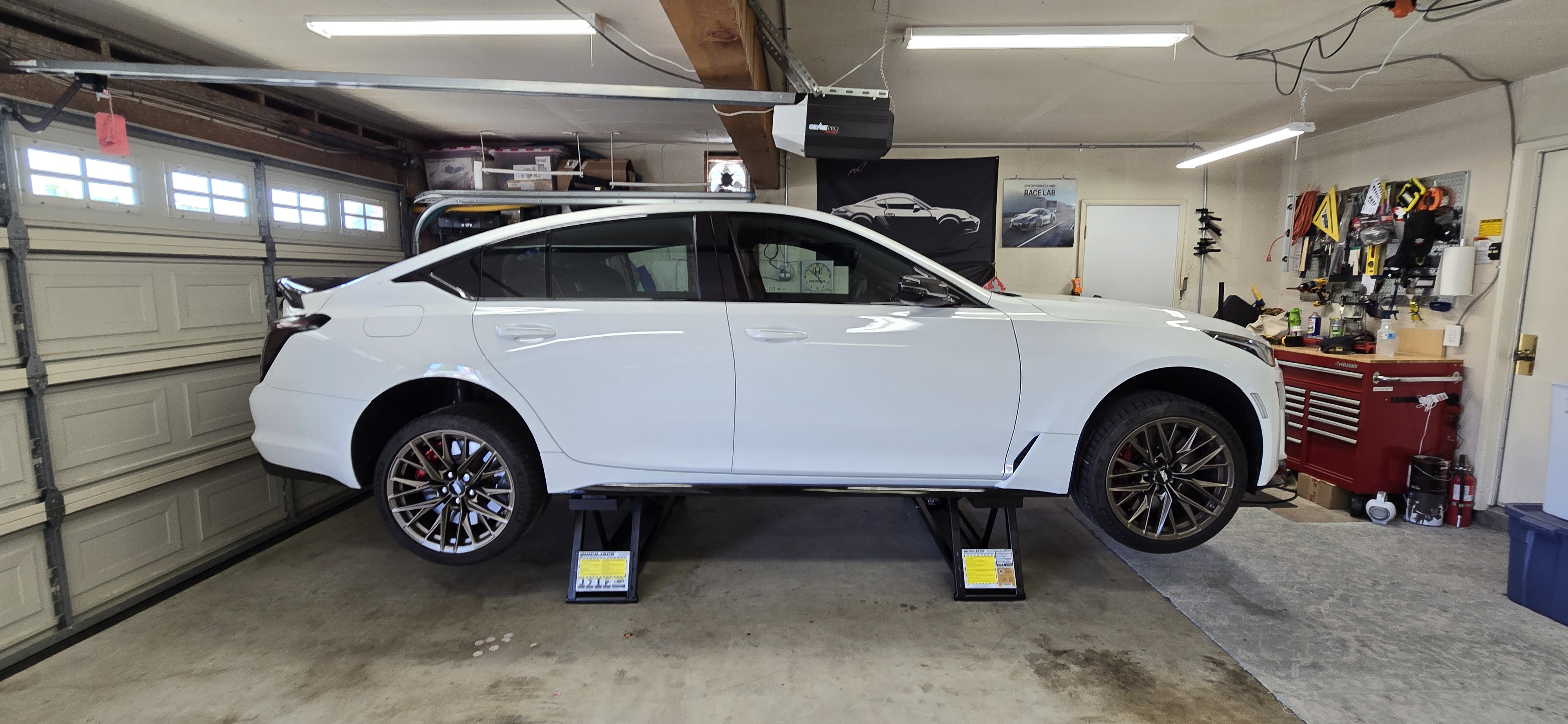

I will share that it's been a struggle in some respects. The spread between lift points on a vehicle can vary wildly from model to model. My first QuickJack was too short for a V3 CTS-V. I replaced it with a 7000EXT which worked on the V3, too long for son's Camaro and Corvette that replaced it, and too short for the 5 BW (and WAY too short for our G05 BMW X5.)
So the answer to all the problems is to turn the units to run under the car from side to side instead of front to back! It's a suggested solution from the manufacturer and works for all of our vehicles now. In my case, I have some scotch tape marks on the rocker panels to help me quickly align the QJ with the lifting points.

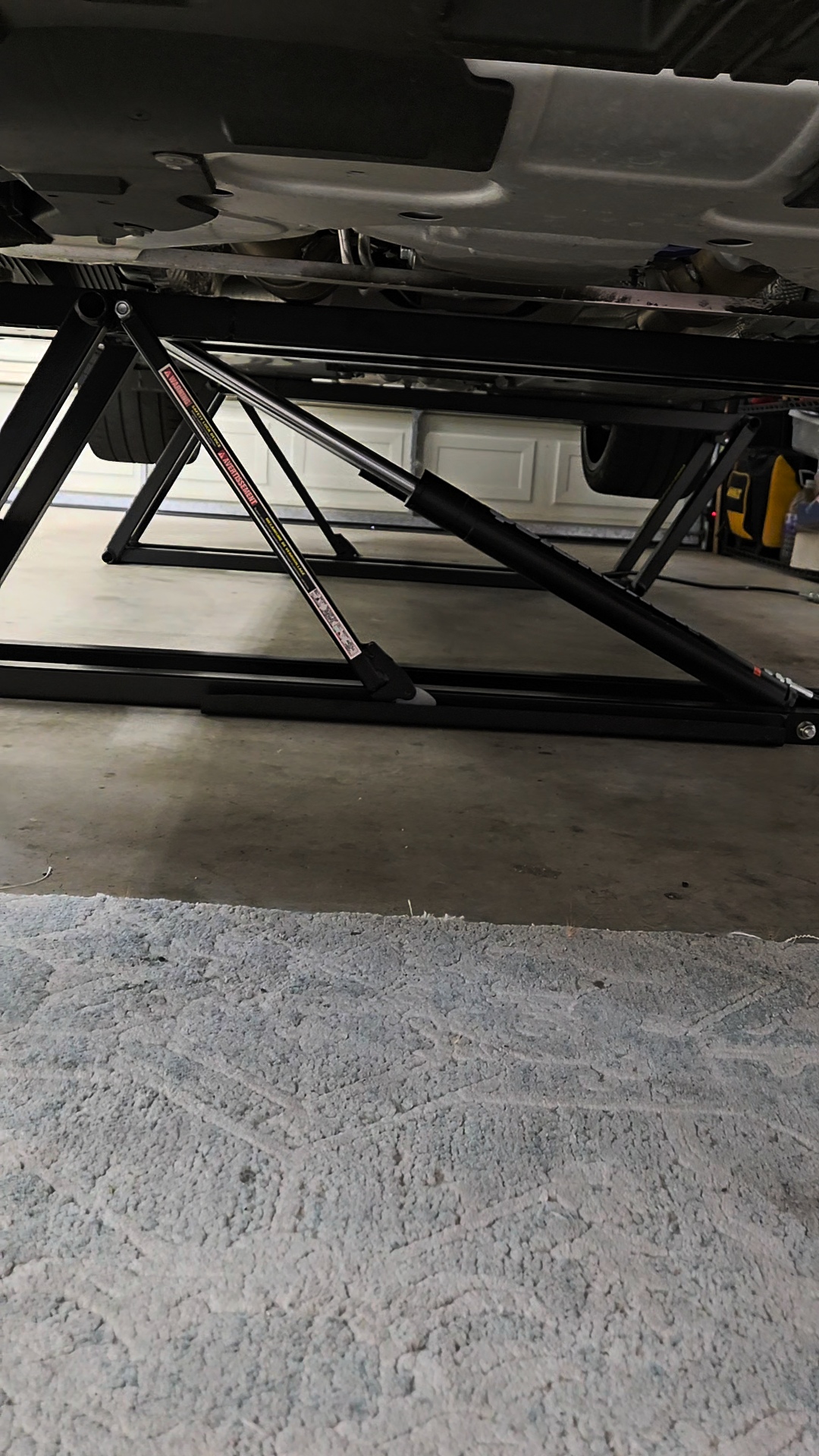

I found a photo how it looks. I have the 7000TLX. If I was only planning to lift the 5BW I would have gone with the 6000ELX. The elx frames would be able to lift the BW the normal way in parallel with the wheelbase of the vehicle, however, they are way too long to lift my Porsche cayman or any other small sports car. I wouldn't be able to lift the Cayman even if I inverted them, or lift my Mazda cx9. They are very long.
You better take measurements if you plan to lift anything else besides your 5BW with the 6000ELX.
Ah here we go… I pulled the specs for all units to compare. Yea the 6000ELX has the longest frame length at 86.75”.
