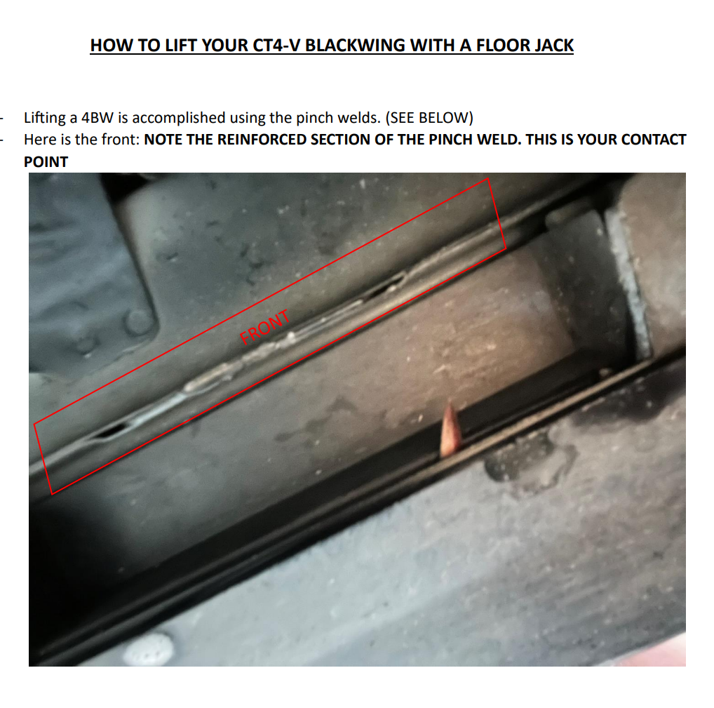

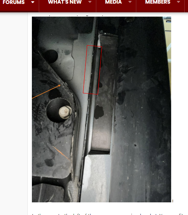

Front easy enough. Quickjack supplied Rubber block between contact patch and pinch weld. Make sure rubber block isn't interfering with rocker panel. Admittedly, the red pinch weld adapter in the guide seems like it would be best - on top of a rubber block, for extra clearance from the rocker.

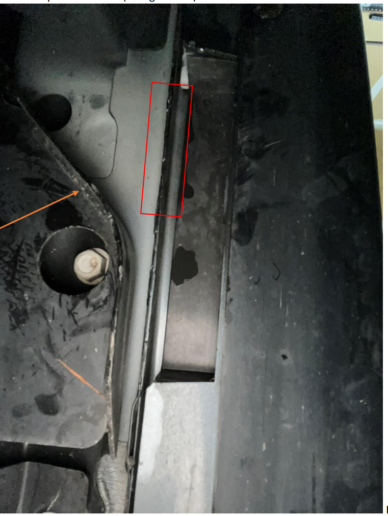

In the rear, to the left of the orange arrows is a bracket. You can fit a block there and lift from there.
Since im not under the car right now, using photos from the supplied guide in this thread - which is amazing btw. These jack points have been discussed in great length in this thread and others.

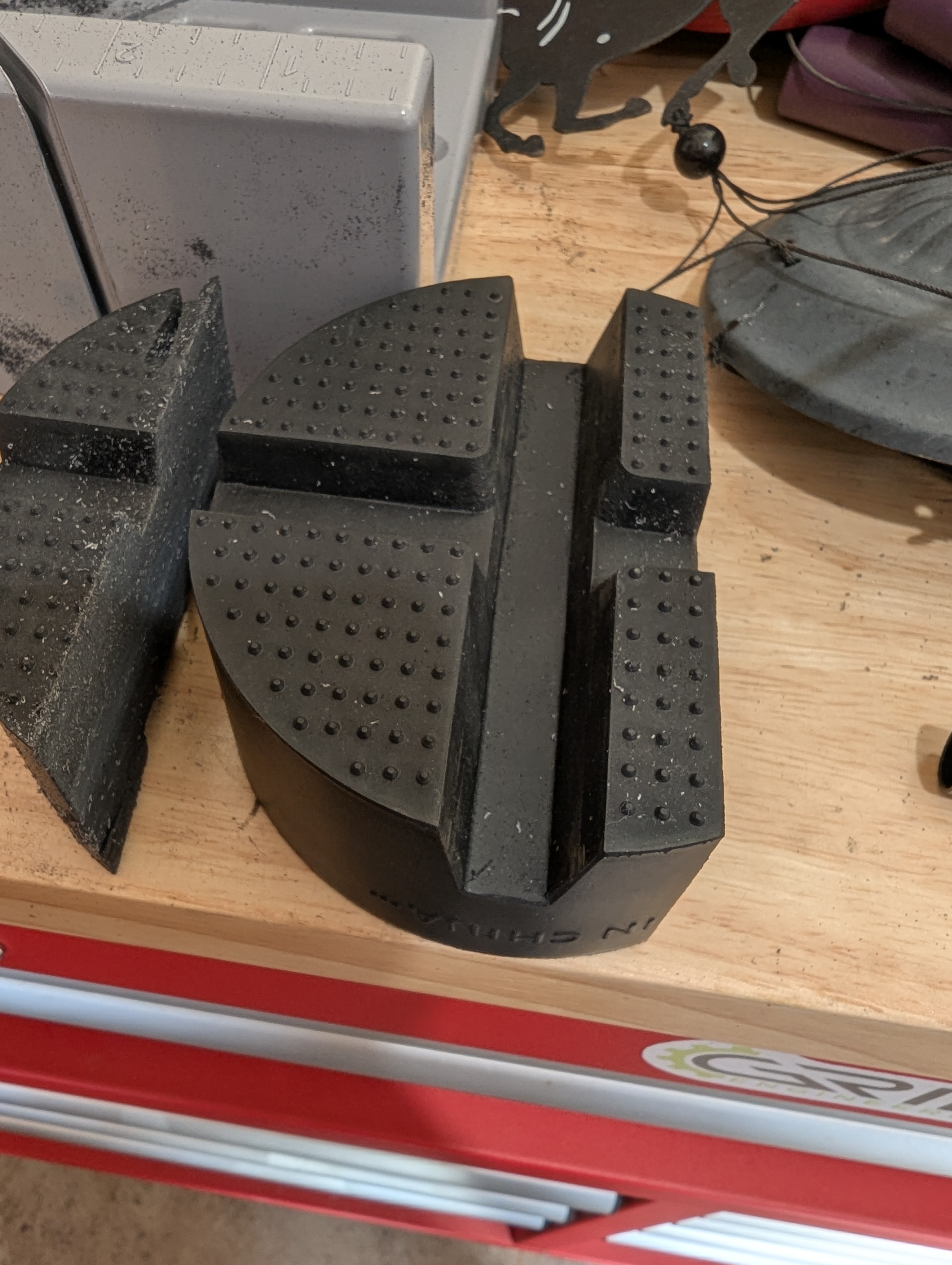

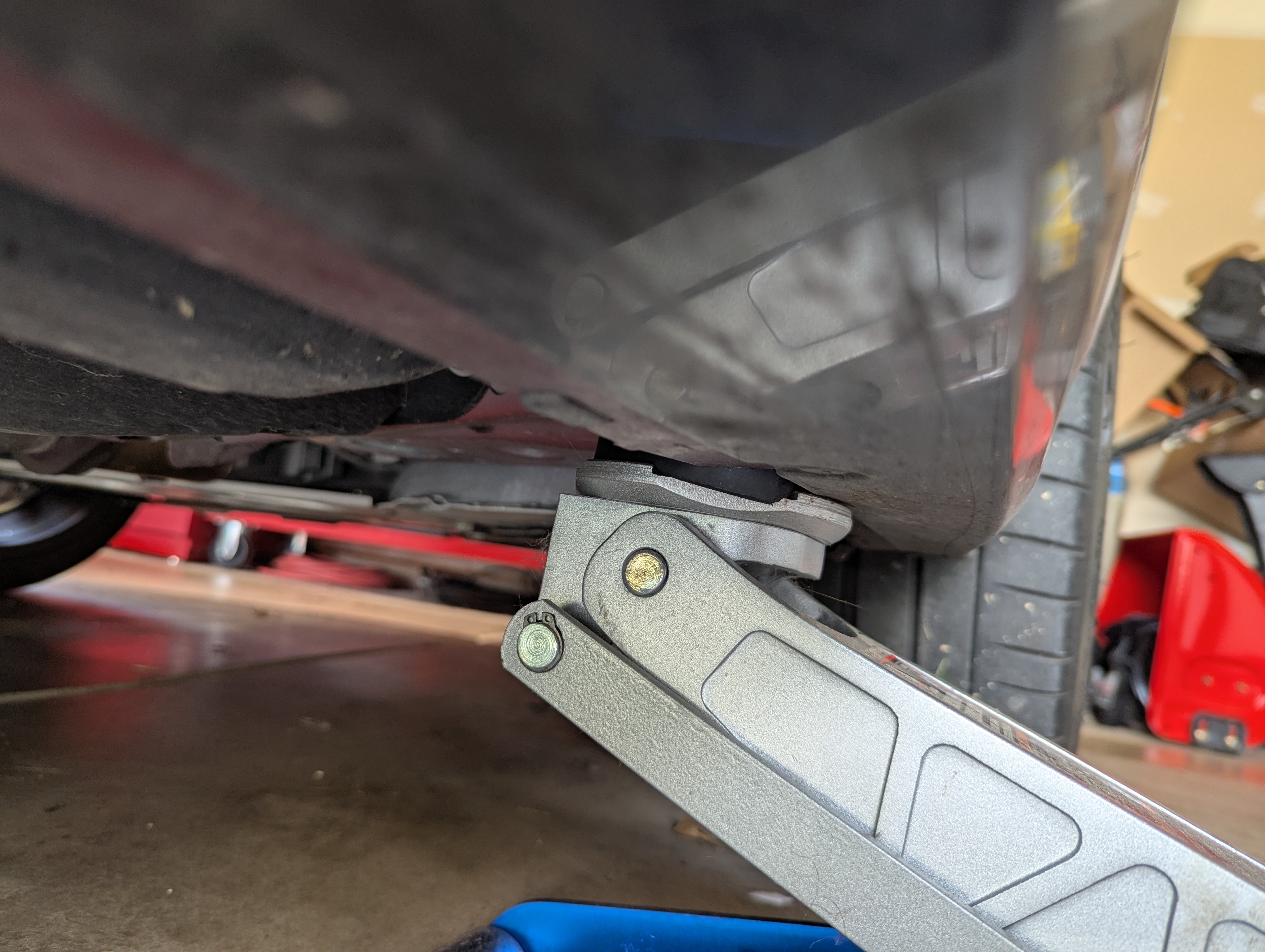

Which adapter/head are you using? There's a bunch of options.
i use the Universal Crown/Castle Jack Pad. I bought some rubber sheet and cut them in circles to fit inside the crown. And I also use ZL1 Addons lift pads. You may need a different setup, but I can say the Rennstand concept works very well. Easy to setup, takes up no space to store. I have two low profile 3 ton floor jacks.

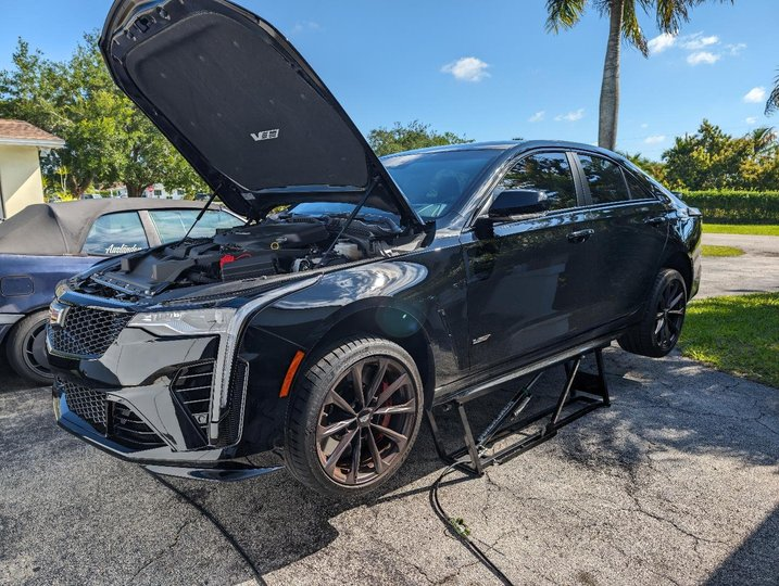

I followed this same method using a quickjack 5000 SLX. Pinch welds up front with rubber blocks/pads and then rubber blocks on the rear suspension bracket. Took a few tries to make sure everything was lined up (always overly cautious lifting a car up for the first time), but once that was done, was up for a few hours for first fluid changes with no issues.

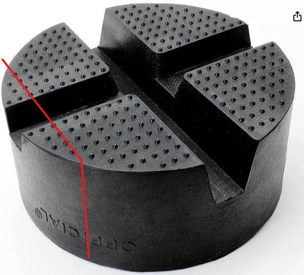

Although I purchased the recommended jack pads from this thread, I ended up pivoting and followed another method instead.
Some of you may have seen the other thread on how to adapt ZL1-style pads to 4V BWs with minor trimming. Someone else took the plunge and I followed in their footsteps.
I tried it yesterday with my QuickJack 5000SLX and tall blocks and it worked flawlessly. Here's my writeup with pics in that thread in case anyone wants to check it out.

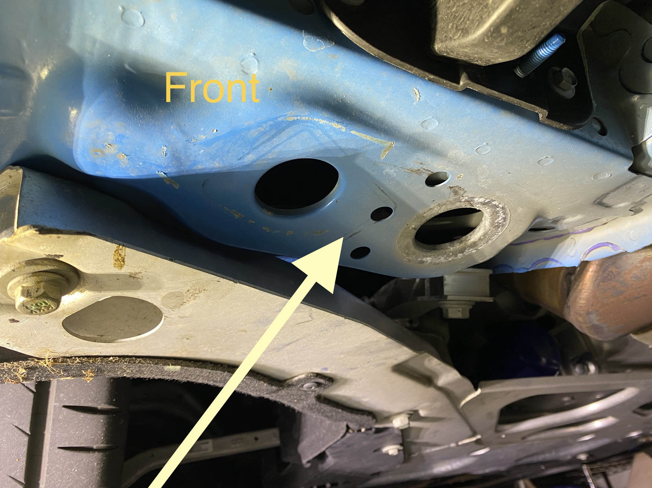

rear - I have used the cradle brace area where the orange arrow points to with no issues so far - lift from pinch weld then lower onto the structural brace
front - put some duct tape down so you don't scratch the surface up. Personally, I have only done this once up front, I typically just do wheel swaps. Hockey puck or a lift pad may also be a good idea here to distribute the load a bit
