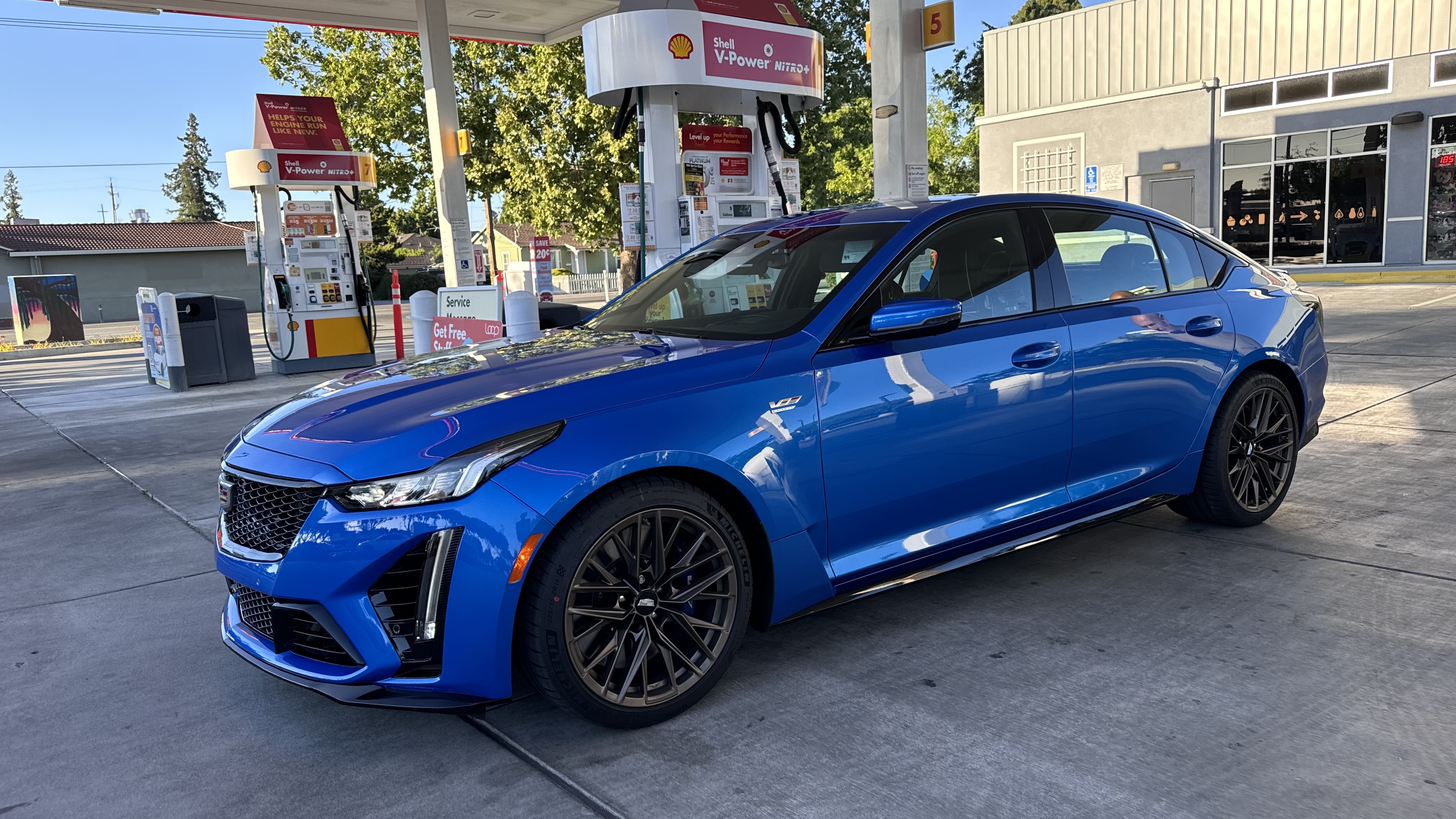

Thanks. I got the car from Michigan.
Coastal Blue Metallic, slicktop, bucket seats, manual, bronze wheels, and blue calipers.
