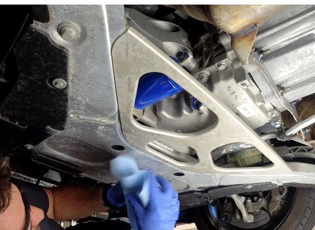

My car is away getting PPF'd, ceramic, and tinted so I cannot look. So the filter and drain come out of the same, nice hole? That seems awfully convenient. I've got 2x8 6 foot long, 3/4 in rise every 15 inch wood ramps that I use for all the family's other vehicles including my '16 V3 and my kid's '10 V2. Hope they work equally well with the

Its worth getting a flex funnel since as soon as you unscrew the filter it dribbles down on the aluminum sub frame and can leave a but if a mess, phantom oil drips on your floor for the next week. I was pretty dilligent cleaning it up but the dealer, not so much.

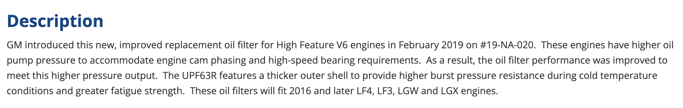

Yeah, couple interesting takeaways worth considering. The thicker body is where the weight comes from, hence the heft.

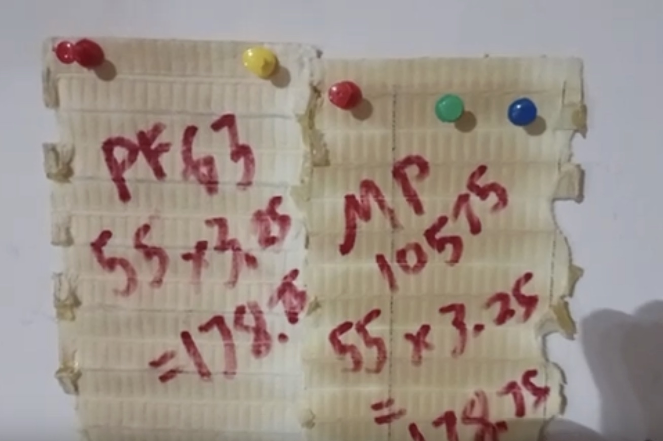

More importantly for me though, the standard PF63, at least the part number in the manual, actually has MORE filtering surface area than the UPF63R and a nearly identical particle filtration rating, ~30 microns.
UPF63R (per your linked vid) - 45.5" x 2.75" = 121.125 sq in.
PF63 (part# 12707246) - 55" x 2.75" = 151.25 sq in.
These numbers came from a vid on the PF63 but the guy measured the entire width of the filter media @ 3.25" and in the UPF vid the guy measured between the endcaps which IMO is more accurate so I knocked .5" off the measured width of the PF63 for apples/apples.
Aside from the heavier body and higher bypass ratio on the UPF, the only other difference I can see is the thicker rubber base gasket. The filter media is also different but has the same micron rating as the media on the standard PF63 so no clear indication one is better. So clearly this filter is meant for higher pressure operations but whether or not that actually matters when the standard PF63 is good to a rated burst pressure of 253.8psi is for you to decide.
More importantly is whether it is actually a better a filter and not just a heavier duty filter and I dont really see the evidence for that.
So, nothing wrong with the PF63 but the UPF63R has been considered an upgrade for the LF4 engine for a while now. The folks from Tapout Tuning here on the forum recommend this filter and use it in all their builds. I have tried both filters and I just like the more beefed up UPF63R. I like the thicker gasket.
Yeah thats all true and prior to the re-release of the PF-63 in 2020, these were legit benefits over the older PF-63E. But the current (well, technically recently replaced) PF-63 was released in 2020, after the UPF-63R, and is now nearly the same as UPF, including the higher pressures.
For example, the PF-63 is rated to a burst pressure of 253.8psi and the UPF-63R?
“burst-strength that is five times greater than normal engine oil operating pressures (as long as the normal engine oil operating pressure is not greater than 51psi)”
5 x 51psi = 255psi
And as already mentioned, the PF-63 has more filter surface area. So maybe a few years ago the UPF filter offered significant advantages over the spec filter but I dont see that being the case anymore.
Nothing wrong with peace of mind and if it ticks that box for you then keep going with it.
