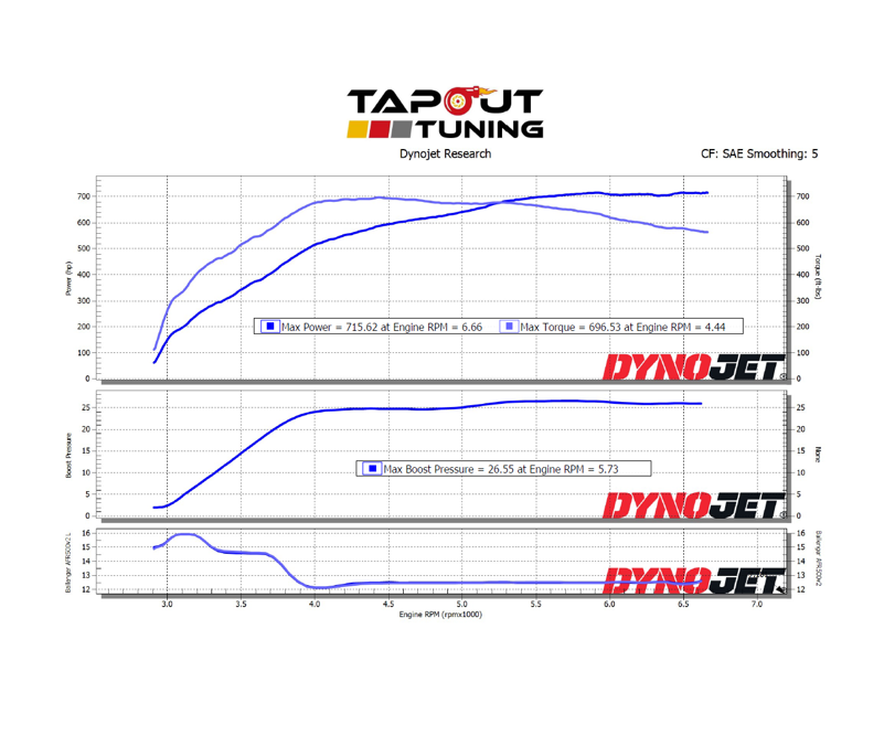

Is that with a ported blower, 103mm TB and stock pulley? They were making 690-700whp pre-tune so I'm curious if the ECU was just that good at adapting that they were only able to add 15whp with the tune
We'll have to wait and see, but it looks like that's scott's CT4 with the new ECU tune. No insight on what aftermarket upgrades are installed as well.
Good catch - I didn't hover over the image to see the name of the file, haha

The before and after dyno sheets are on different dynoes so it is very apples to oranges
The cars mid range feels like a 50 shot of nitrous compared to before and after.
