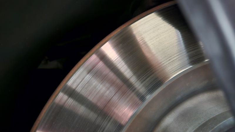

Went to Carolina Motorsports Park in Kershaw, SC last month. For those not familiar with the track, it's a 14-turn road course with almost no elevation change & super hard on the brakes -- especially since a repave 2 yrs ago. My car did great & I had lots of fun. But, I scored up the (steel) brake rotos something awful. One other thing about CMP, the paddock area is mostly sand so it's very easy to pick up stuff between the brake pads & rotors. The pads still have life in them but I got a new set of DBA XP Performance Brake Pads from KNS Brakes on Closeout.
This is the front (right):

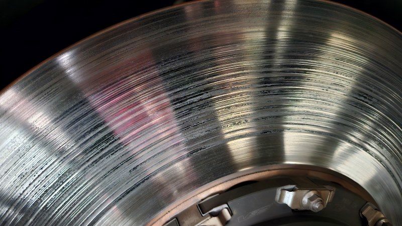

The rear looks much better & almost normal:

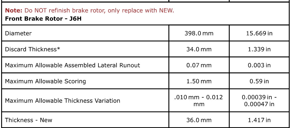

Instead of replacing the fronts, I'm thinking about getting them resurfaced but want to make sure I don't go below the minimum thickness.
Anyone know what the minimum thickness of the steel rotors is? TIA!
From the CT5 Service Manual...

From the CT5 Service Manual...View attachment 22939

The rotors look fine. Just have them turned at any Orileys. Your issue is that you overheated the pads and basically smeared pad material into the rotors.
I had this happen to my RS3 and Fiesta ST that I used to track.
I'd suggest getting a different pad for the track, Hawk DTC60s work amazing.
