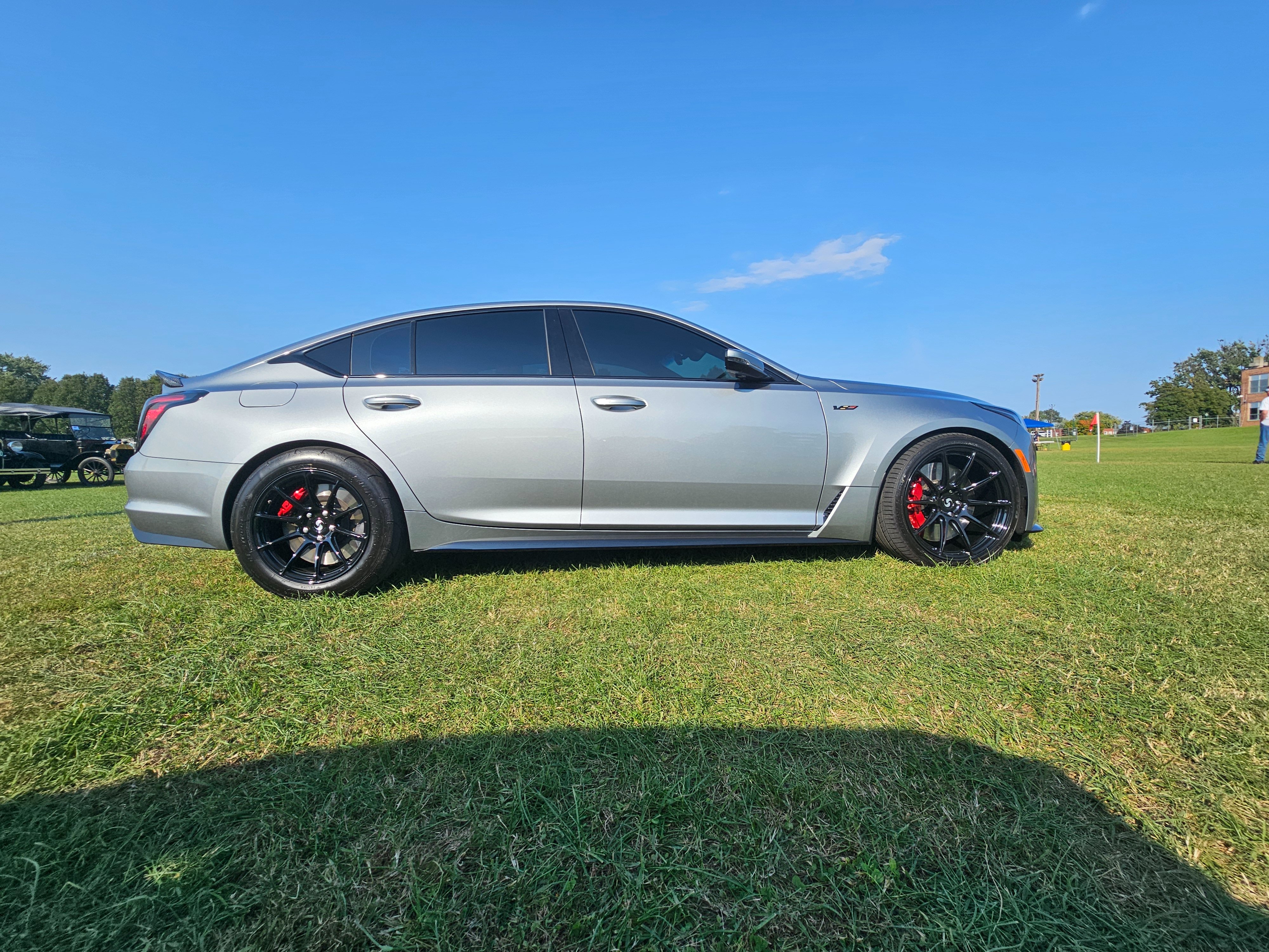

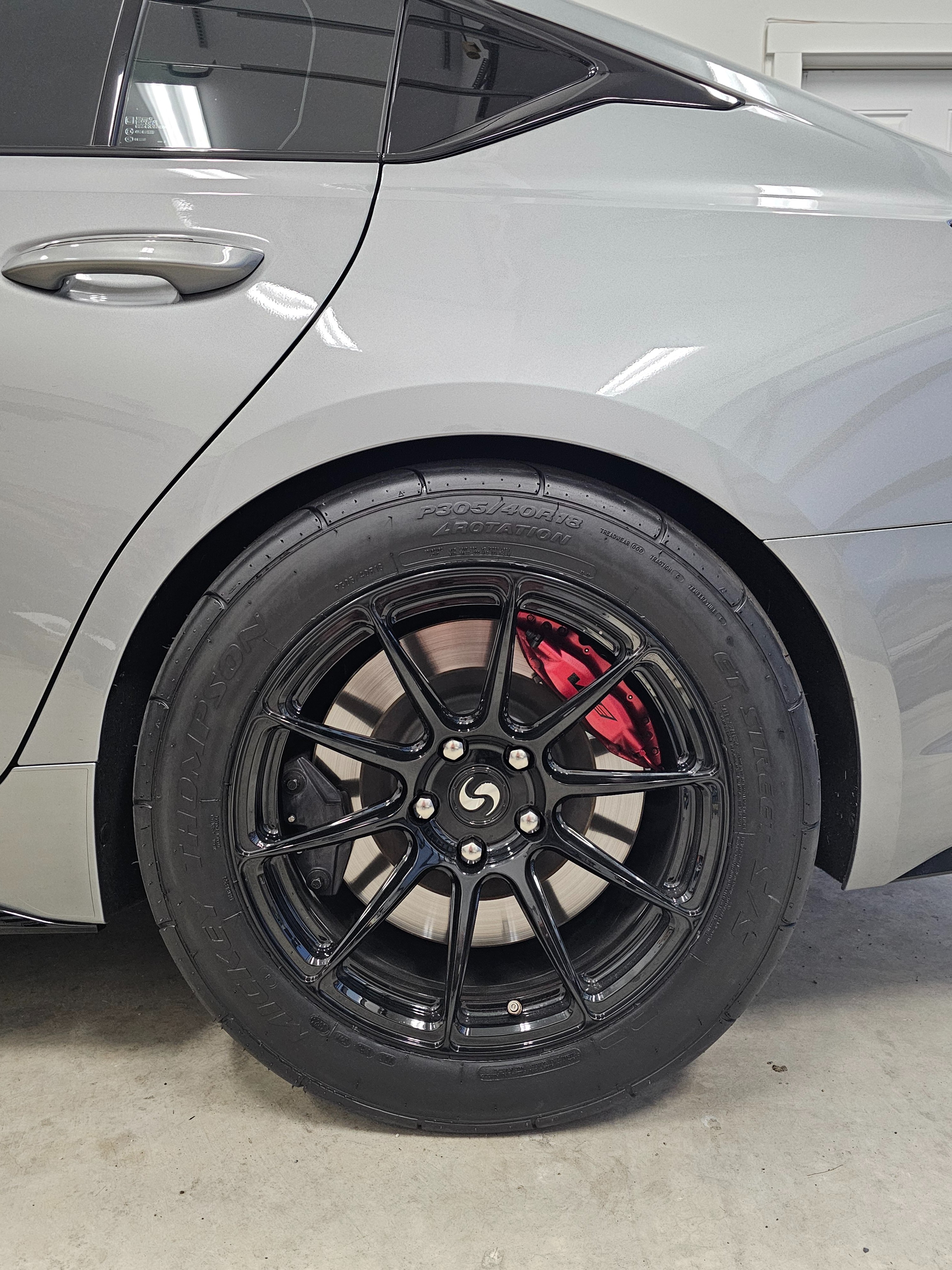

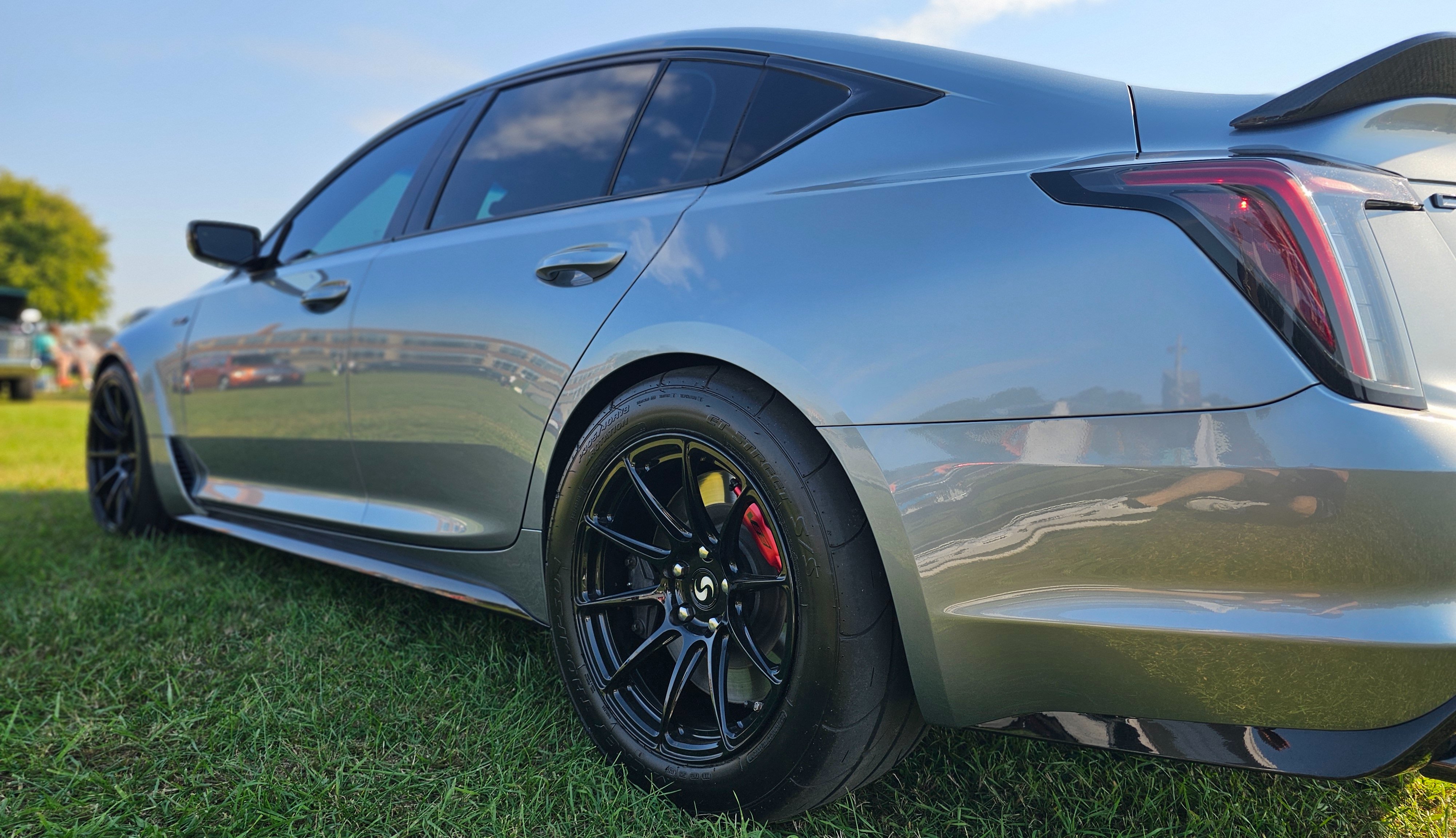

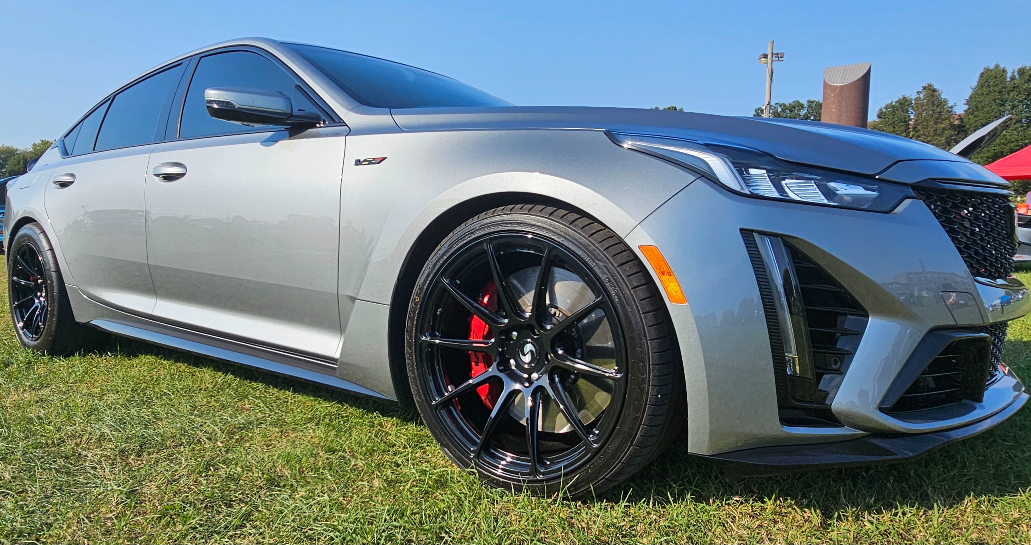

Here you go. 20s in the front 18s in the rear with MT.
It's tucked super tight on the nose @Champale ..... I'm with you on the info share request to @flipray if he is willing to share. Thank you!

I've done a ton of wheels with custom offsets over the years and have some PTSD from wheels that didn't fit as promised by the wheel manufacturers. Very well known brands. If flipray has found the secret sauce, I might pull the trigger. Those huge rear tires are essentially the same OD as the OE 305s (the 335s are a fraction of an inch taller), which is perfect.
I really need to put my car on my lift and take some measurements one of these days.

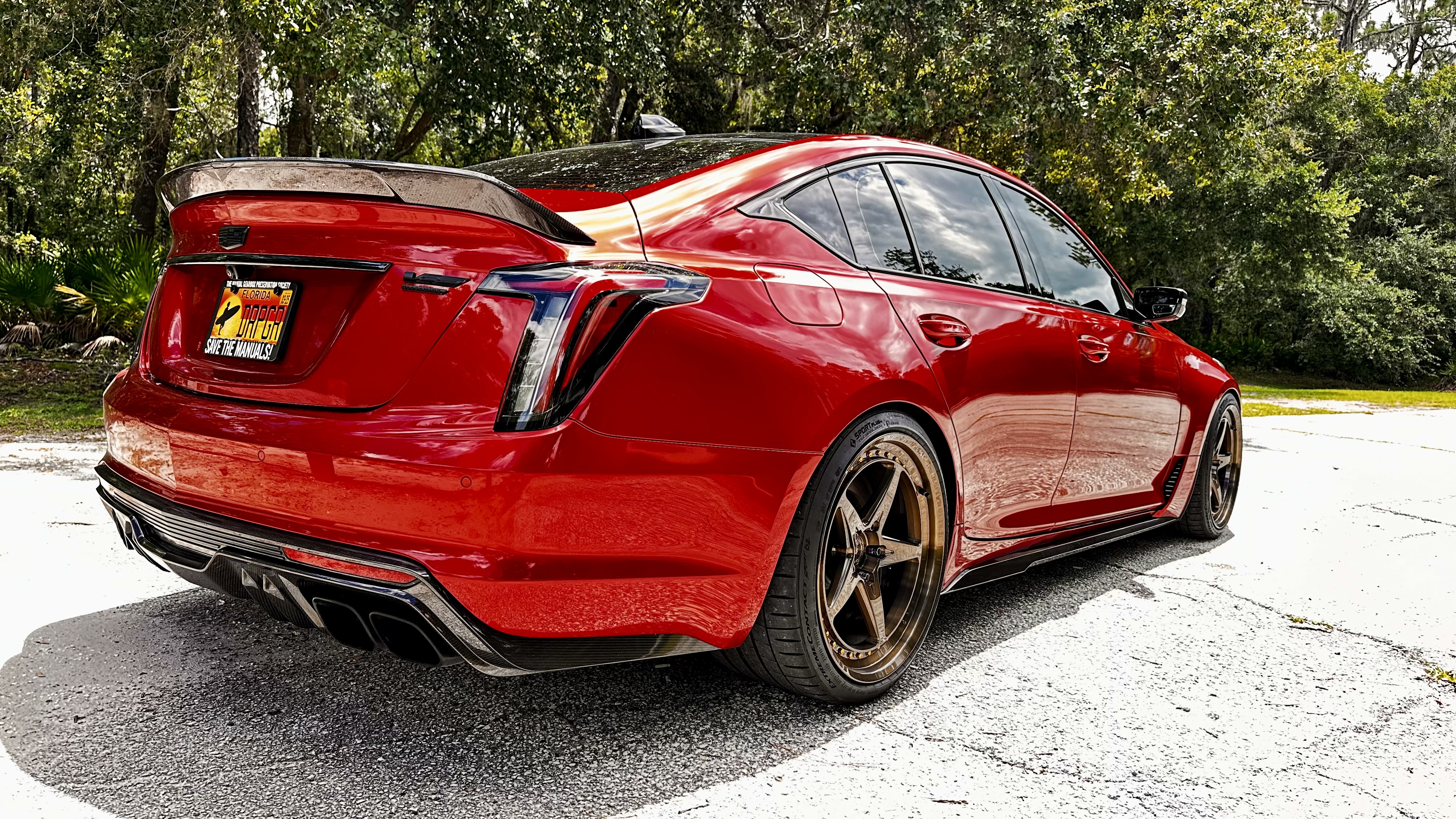

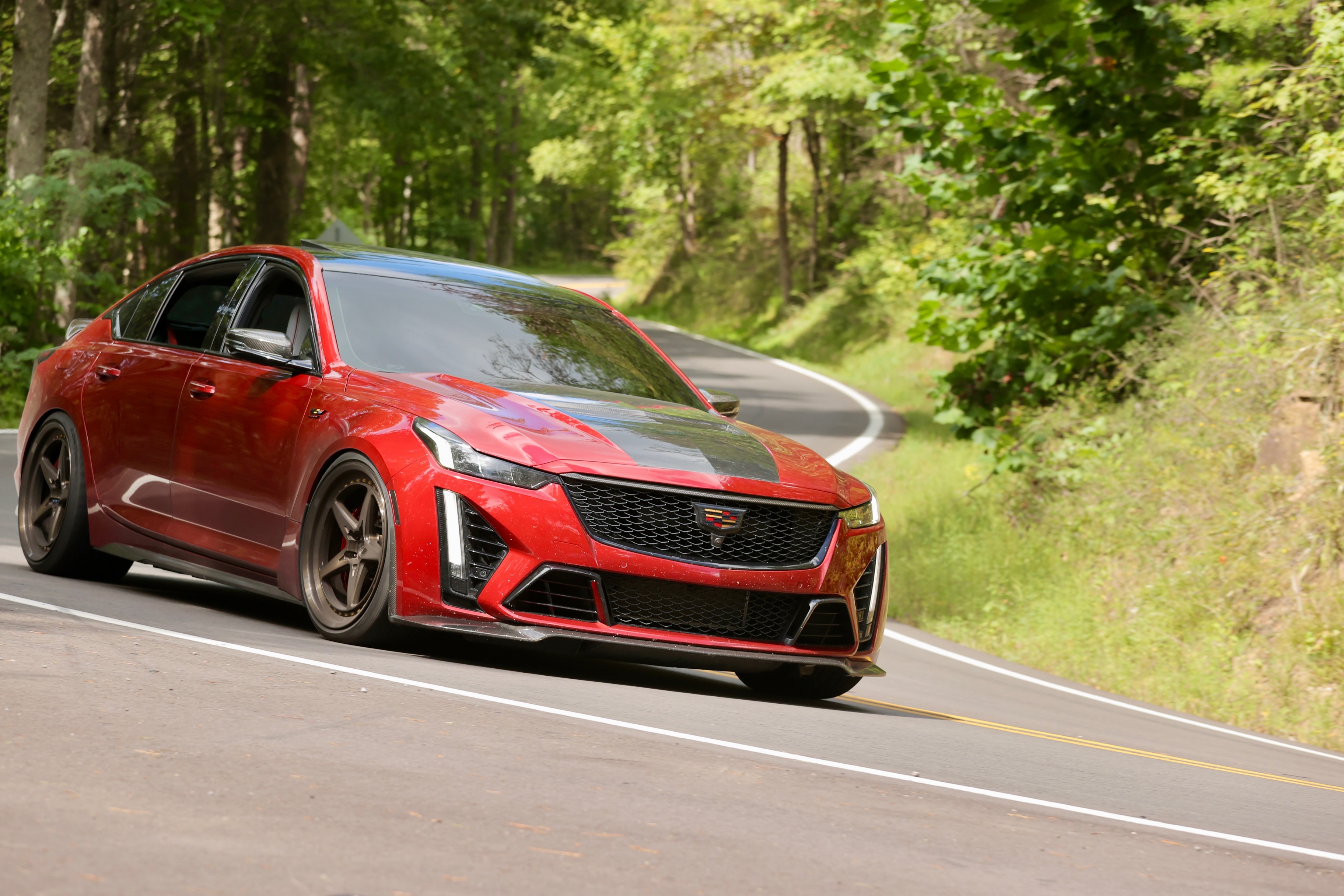

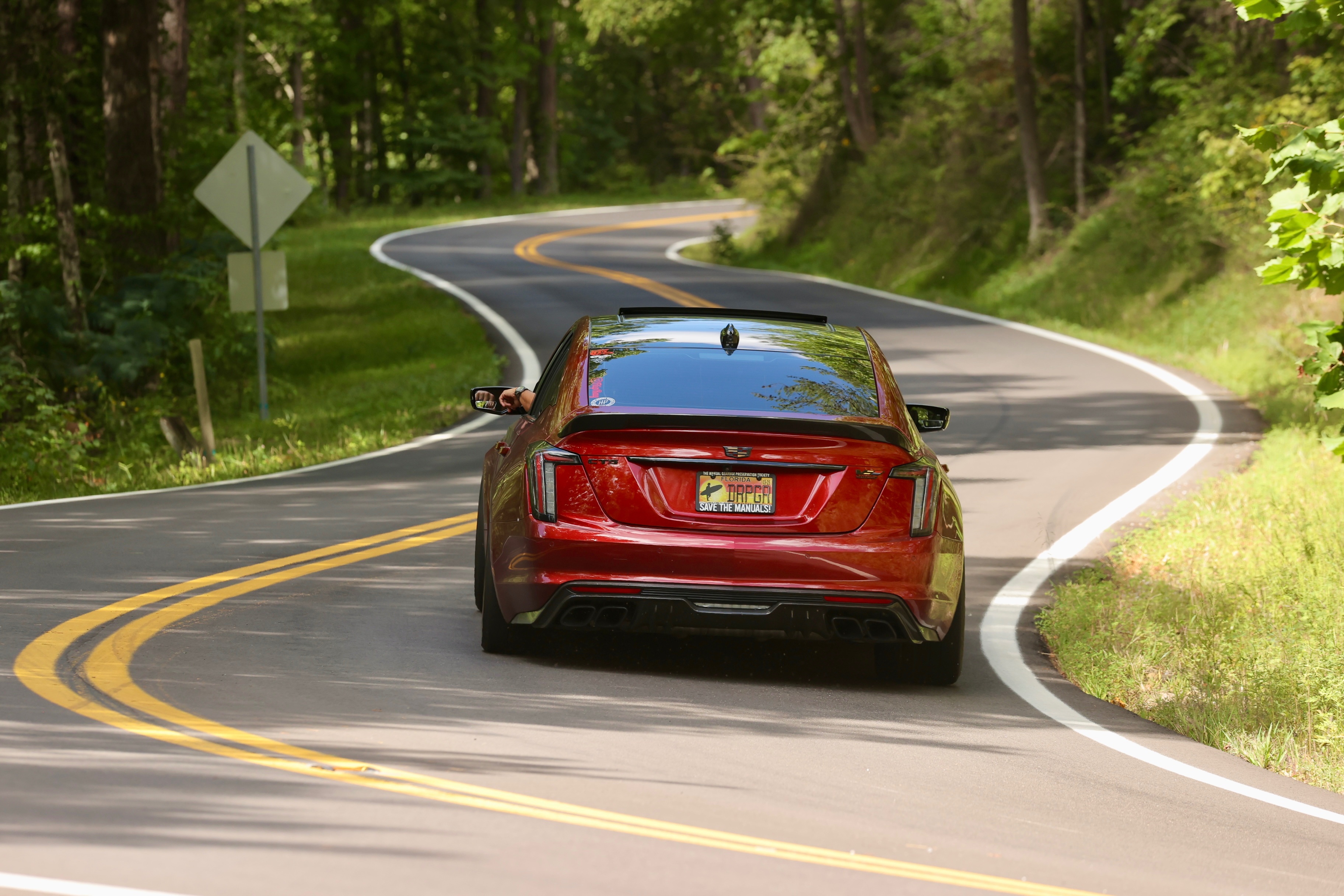

These are 20x10.5 +13 20x12 +50 285/30-20 and 335/25-20 Continental Extreme Contacts2.
PS4 325s actually have more tread than the Continental 335s (12.2" vs. 11.8").
Are you able to share alignment specs? I saw you mentioned slight rub up front - do you think at stock ride height and with more camber that issue would go away?
I gotta find my sheet but definitely something that can be fixed with more camber. The upper perch hole on the car is slotted and thats how you adjust camber. When I did my springs, with the anticipation of the wheels, I pushed the upper as much as I could to get more distance between the top of the wheel and the strut. Its unneeded once I saw how much more space I got once the wheels were mounted.
I'm trying a 295/20 in the front with springs. Soon.
Its supertucked just because the picture was taken during a turn. Its not that bad really.
This, I went with the ECS2 with that in mind since I wasnt 100% of space. Seeing how much space I got, I'll probably go back to 325 PS4s when Im done with these ECS2s. I think im getting there with atleast 15K miles on them by now.
