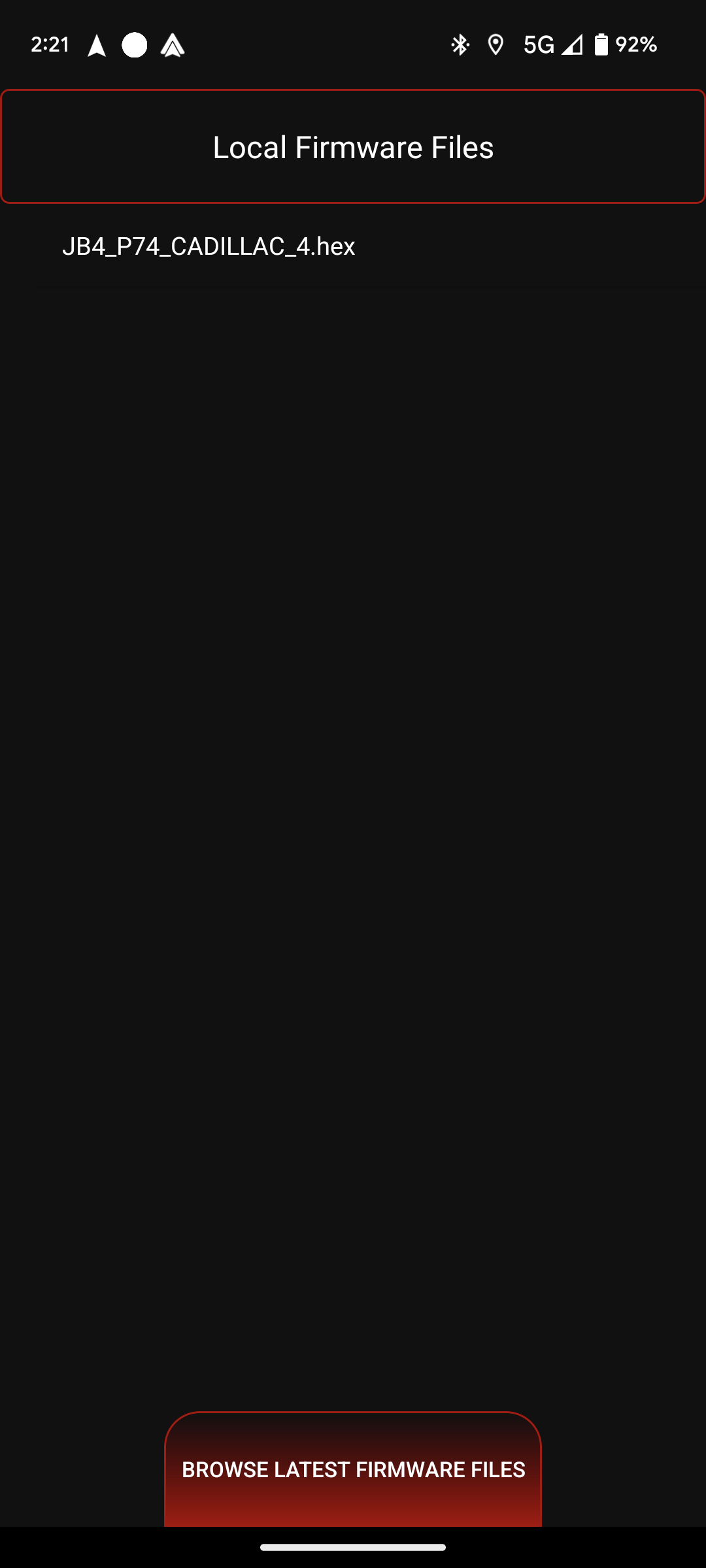

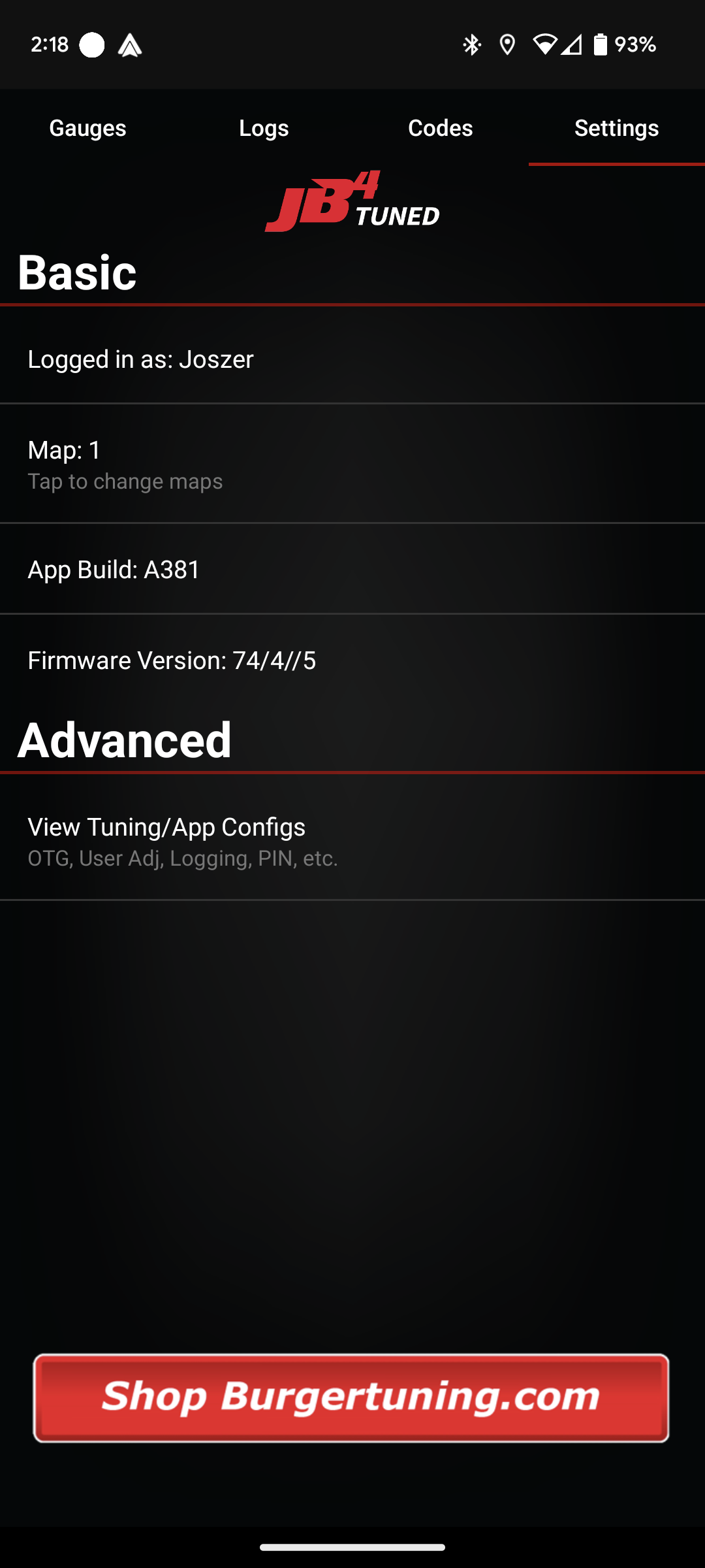

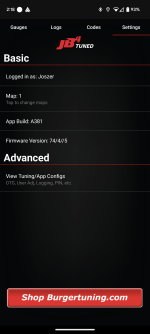

On my app it says that I have
74/4//5 installed.
When browsing for new updated versions there's a Stable, Beta, and Alpha listed.
The files are named:
JB4_P74_Cadillac_4.hex - Stable
JB4_P74_Cadillac_5.hex - Beta
JB4_P74_Cadillac_6.hex - Alpha.
I don't want to overwrite what's already flashed on the JB4 from you guys just Incase you have your own firmware that you developed.

Sorry, but I'm not sure. We always just use whatever is loaded in the modules when we receive them.
I have tried the 4, 5 versions with no mph changes at the track, same day. Also tried map 3 with about a 25% ethanol blend and it was .4 down mph wise in better weather compared to map2 and 93 with boostane. Have not tried version 6 but I did just download it.
