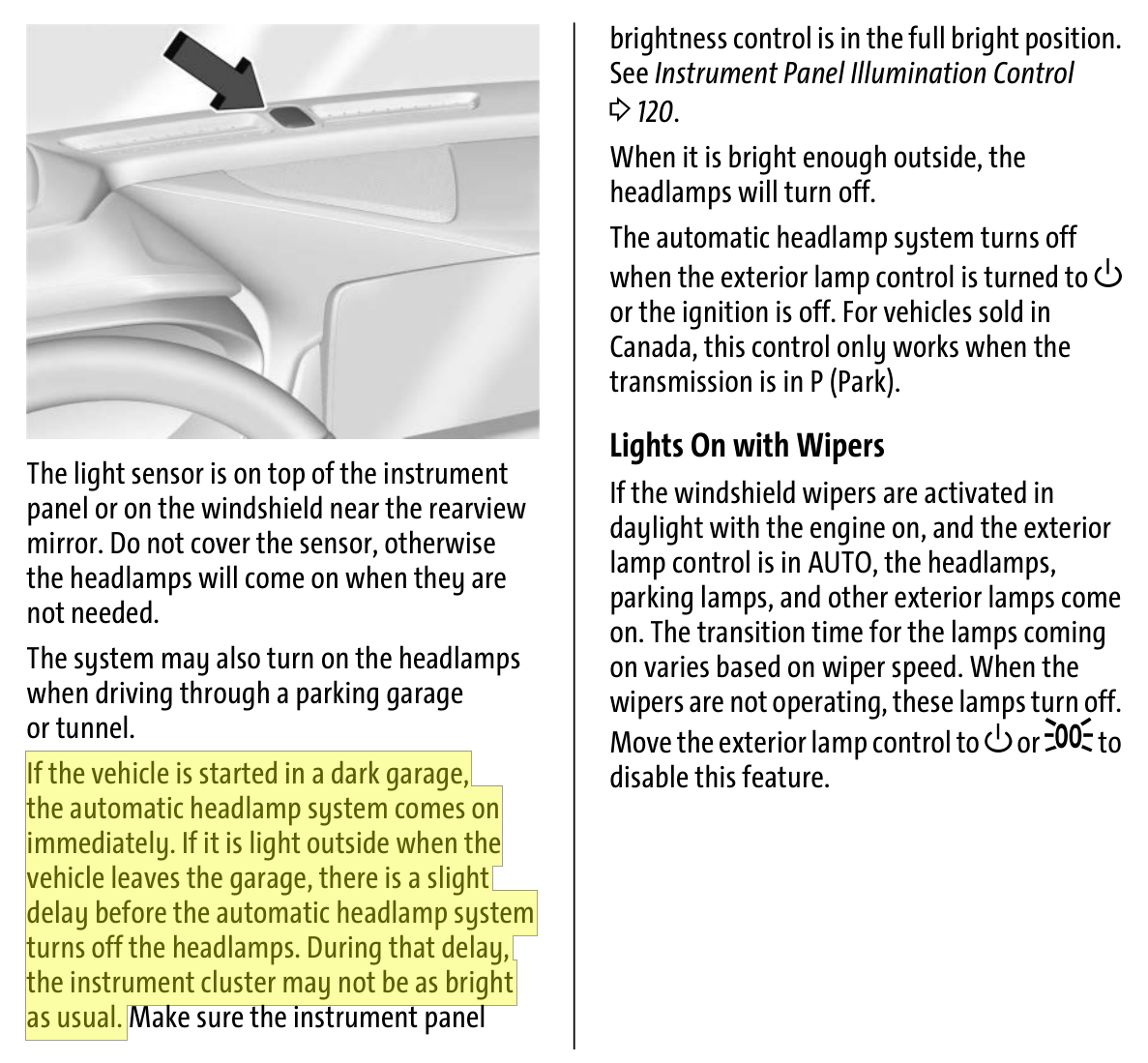

AFAIK, there's only the instrument panel brightness which controls EVERYTHING minus the HUD and the HUD brightness controls. That's it.
You might check if the headlights are in the 'always on' mode because when the lights are on, the instrument panel may not be at full brightness. From page 118 in the Owner's Manual:
My manual shows what you have on P118 on P148, haven't seen anything about the horizontal indicators. Don
Don- Sorry I'm using the 2025 Owner's Manual, not the 2023 version. That would make the page numbers different, my bad. Hopefully the content is similar and possibly helpful.
