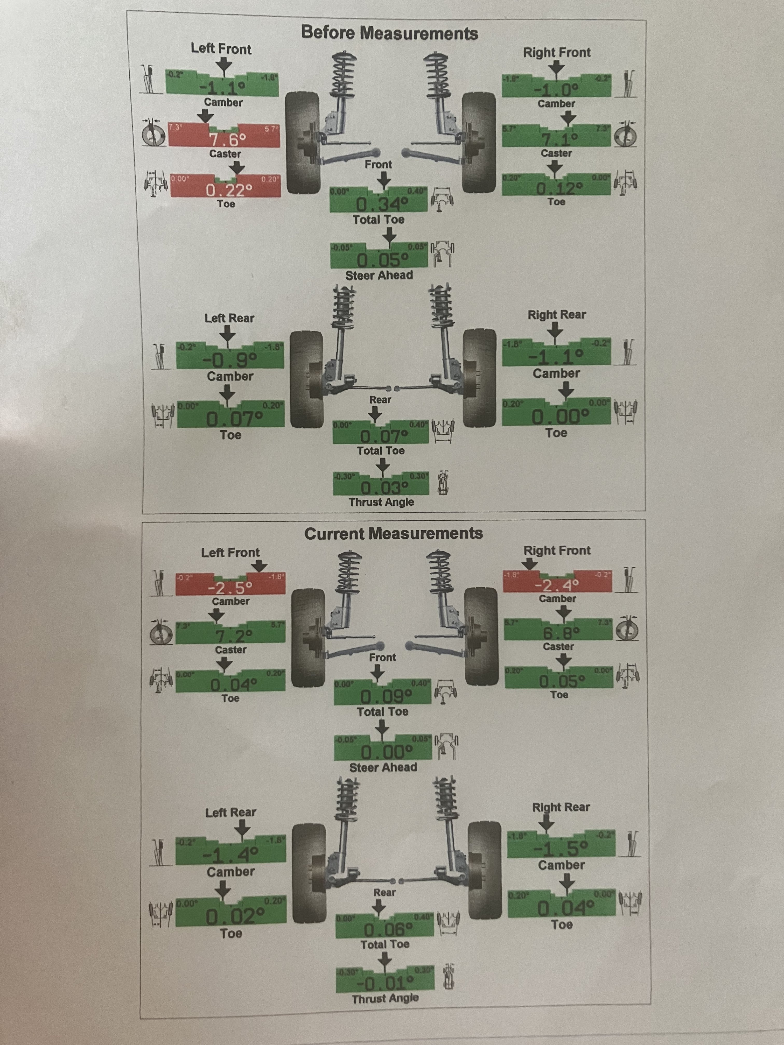

The before is how the car came new at 1k miles. The after is the track alignment. Guess I maybe need to take it back to see if it got way out of alignment or something on the rear bc the toe and camber look ok here.
Yeah your specs look fine. It also assumes the machine was properly calibrated, lift was level, tech knew what they were doing.

So one thing I didn’t mention before is that the tech that aligned it had the steering wheel way off center with the alignment I posted previously. According to the PDR the steering wheel was at a 7 degree right turn input when I was actually driving straight. Brought it back to them to get that fixed and to recheck the rear as well.
Below are the new before (which is how I brought it back to them) and new after. It looks like between 1k (when they first aligned it) and 2.5k miles the rear toe went from .02 left .04 right (.06 total) to -.09 left & -.04 right (-.13 total). They also admitted they didn’t put in new torque to yield bolts when they did it the first time, which is maybe why the rear toe changed. Is that really enough of a difference to cause the type of inner tire wear I’m seeing? I’ve posted a pic of the rear tires & you can see how the inside tread groves are already nearly gone compared to the outside.
