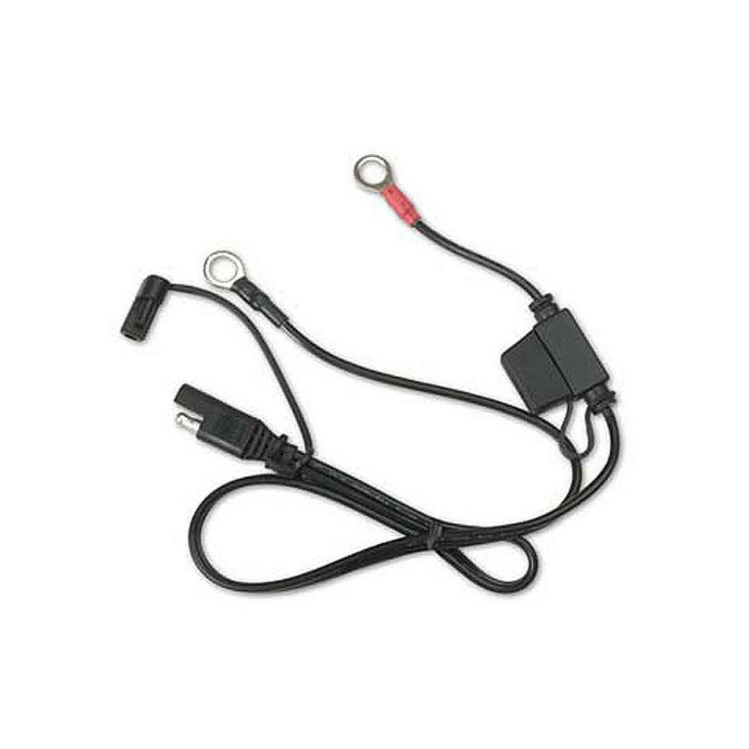

Purchase a Pulsetech XC-400 and the battery leads and install like LF4472. The charger is on sale and no battery tender or other product can replicate the PulseTech frequencies. According to the the lead engineer, PulseTech will completely dissolve the gunk on the plates while the other brands just hit it with pulses, and it falls to the bottom of the battery case. Theres a reason that every branch of the service use the products. As the story goes, a series of about 10 batteries failed on Humvees. The military wasn't happy and once received PulseTech determined that each of the Optimas was between 11 and 13 years old. You can't ask for much more of a torture test. And yes, this military branch was astonished. Its on sale for $69.99 and if you have a bunch of toys, you can get the QuadLink device that allows you to service 4-batteries at a time.
