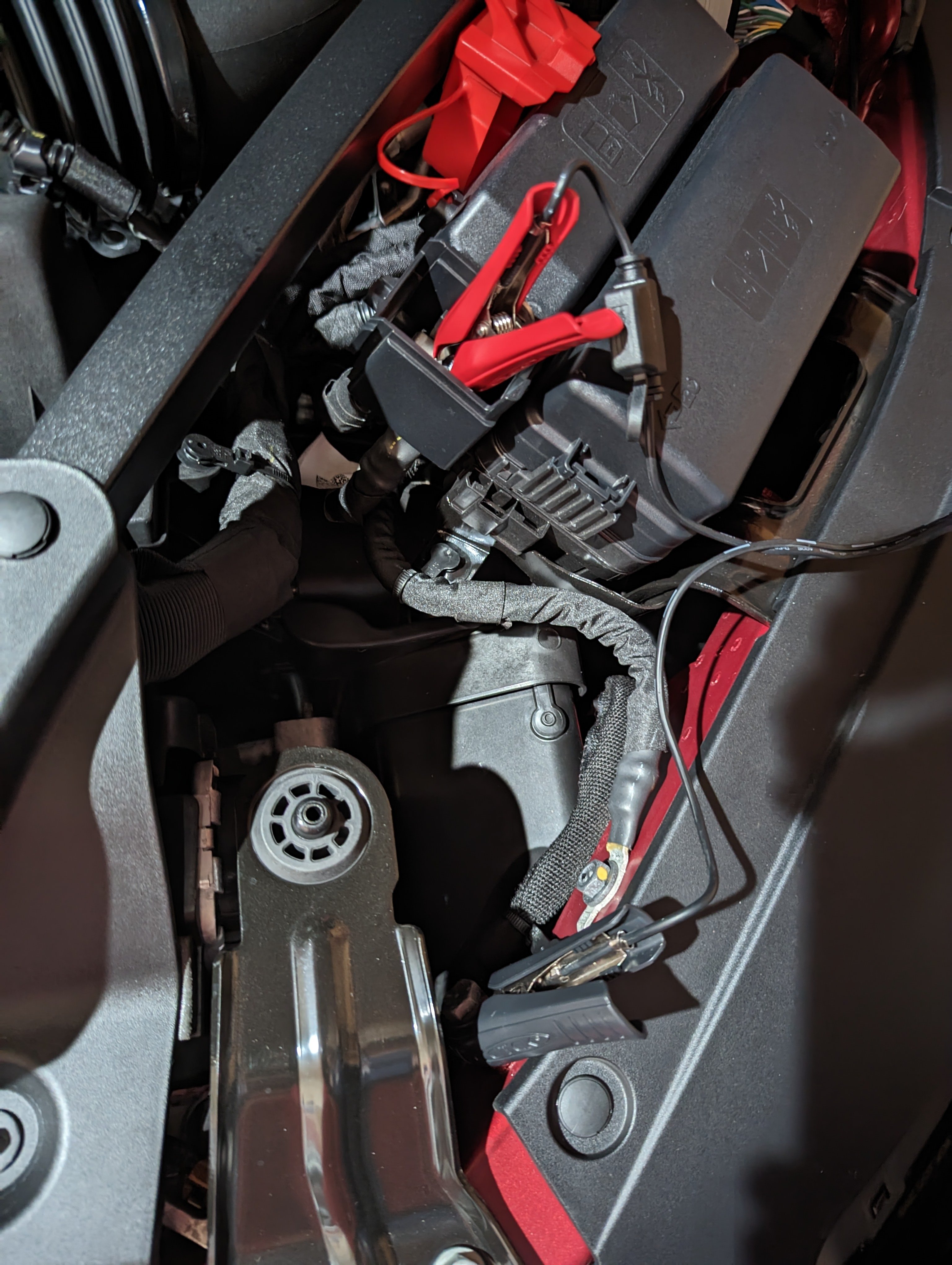

I would like to hook the tender pig tails directly to the battery, but incase that does not happen, where are the terminals under the hood located?
I plan on hooking up a battery tender for the next few months while old man winter is in town.
Left side of the engine bay.
