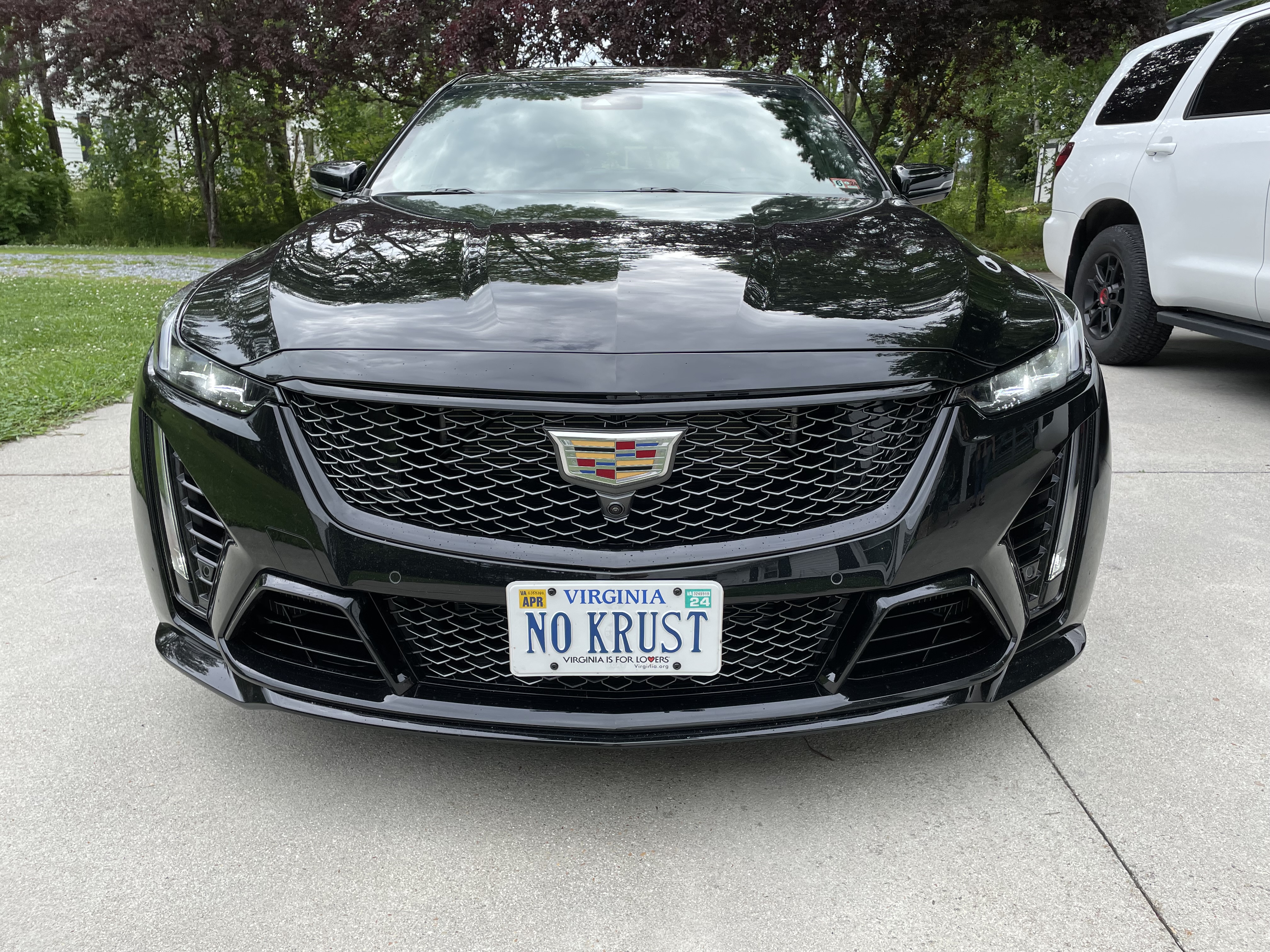

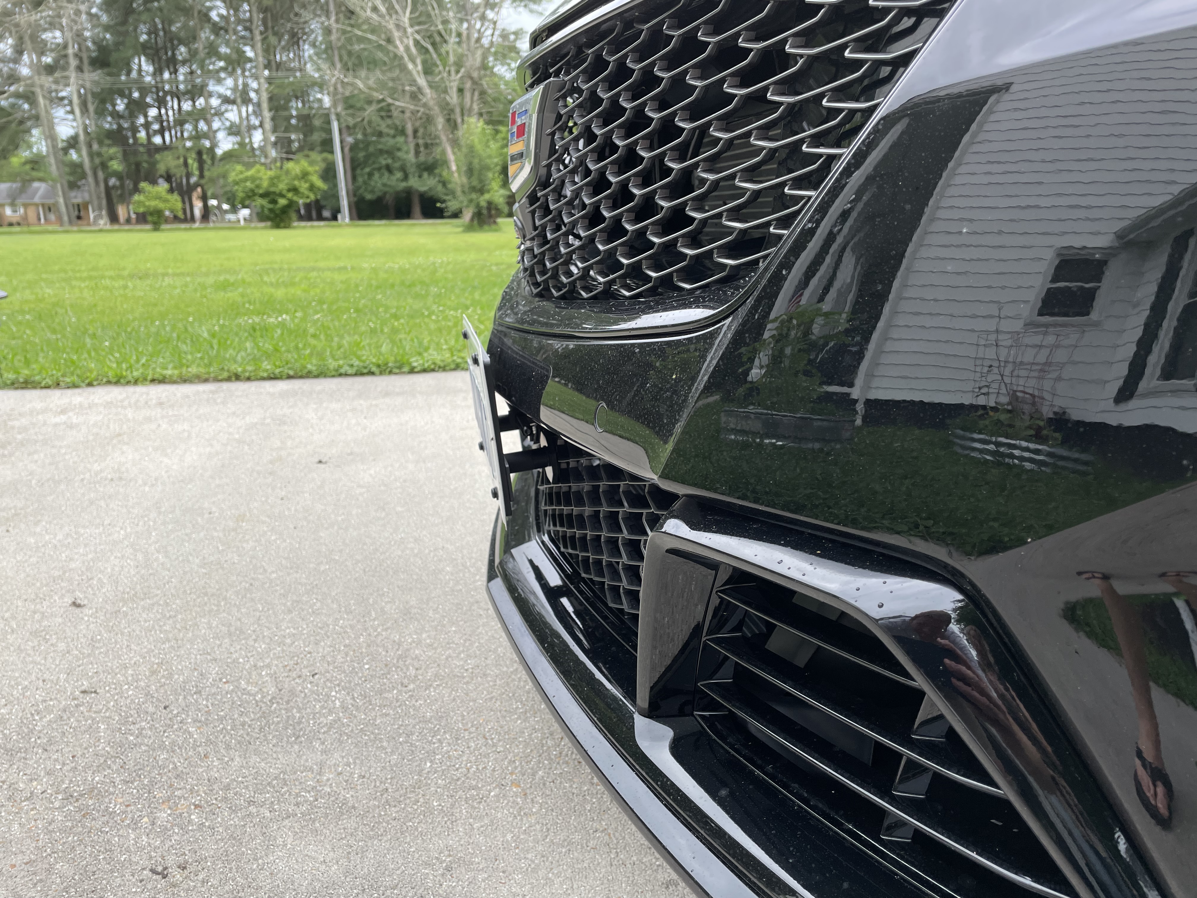

Not sure if it would fit the CT4, but check out Sly Brackets. They make a no drill bracket that just secures to the bottom mesh grille, works perfectly on my C63.
I just installed the Sly mount on my 5BW, really nice piece. OEM-look minus the drilled clunky bracket.

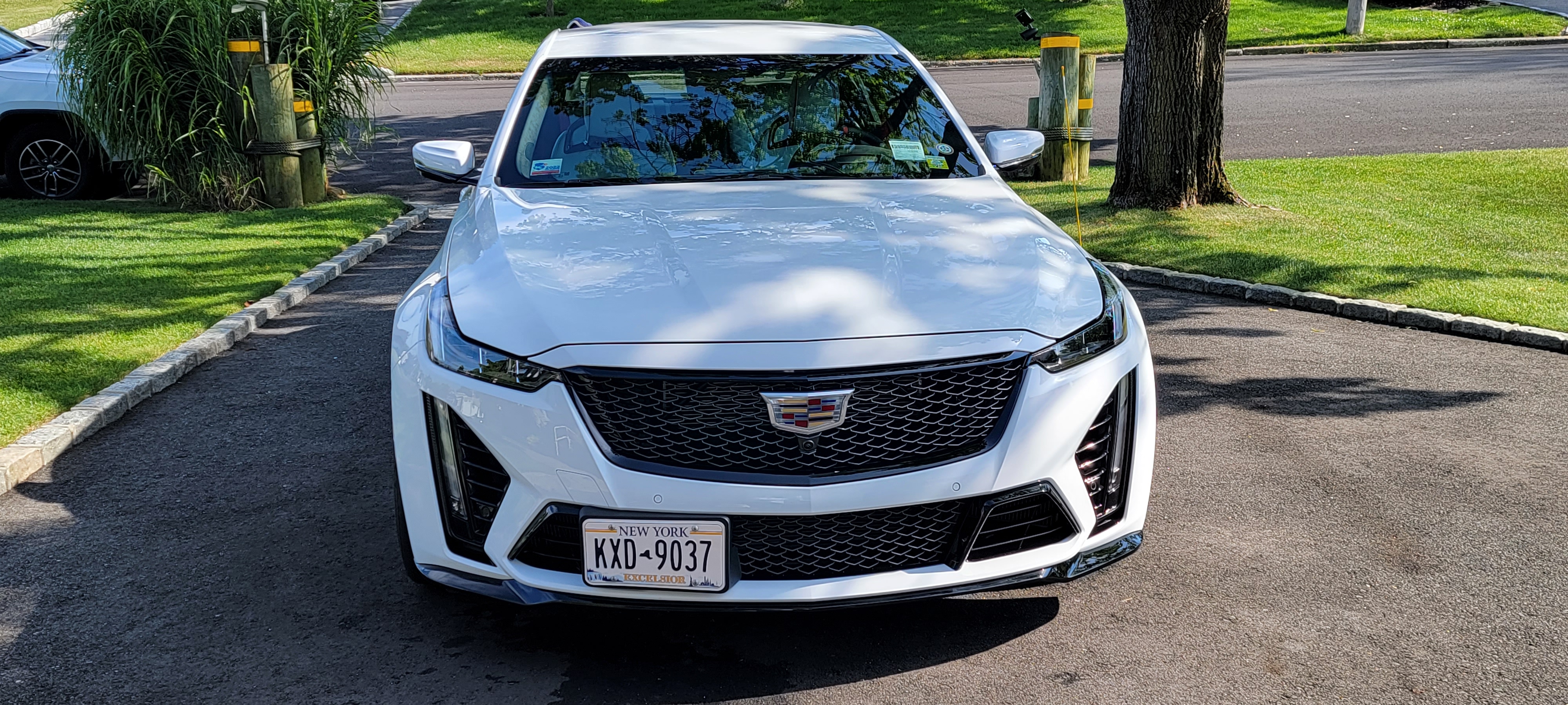

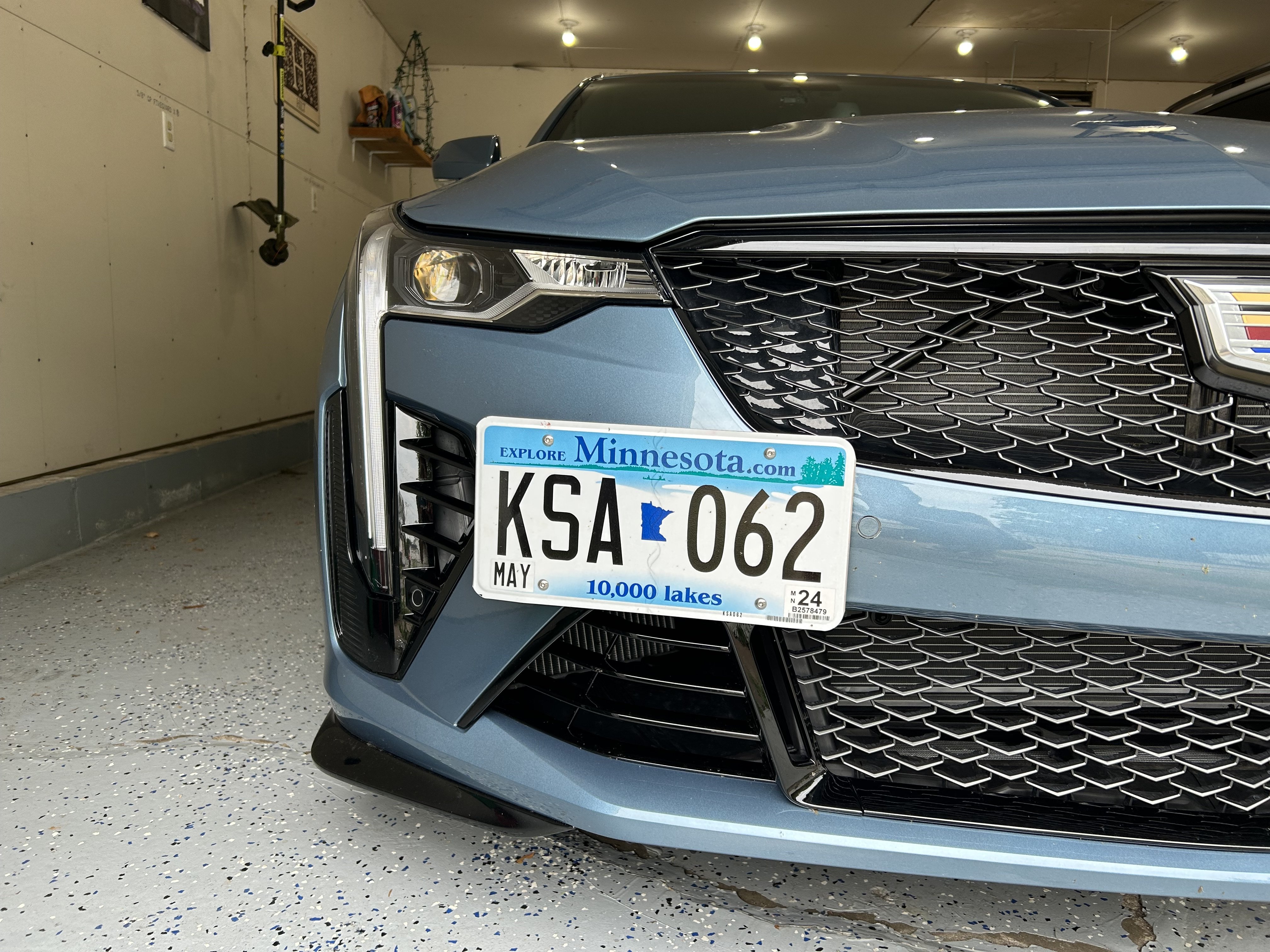

Here’s the one I got after reading it would work on a forum post. I’m not in love with the look, but better than drilling holes. It works good.

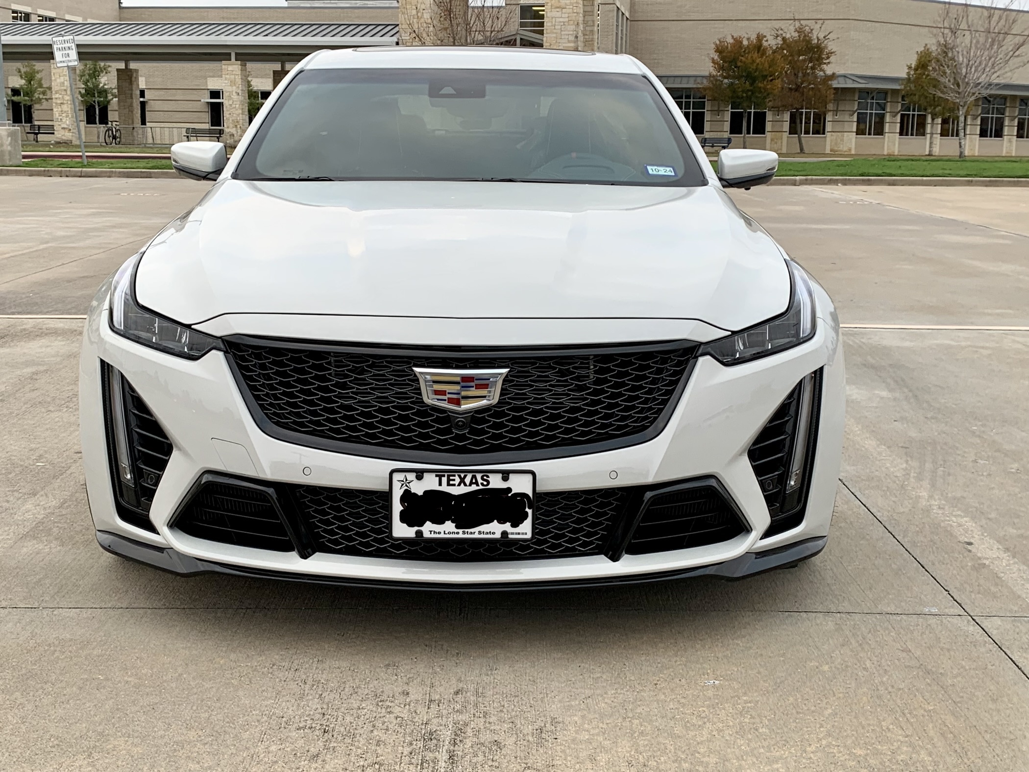

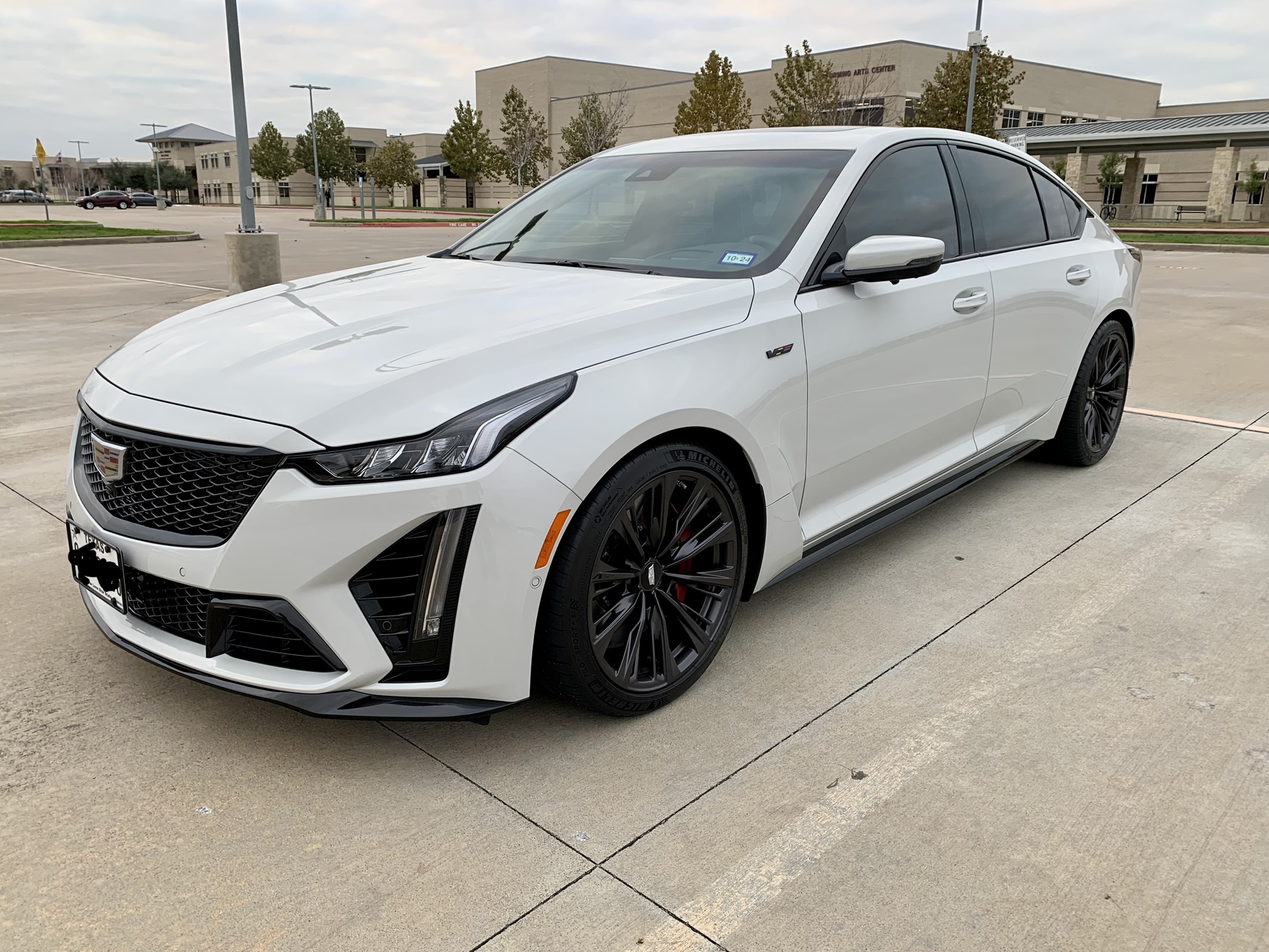

I installed the Sly mount, leveler kit and a thin plate frame on my 5BW and very happy with results. It’s been on the car for almost 7 months and no issues at all. I researched all the other mounts and Sly was as close to factory location, but no holes. The owner was great to deal with and product solid as they come. Looks about factory as can be. 👍
The plate tilts slightly down without the leveler kit and wonder if that would better against laser hits 🤔

Make sure you get the plate close to the middle parking sensor. I originally left about an inch and a half gap between the plate and inside sensor. It was setting off the outside sensor so had to shift it over towards the center.

Is this the eos tow hook one? I did look at sly brakets but I feel it being connected to plastic seem less durable than the tow hook metal ones.
Mid size. Full size seemed like overkill. The mid size bracket works fine.
