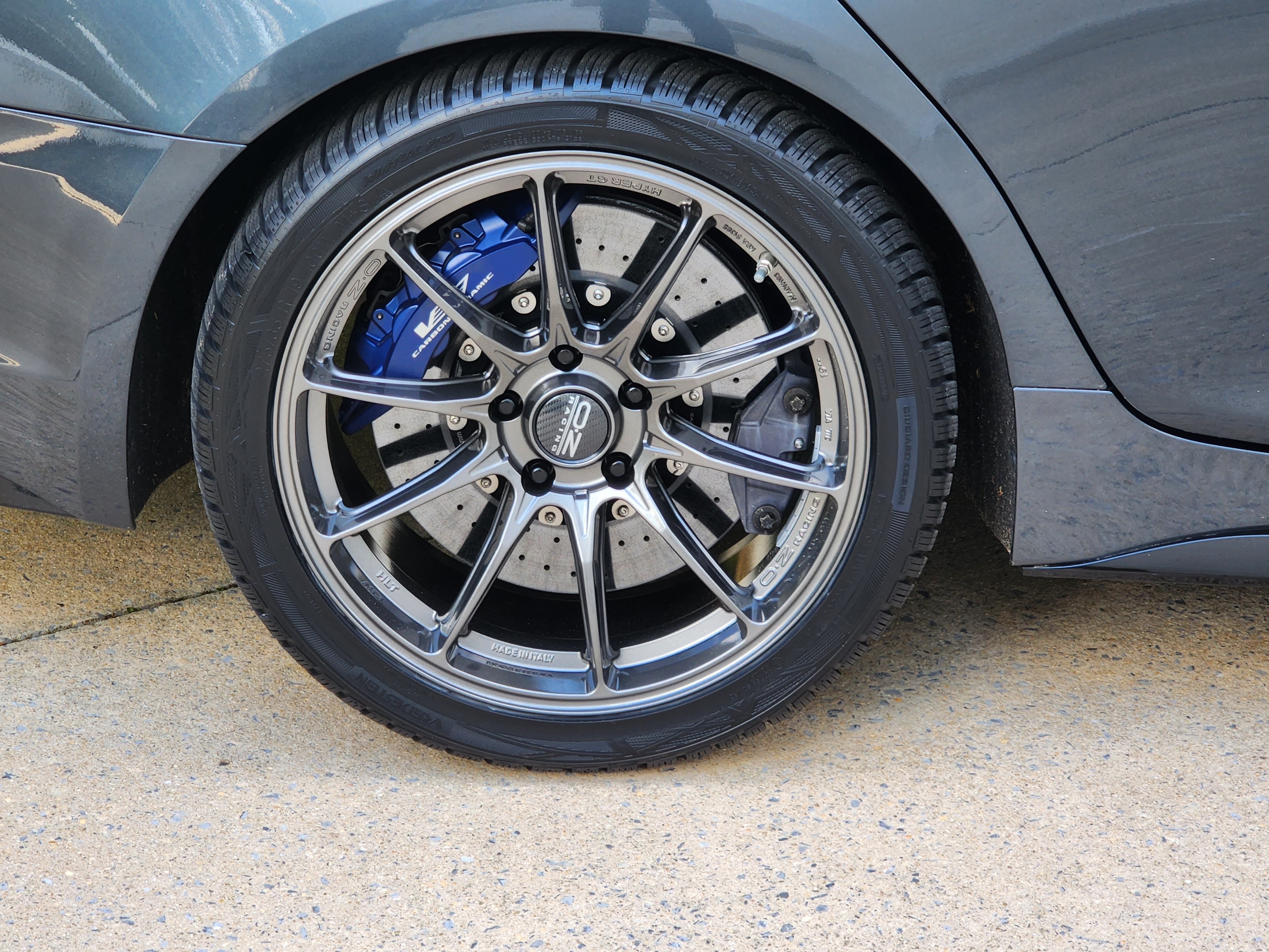

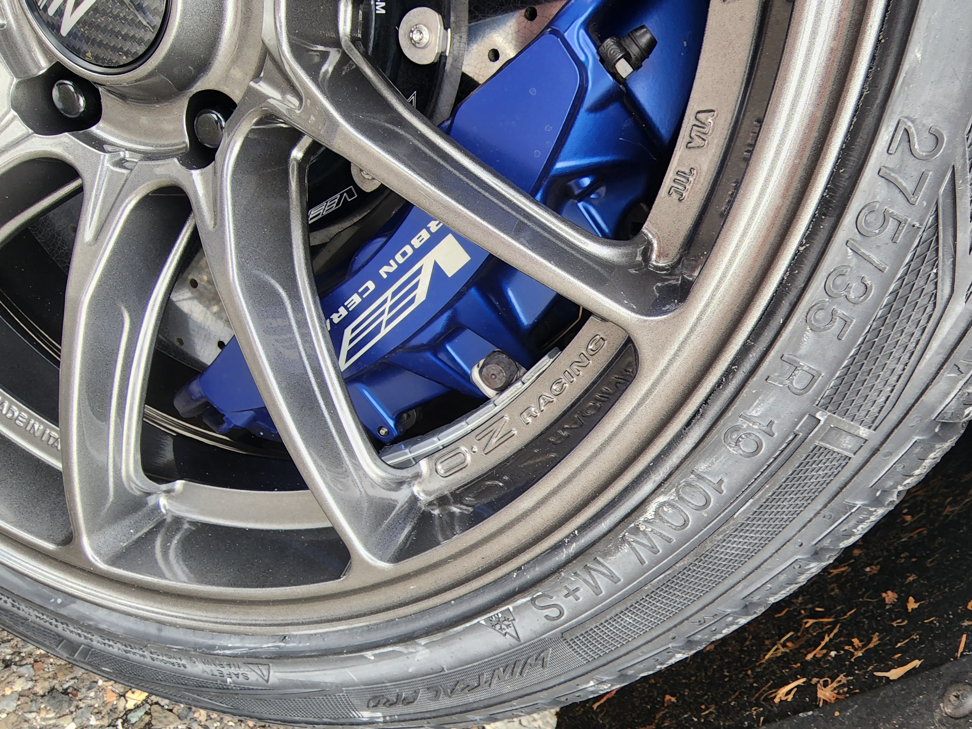

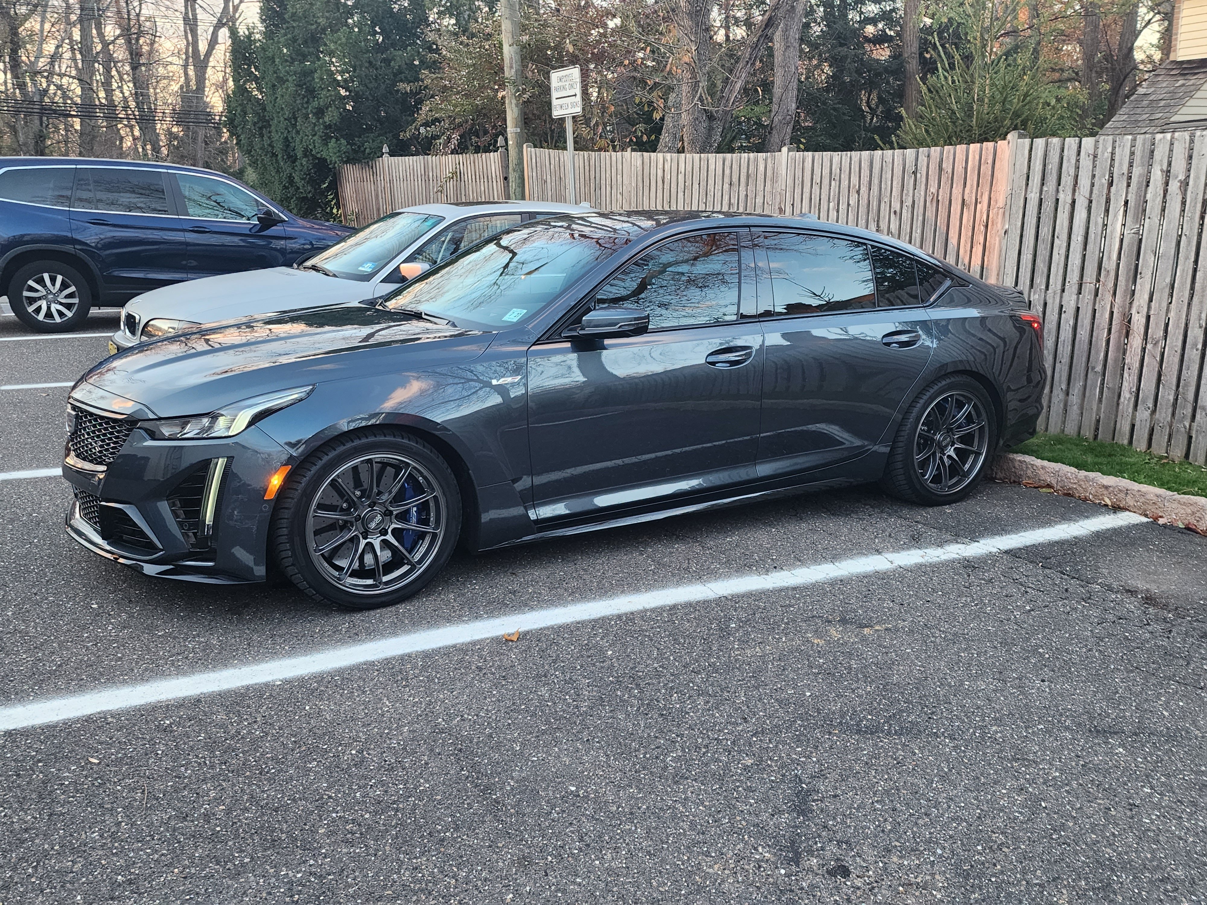

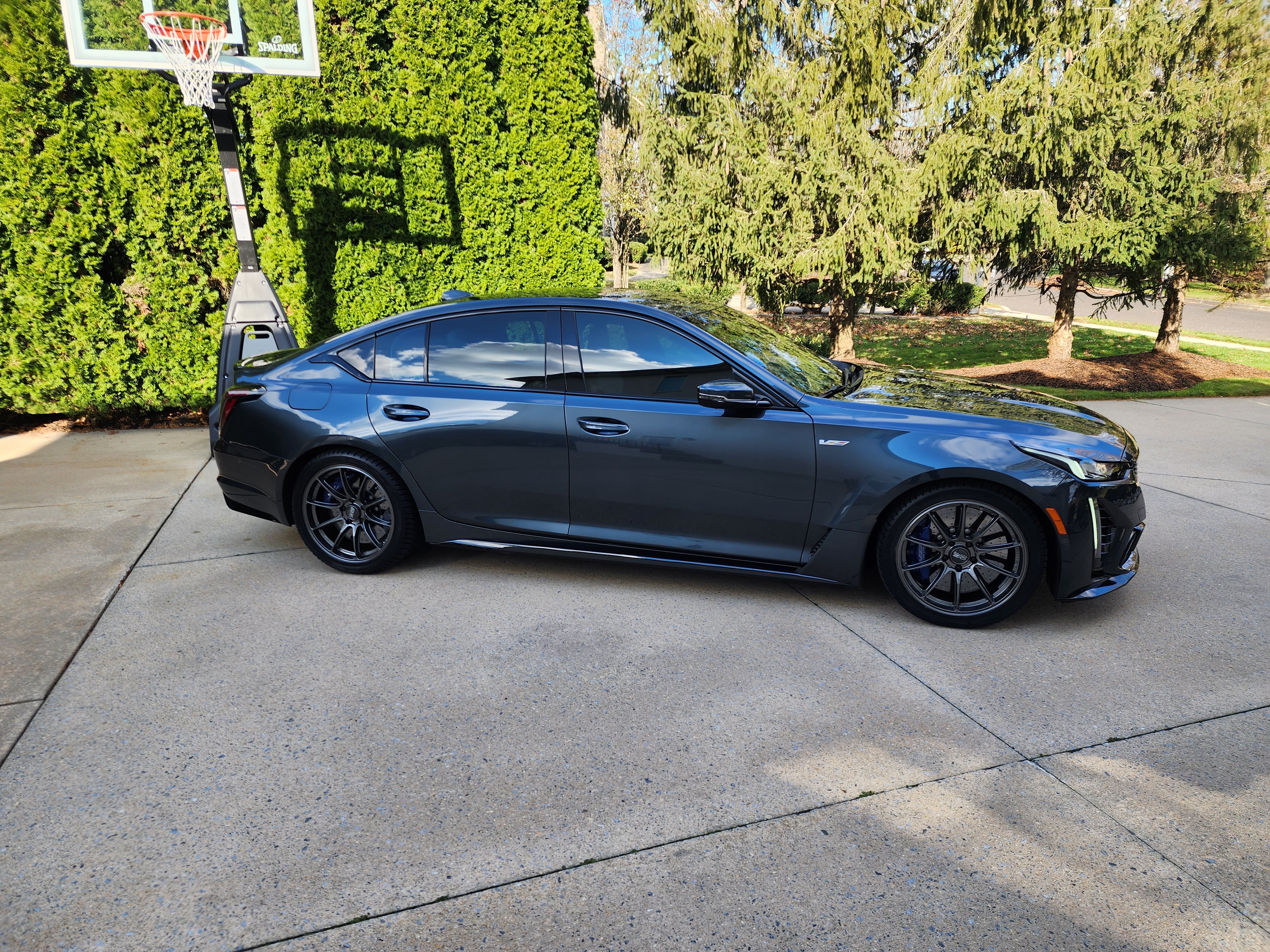

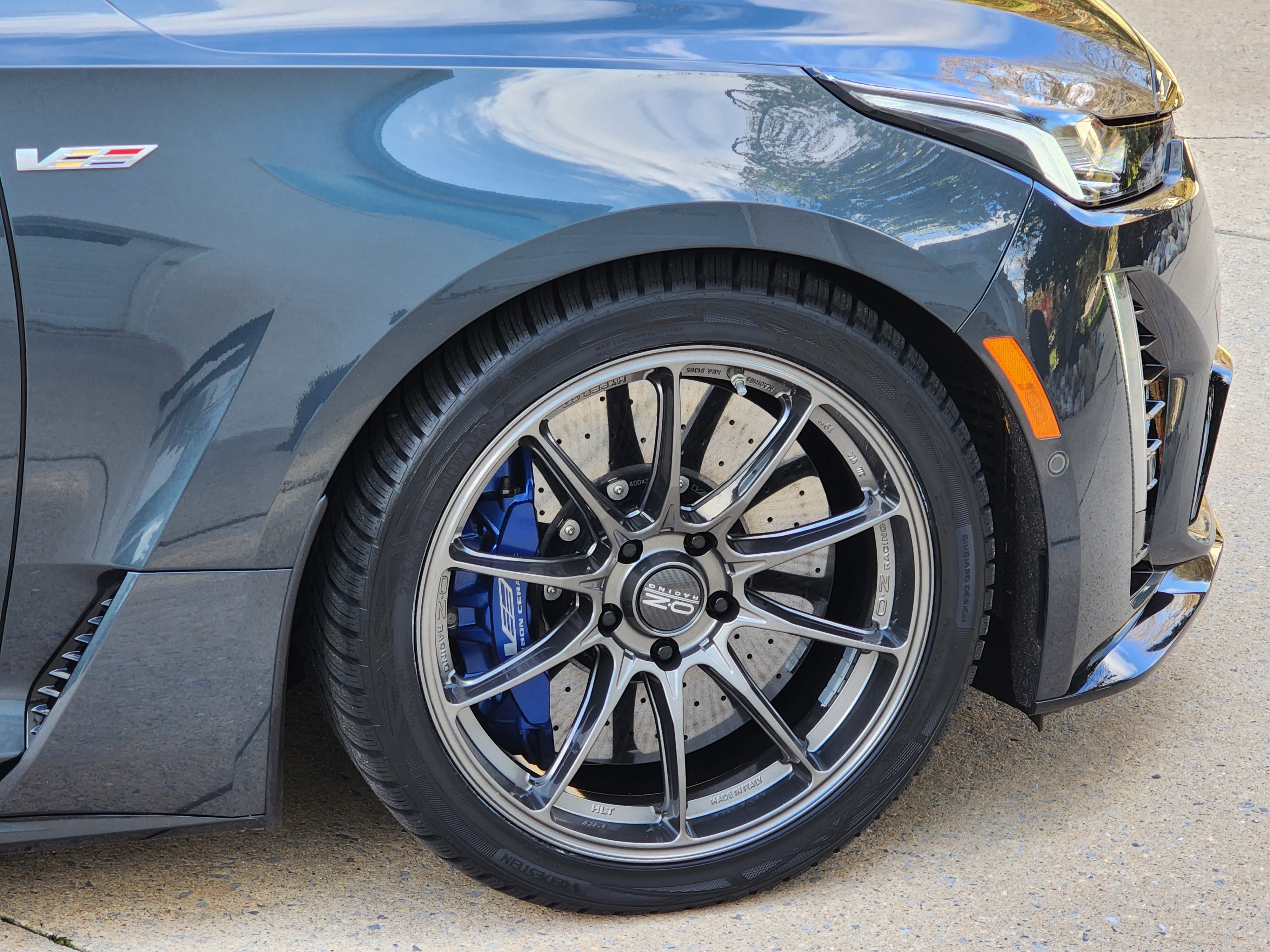

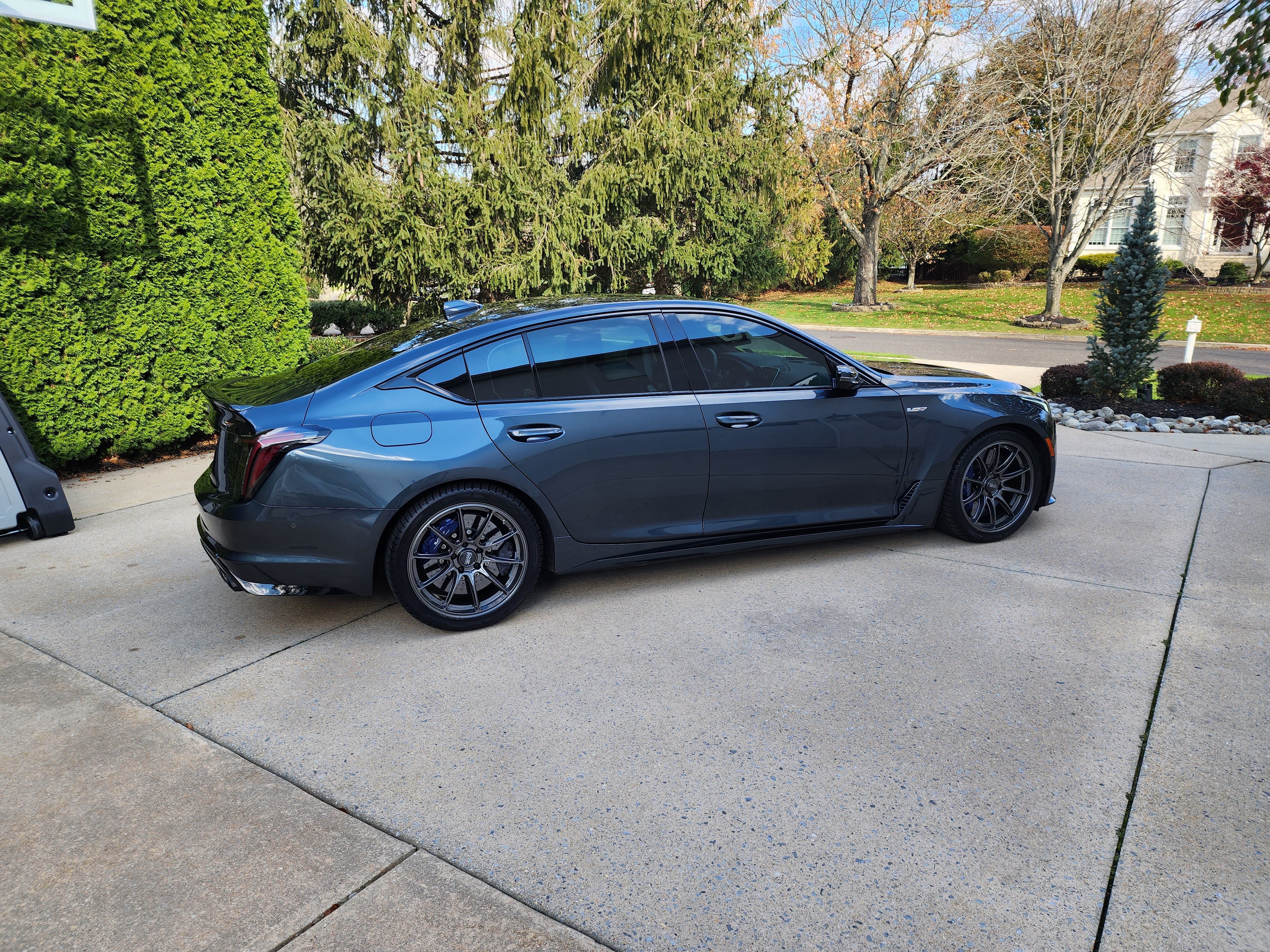

Same square setup as @dribs15 from tire rack. I am in NY (LI) and this is my 3rd winter with this setup....no issues at all. It's pretty tight in the rear (paper thin space between the spokes and the calipers), but I did not want to do spacers. Specs on the wheels are 19 x 9 with 29 mm offset and the tires are 275/35/19s
