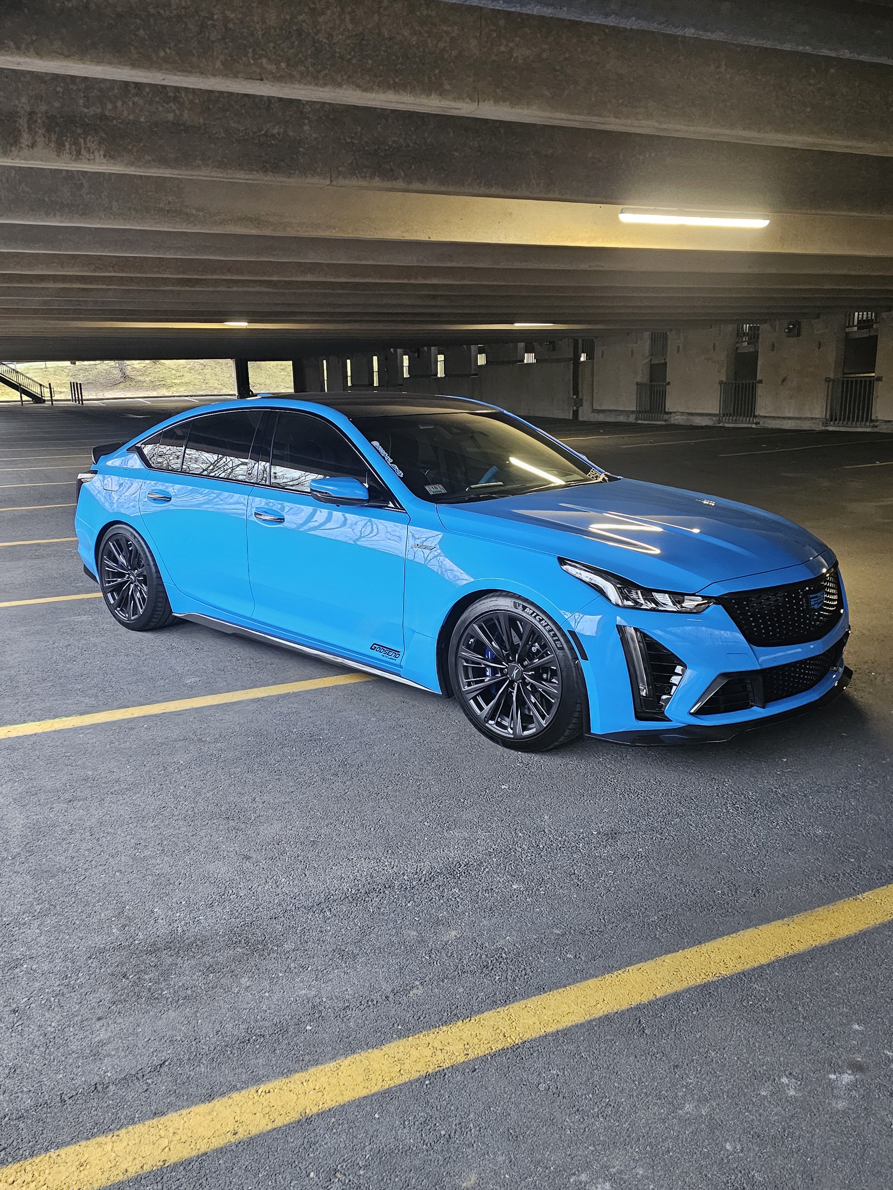

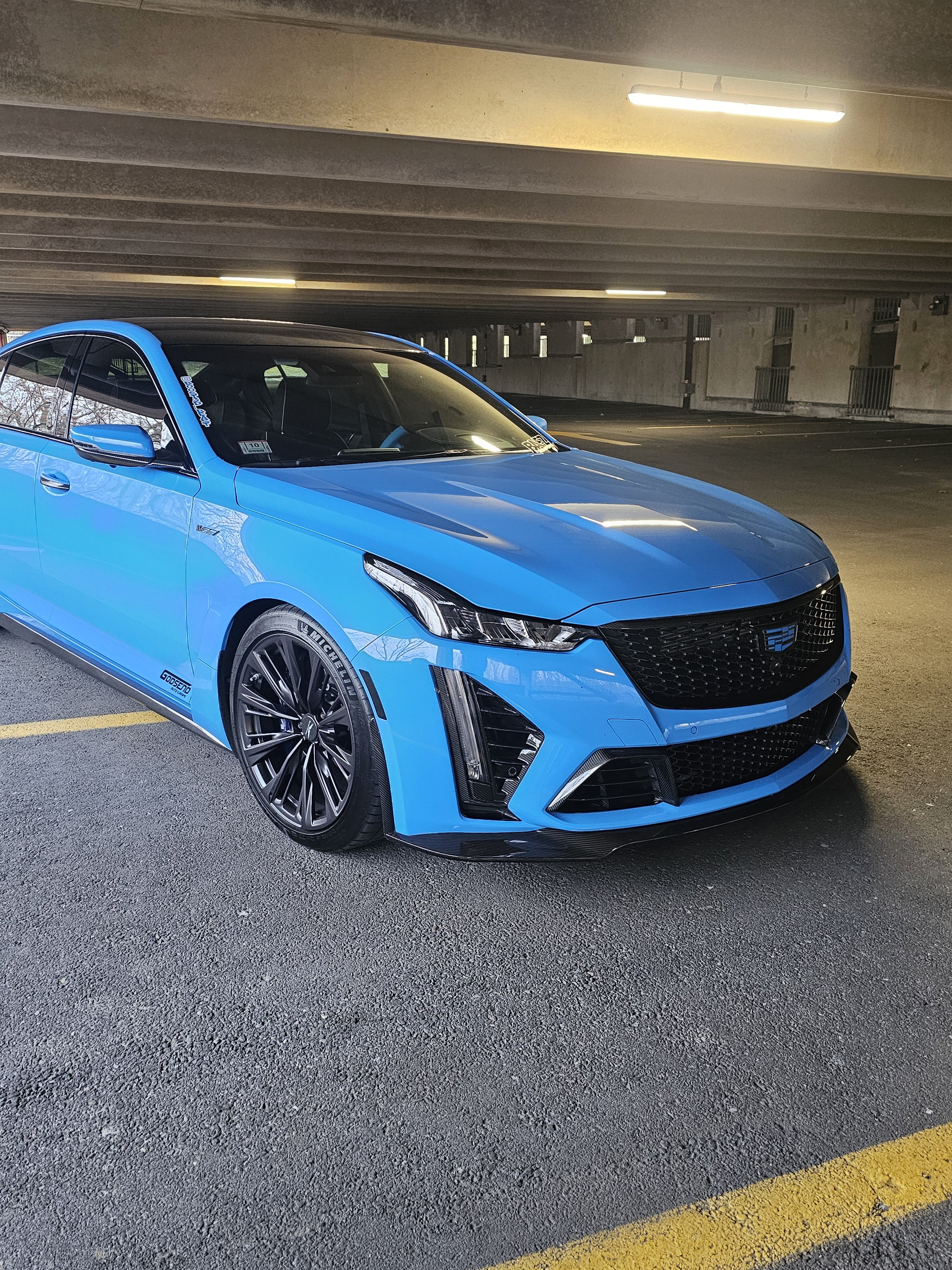

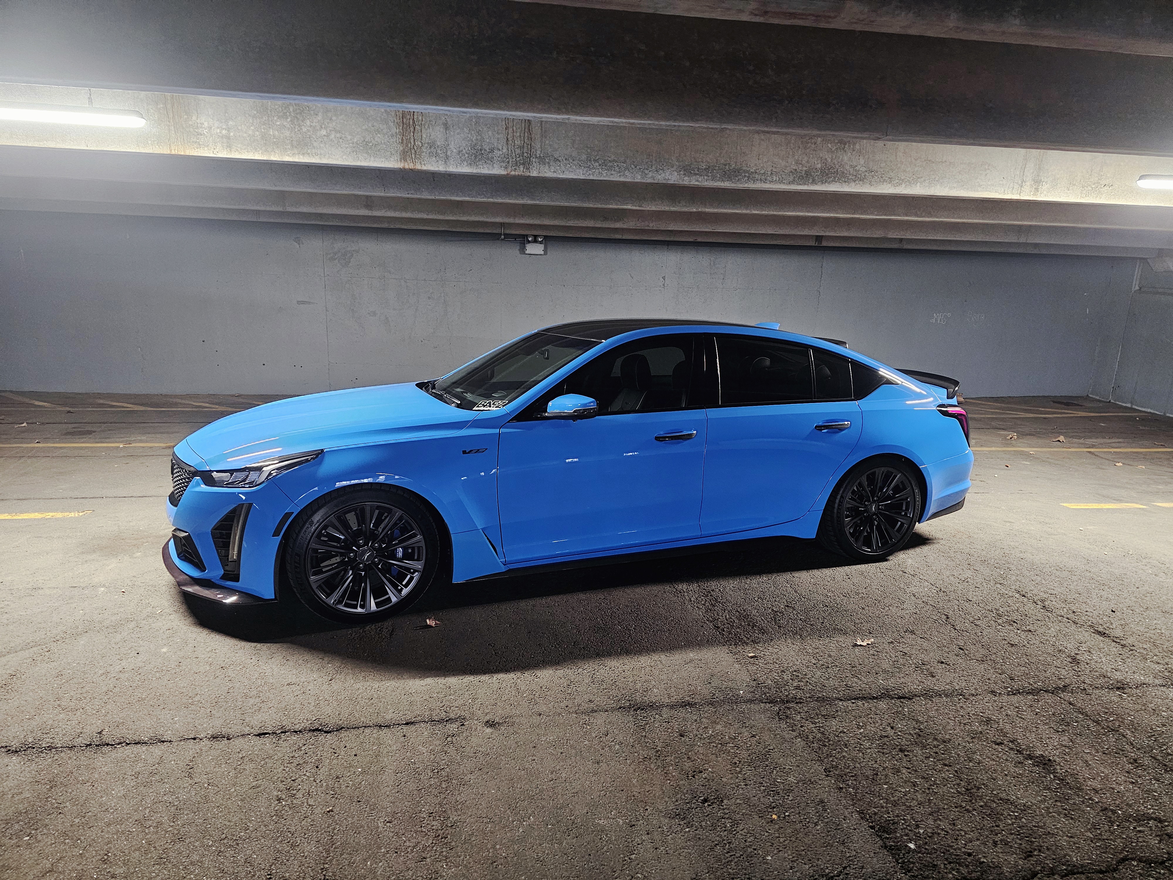

Few pics of my 23 BW on Swift R springs and full carbon fiber kit & full Carbon ceramics brakes.
I run 10 MM up front and 5 Mm in the rear.
