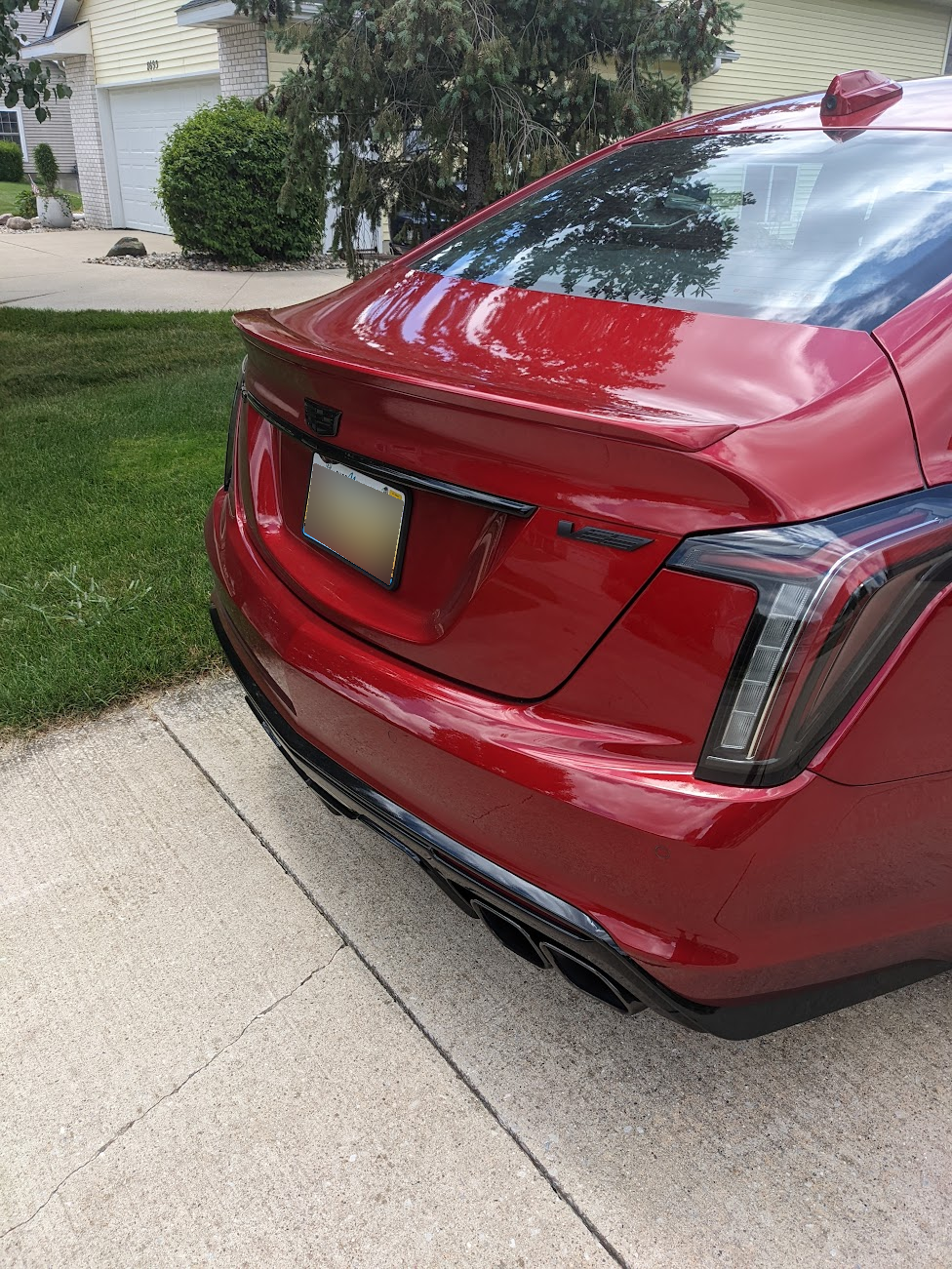

They are metal, but they are not glossy, but I think they look good. I got all blacked out badges and replaced my front and back caddy and CT5 from SavageCaddillac and then I got 3 of those above from eBay.
Were the savage Cadillac badges gloss black? I just ordered your ebay recommendations. Savages prices are lofty for what they are and am debating just spraying my stock ones. Curious how it would look with gloss and more of a satin v badge. Any photos you have of your car with them on?
Yes they are gloss black:
Honestly I think the Vs look fine with the other gloss emblems, but I guess if it were a big concern you could always hit them with some gloss spray paint:

Thanks! that looks great!
