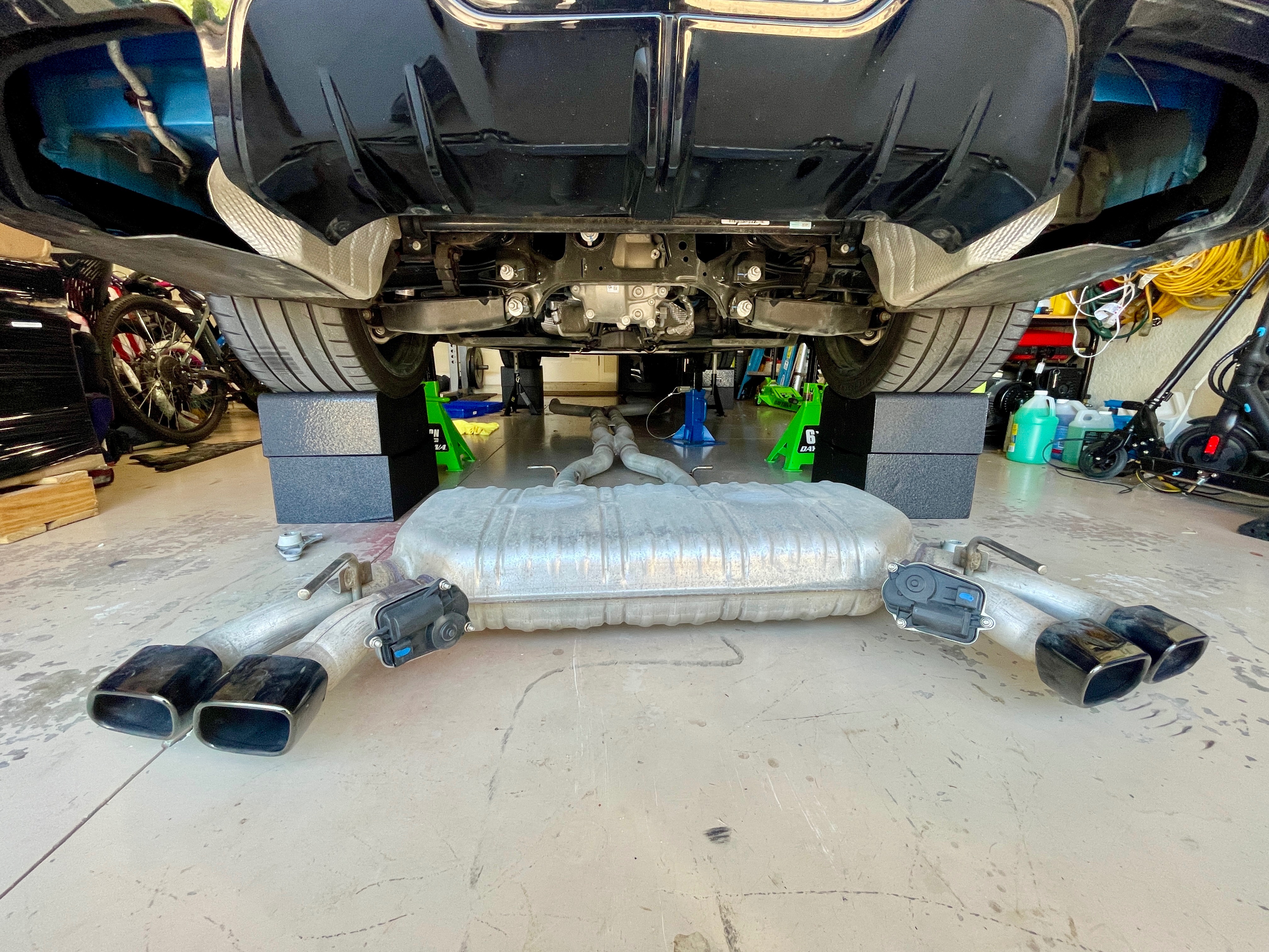

My friends lift is not available right now, so Im wondering if I can swap a 5BW long corsa catback without the lift? How high do you need to get the car to remove all the stock system without cutting? Im not a fan of using 4 jack stands but I could put it on solid 2x12s just depends how high it needs to go.
This much. I had plenty of room, a second set of hands would have been helpful lowering the entire stock one piece. I used 12” stackable race ramp wheel cribs.

These would work:
Did an oil change last week and never in my 73 years have I felt this comfortable under a car.
