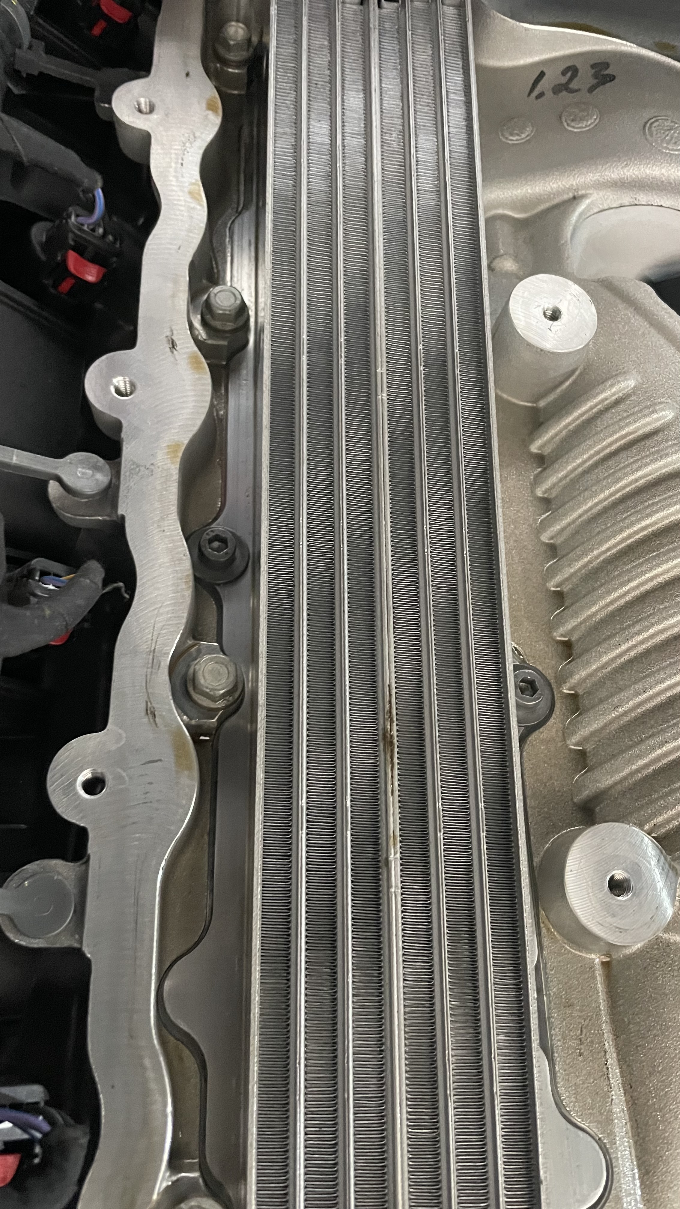

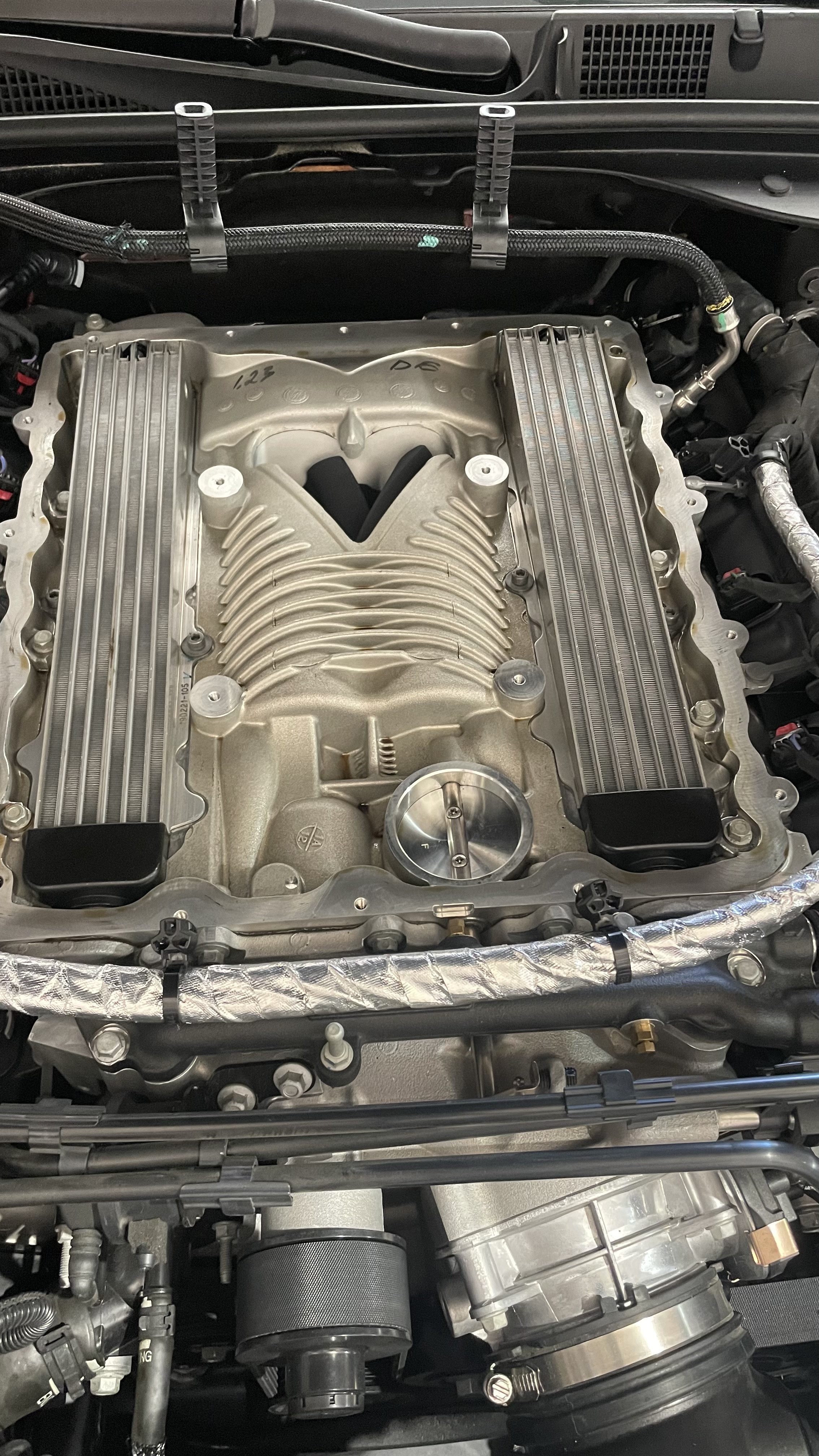

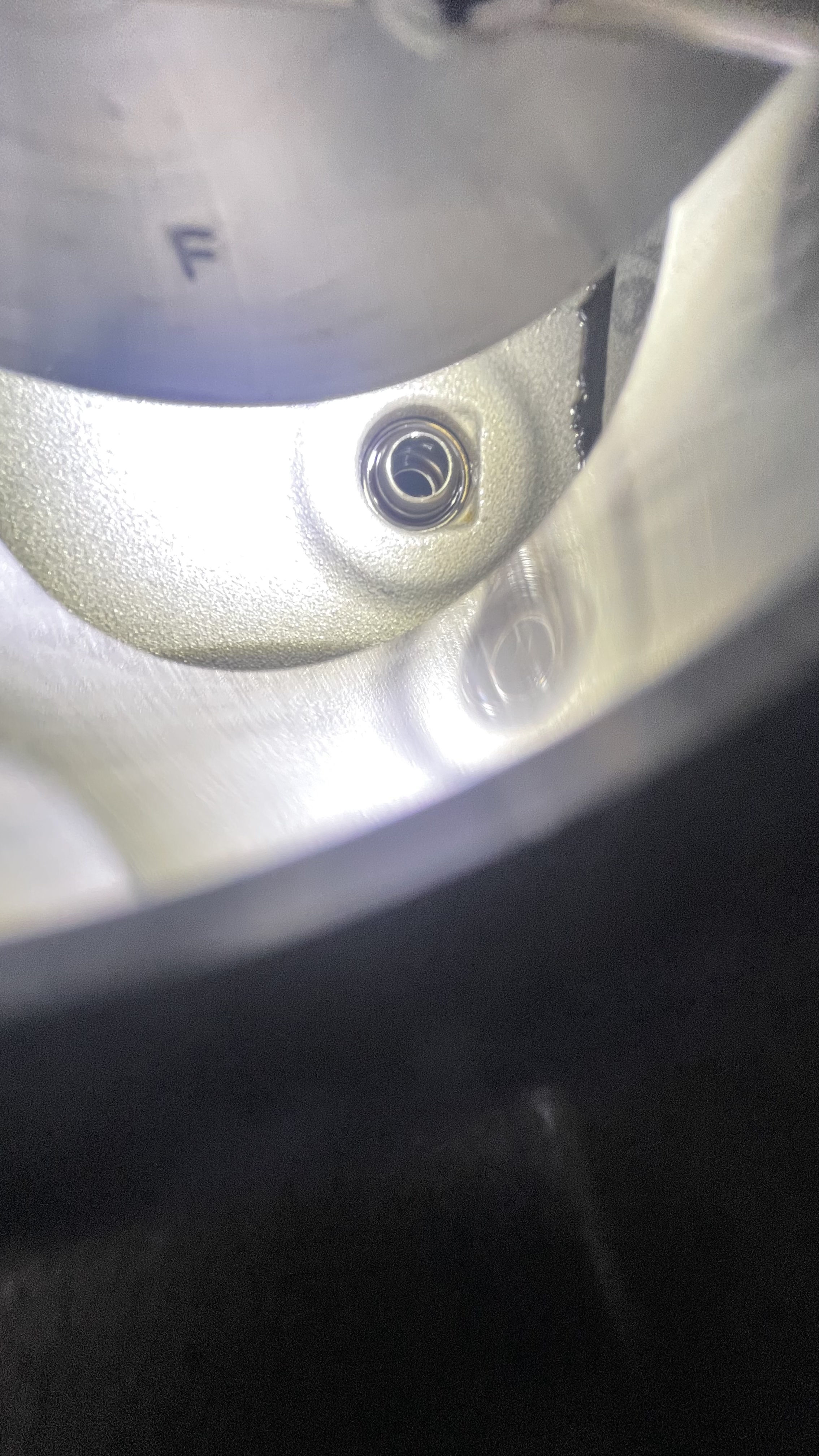

Yes and no...yes there's a factory catch can thats piped from the valve covers. No because GM thought its a great idea to stick the PCV directly into the blower. Blower sucks oil up the PCV and you get oil into the blower, then the lid and to the bricks. You get enough oil and gunk on the bricks and it looses its ability to effectively lower your charged air.
This is how much oil I got in the lid at 4K.
