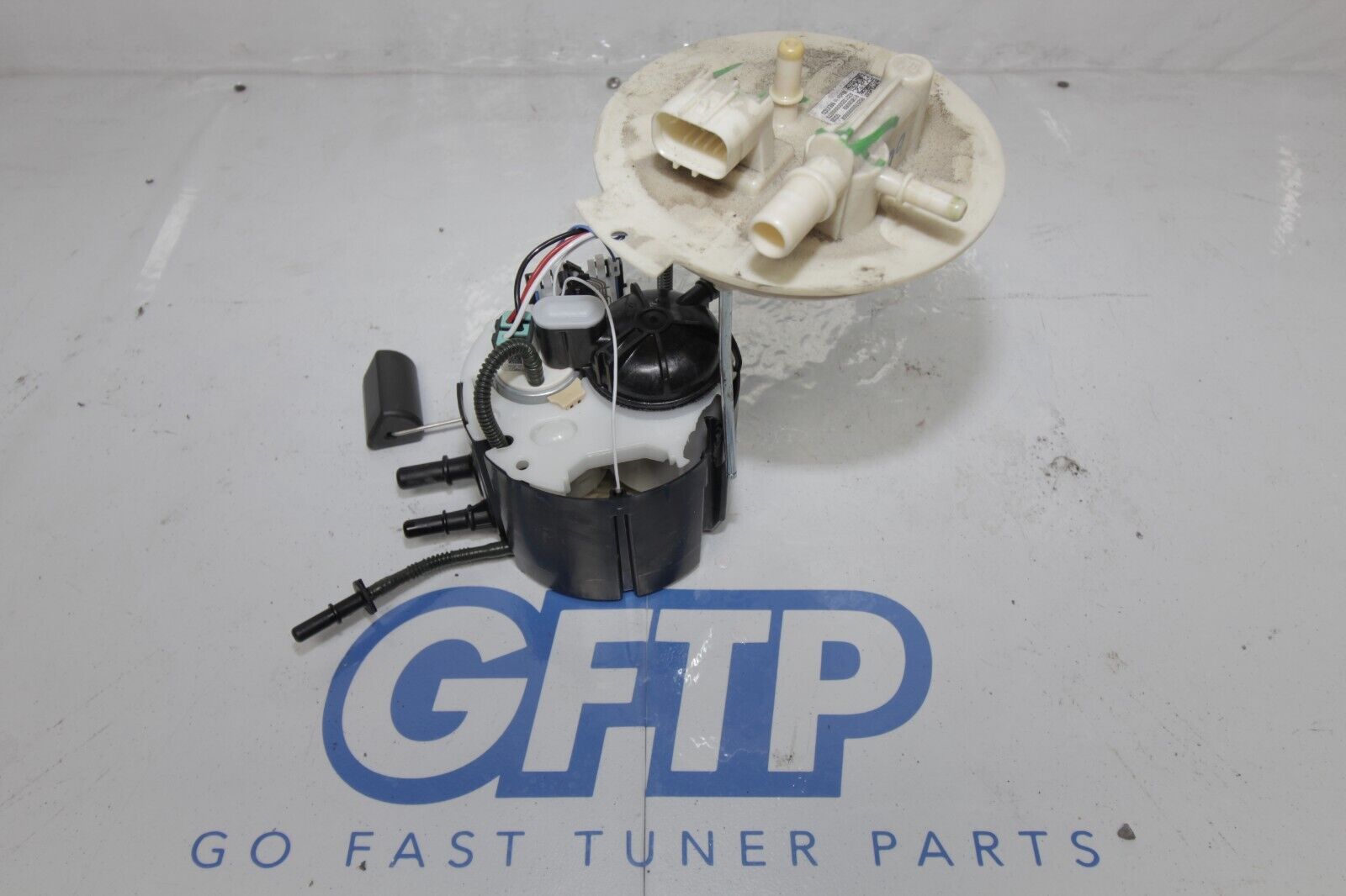

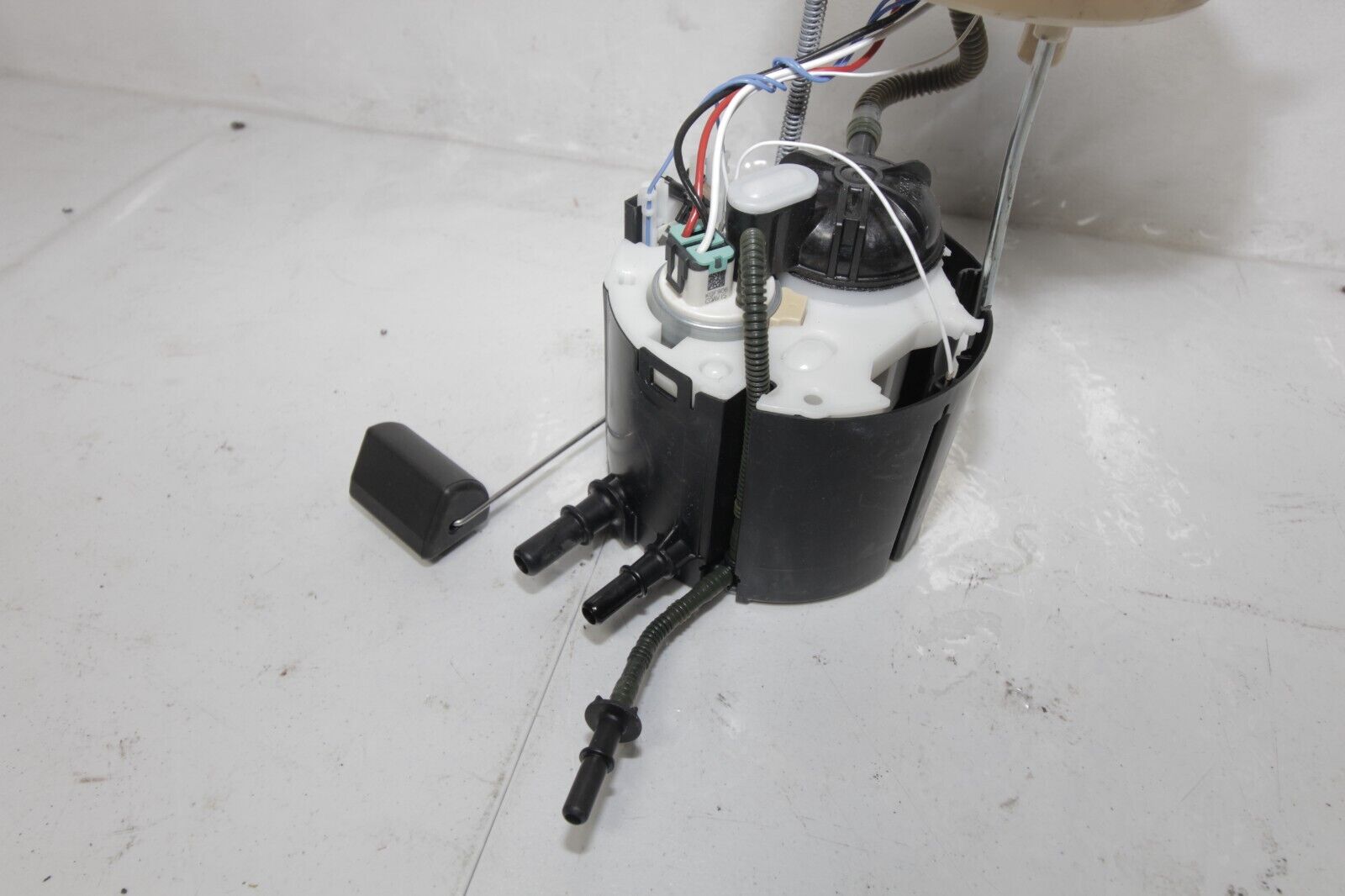

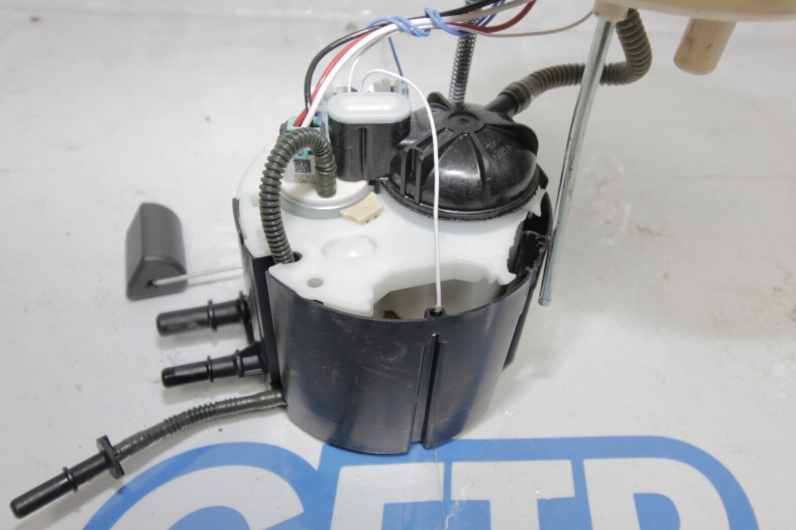

I just saw that DSX tunning is offering an AUX pump for the blackwing with harness and etc. Looks tempting to keep lowside in check. May be enough to run ethanol tunes.
I'm really trying to avoid drilling my tank and would love a simple in-tank pump that can flow better.
Doesn't Katech already offer one?
That Katech module might fit but it probably won't work--the CT4-V and CT5-V have a different bucket inlets and outlets than the ATS-V and CTS-V3. The real mystery is that section with the black dome-shaped lid.

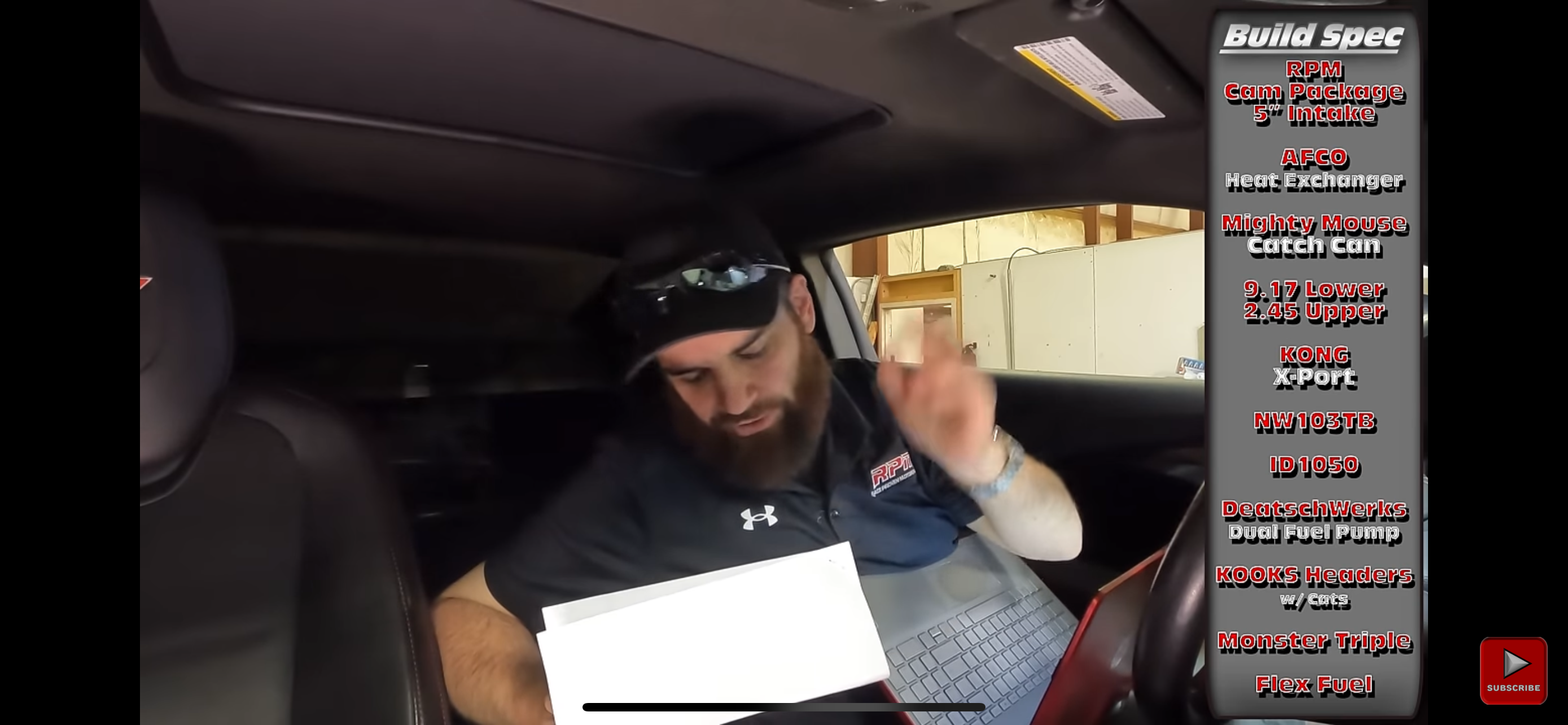

You must have not even watched the video.
9s on the street? As opposed to what, off the street? Lolz.
It goes without saying a Turbo car is much easier to modify and put out more power with less modifications.
9.93 @138mph
Upper & Lower pulleys
Meth
E50 Tune
Ported Blower
103mm TB
Pretty sure that’s the build sheet for the 5th gen he puts on the dyno next. It would be weird for a LT4 to have ID1050 injectors.
edit: autocorrect fix
I made it simple, click this. has the mods I said. that screenshot you showed is from a Camaro.
and a 5 inch intake and V has white interior.
