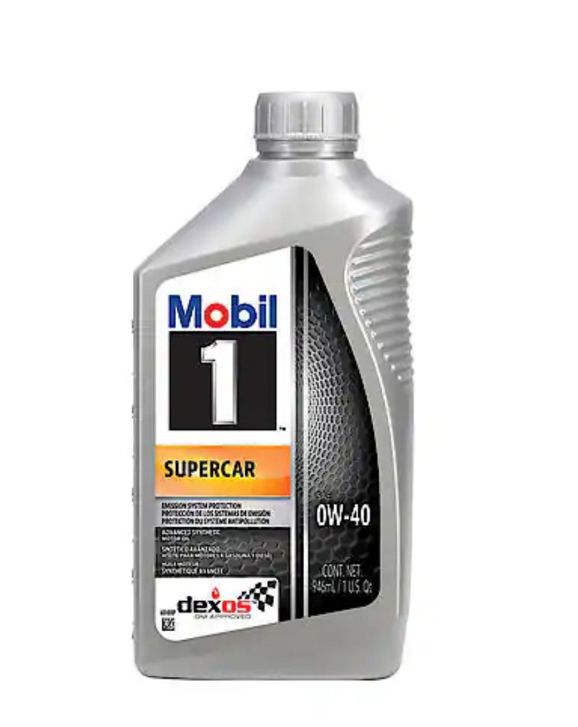

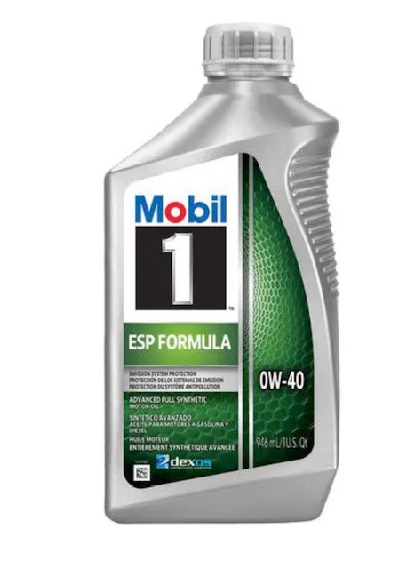

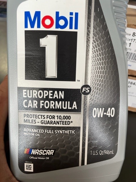

This is just a PSA for those that go to dealerships to have their oil changed - please ASK to see the oil they are putting in your car. I stopped by my normal dealership to pick up a few QUARTS of ESP / Supercar oil for top off at gas refuel. The gentleman brought out Mobil1 European Car Formula 0w-40 (pic attached) --- while I am still new to my BW I also knew GM calls for Mobil1 ESP Formula aka rebranded Supercar (pic also attached). I also had a Hellcat Charger and Trackhawk prior --- from a prior experience of wrongdoing I always double check stuff now to be safe.
I obviously questioned it bc the bottle they tried to sell me did not have approved DEXOS stamp per manual and some of the additives did not match ESP/Supercar formula from what I researched on Mobil1 website after. They based this on the weight 0w-40 matched specs and what GM sent and approved for them. Correct me if I am wrong please because IMO if it's not correct for our high performing cars the longevity of these cars may be compromised in due time.
He grabbed my VIN and it did pull up ESP/Supercar oil as expected but still eye opening that they admitted having been using potentially the wrong oil (at least in my opinion it was wrong). And I could be wrong out of sheer ignorance but better safe than sorry - therefore I am hoping to find out more from other members to either ease my concern that the oil they did offer is okay and or validate my concern that it is in fact wrong.
I called another dealership gave them my VIN and they supplied me the correct oil and part number. I raised this awareness with both Parts and Service to not call them out for any wrongdoing but to please kick it up the chain to ensure a potential oversight is resolved to reduce any future exposure both for them and the car owner.
If anyone is in the Cincinnati area and want to learn if they were potentially part of this oversight DM me. I have a few more miles before my oil change and would like to figure this out before possibly hurting my car.

Update from Mobil1 directly - we all know what oil needs to be used - just make sure your dealership does. Could very well been an honest mistake but that mistake can cost you $100K car
"The Mobil 1 FS (European Formula) 0W-40 does not have the dexosR or dexos2 approval required by GM. I have attached the product launch document by Mobil for the Mobil 1 Supercar 0W-40."

They were not even using the ESP Euro they just grabbed a EURO FS 0-40 M1 which was what raised a major flag for me

I believe the ESP was just rebranded as Supercar, but it's the same oil. Just take it to the dealer for the freebie and verify a few times they're using the right oil. You can search on the Cadillac website for dealers that have V certified service departments too. Before leaving check the invoice for the parts number of the oil they used and make sure it's right.
Supercar was rebranded from ESP Formula. I bought a few boxes of these from Amazon
