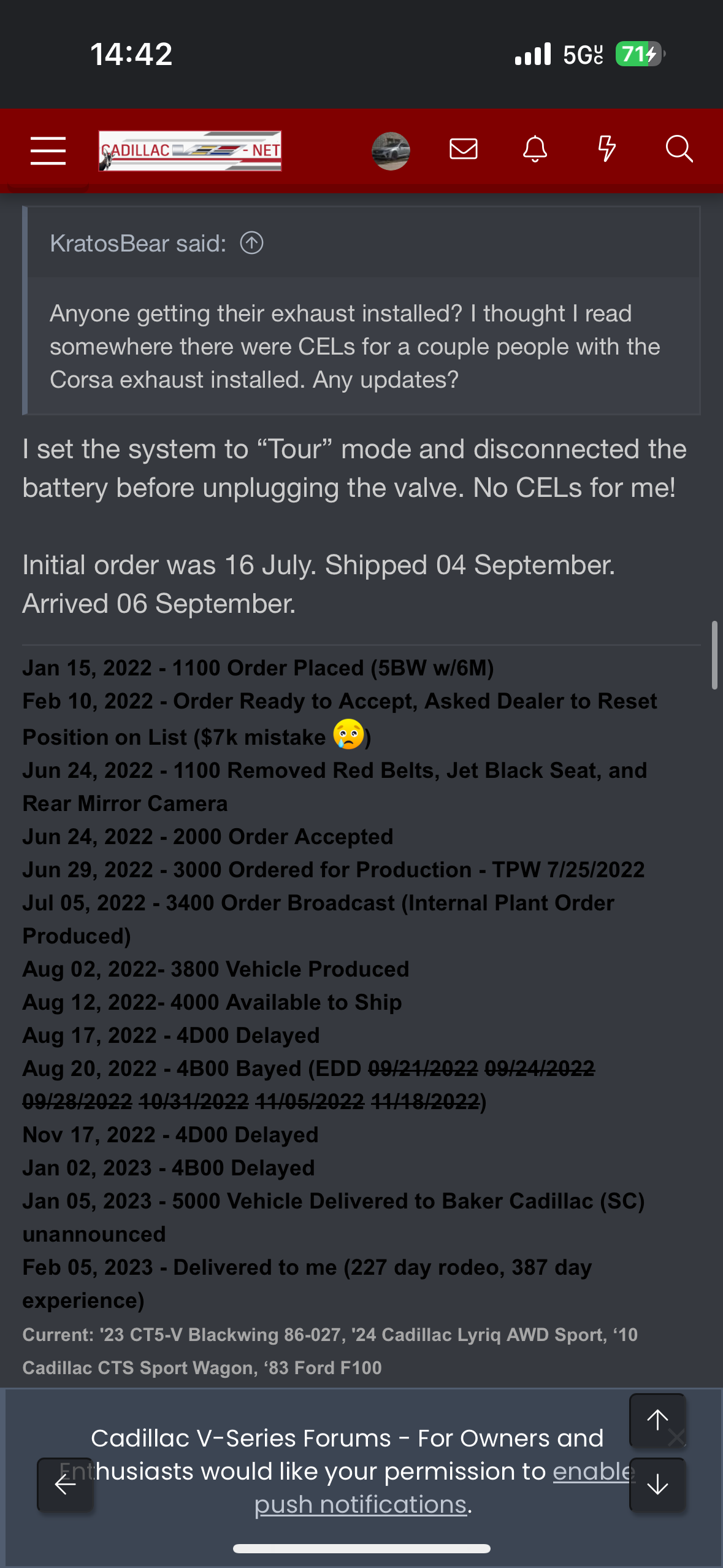

Put it into Tour mode, disconnect negative, install. If you throw a valve position code, perform a relearn. Very easy process. Regardless of which mode, if the computer senses an out of range variable it will require a relearn. Might as well just grab a Launch OBD bidirectional tool (unless you have one) and have just in case. If a shop is doing the install, they can do a relearn if need as well.

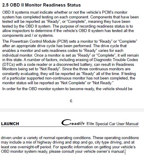

I have been trying to do an exhaust relearn but the tool says "not ready" under the learn function for exhaust valve relearn. The valves still function just fine, open and close as they should. Just cannot get rid of that damn CEL. Does anyone know what isn't ready? Or maybe if a dealer or tuning can override it and force readiness for the learn

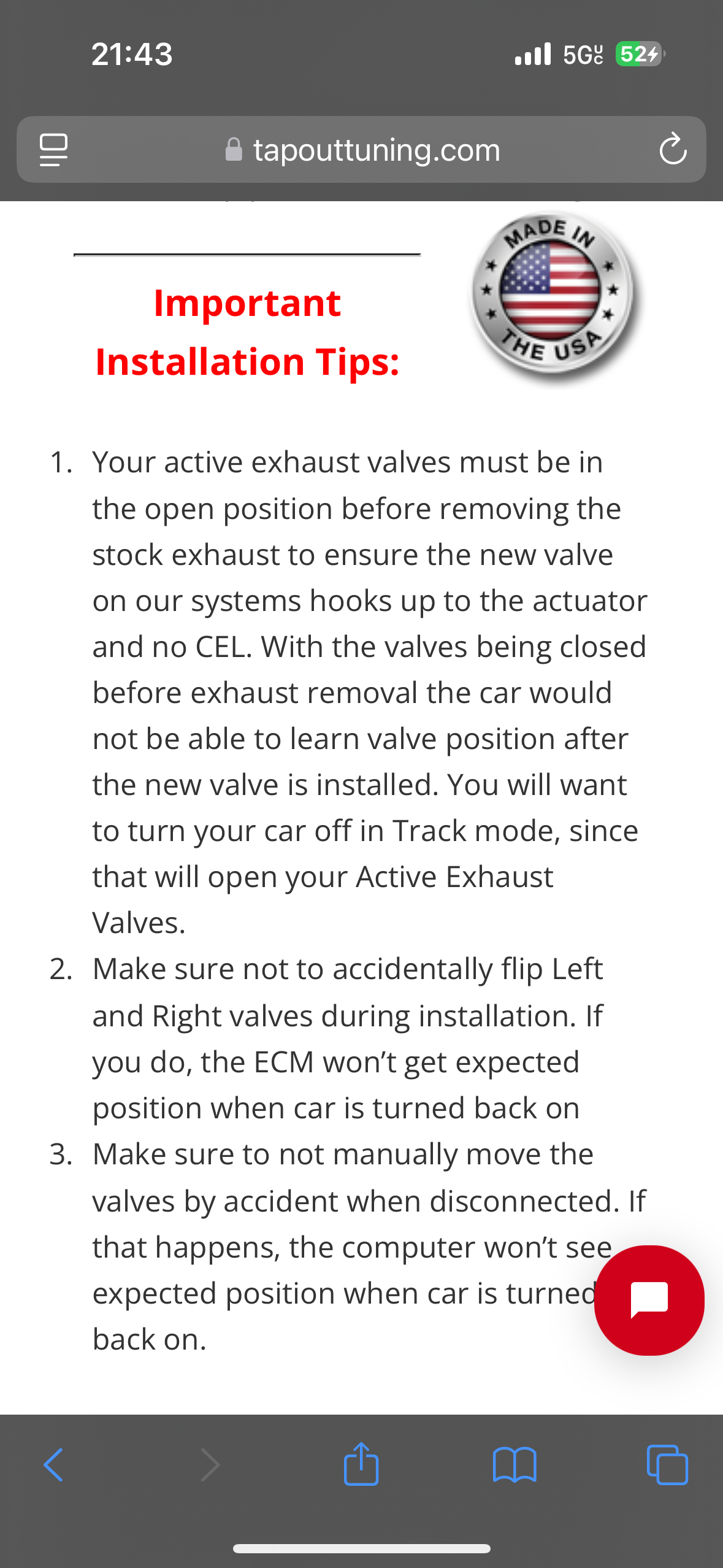

Corsa’s instructions (at least the ones on their website) don’t mention anything about whether the valves should be open or closed, or what mode to disconnect the battery in. I did find these 2 instructions online, but they contradict each other.
