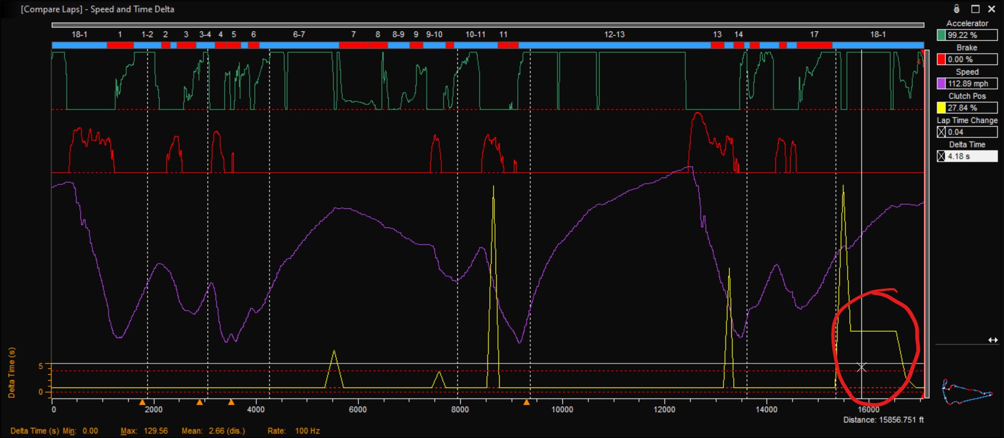

Here is a good example in data. I have two laps in a row where this happens on the front straight. I upshift from 3-4 but the clutch (yellow line) hangs at 28% engaged even though my foot is off of the pedal.
Why are there little blips of clutch engagement? Looks like it's happening when you lift?
Those are all shifts. The clutch position data is only logged at 1 Hz so if you shift quick you might not even see it in the data or you only see part of it.

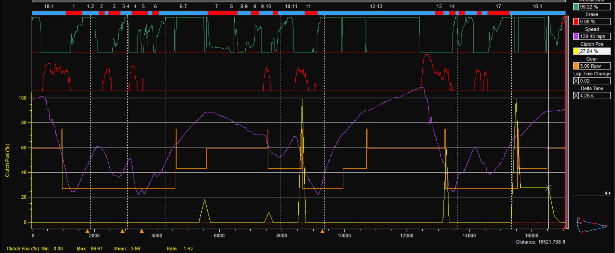

Same chart but orange is gear, spikes between gears you see is neutral.
Got it. That's really cool, what are you using to get this data?
