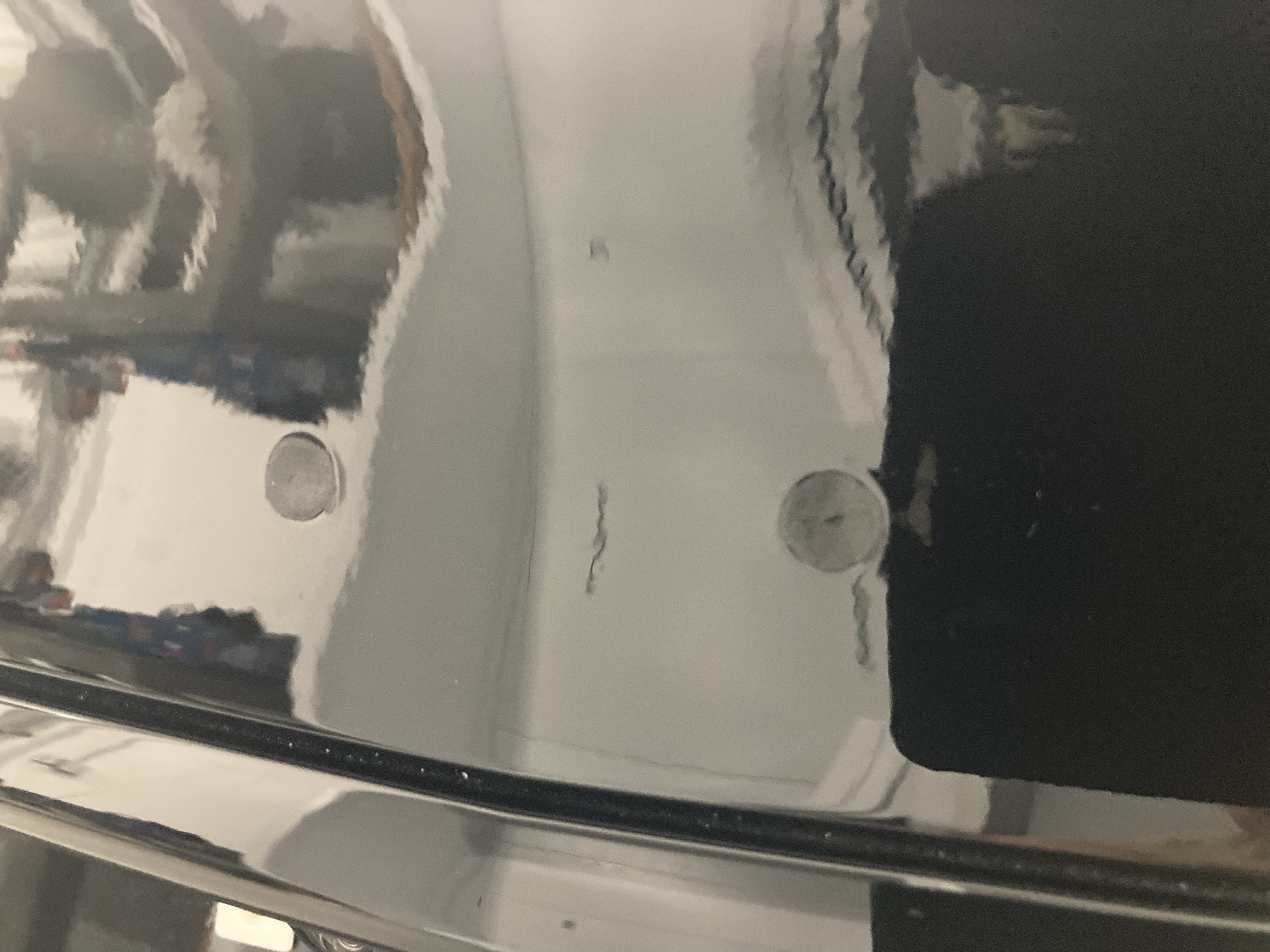

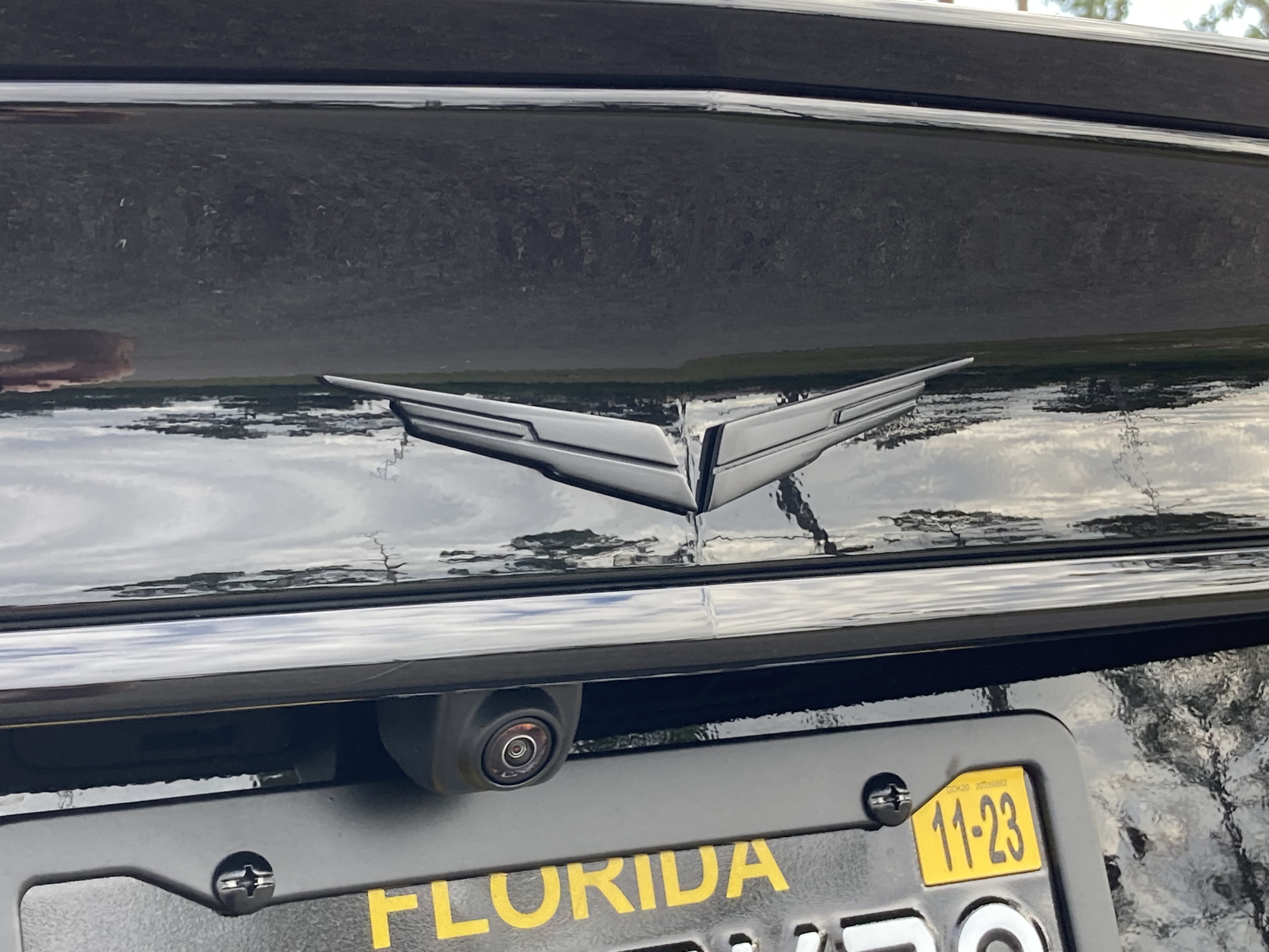

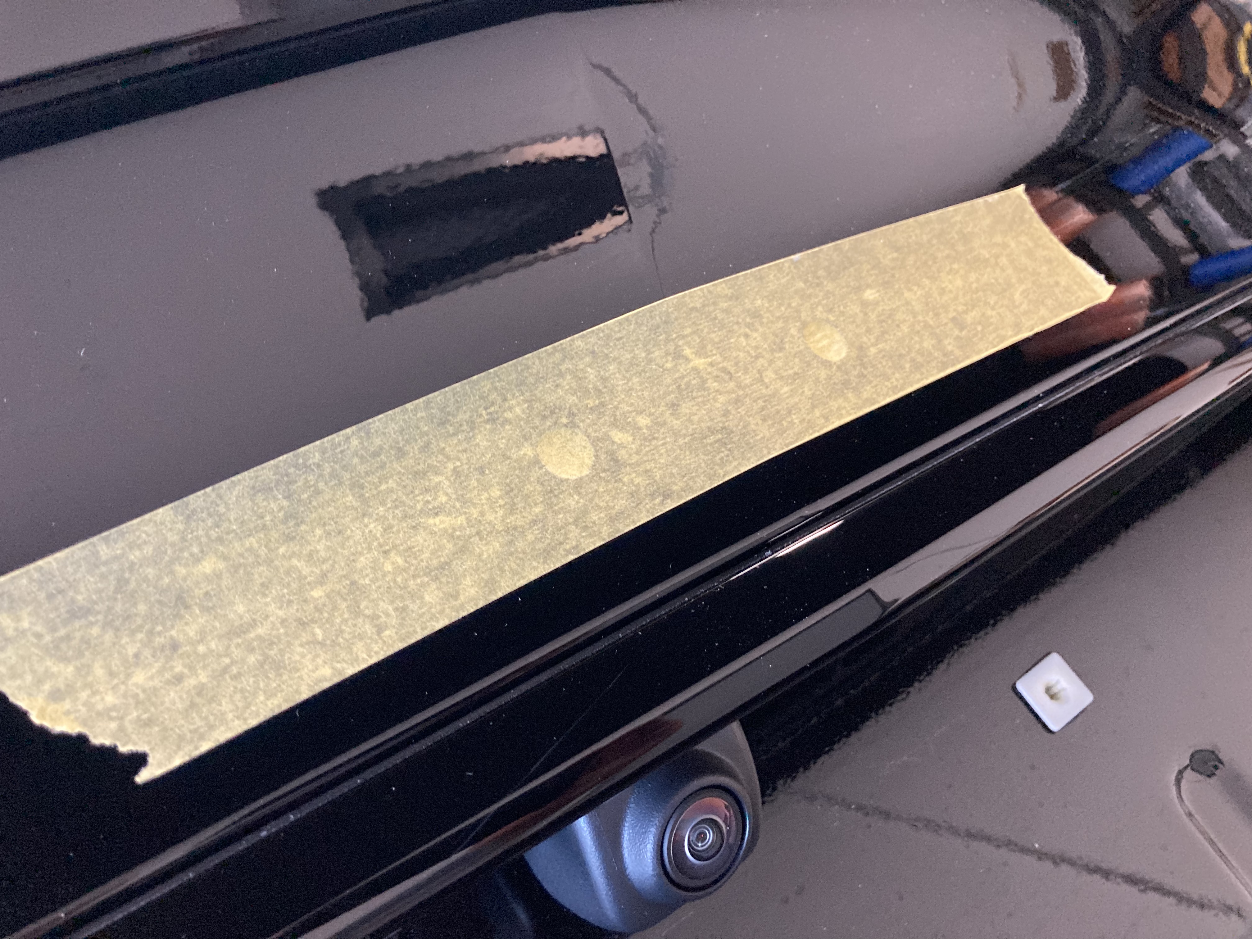

I thought this might interest some people.

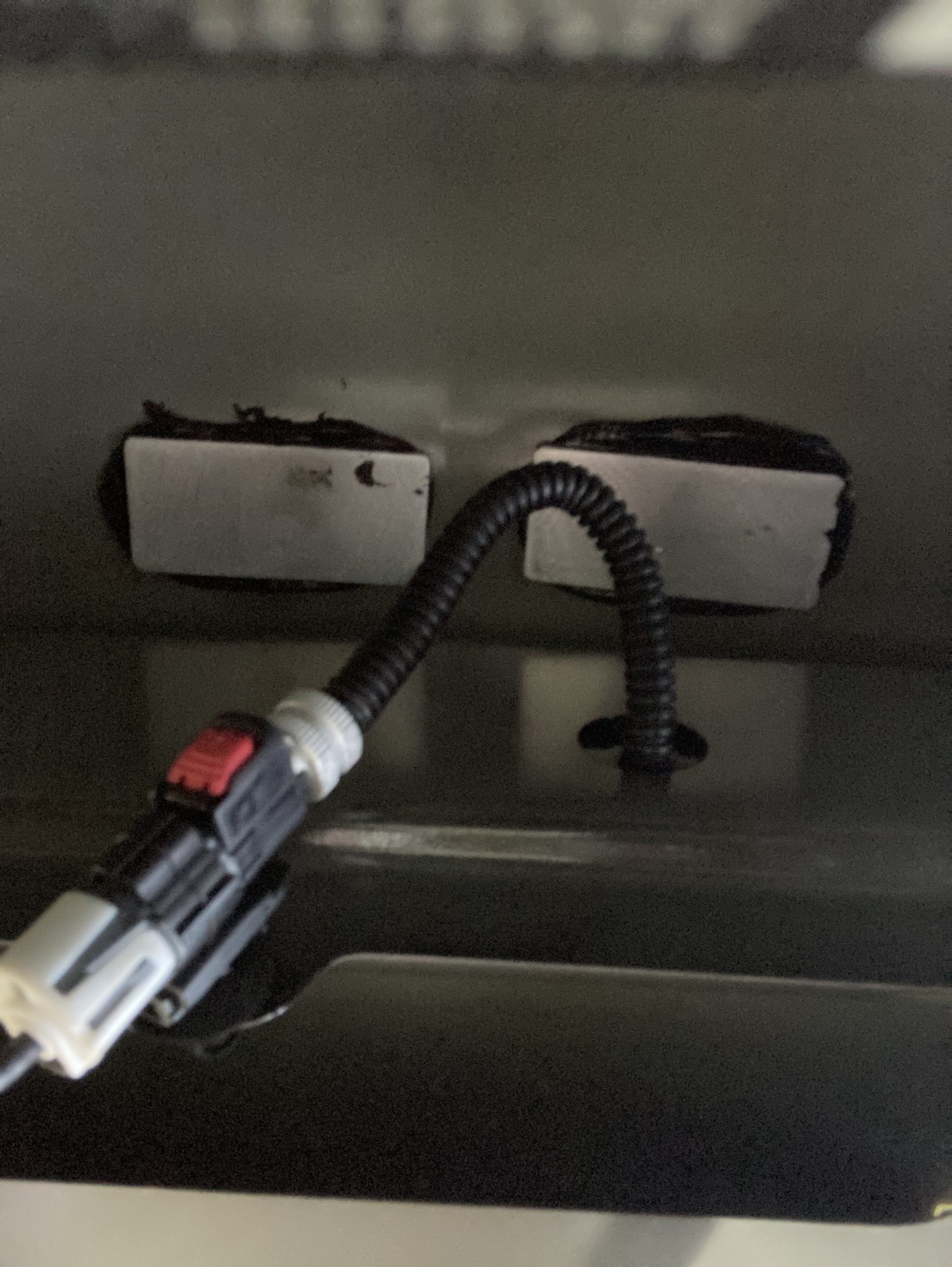

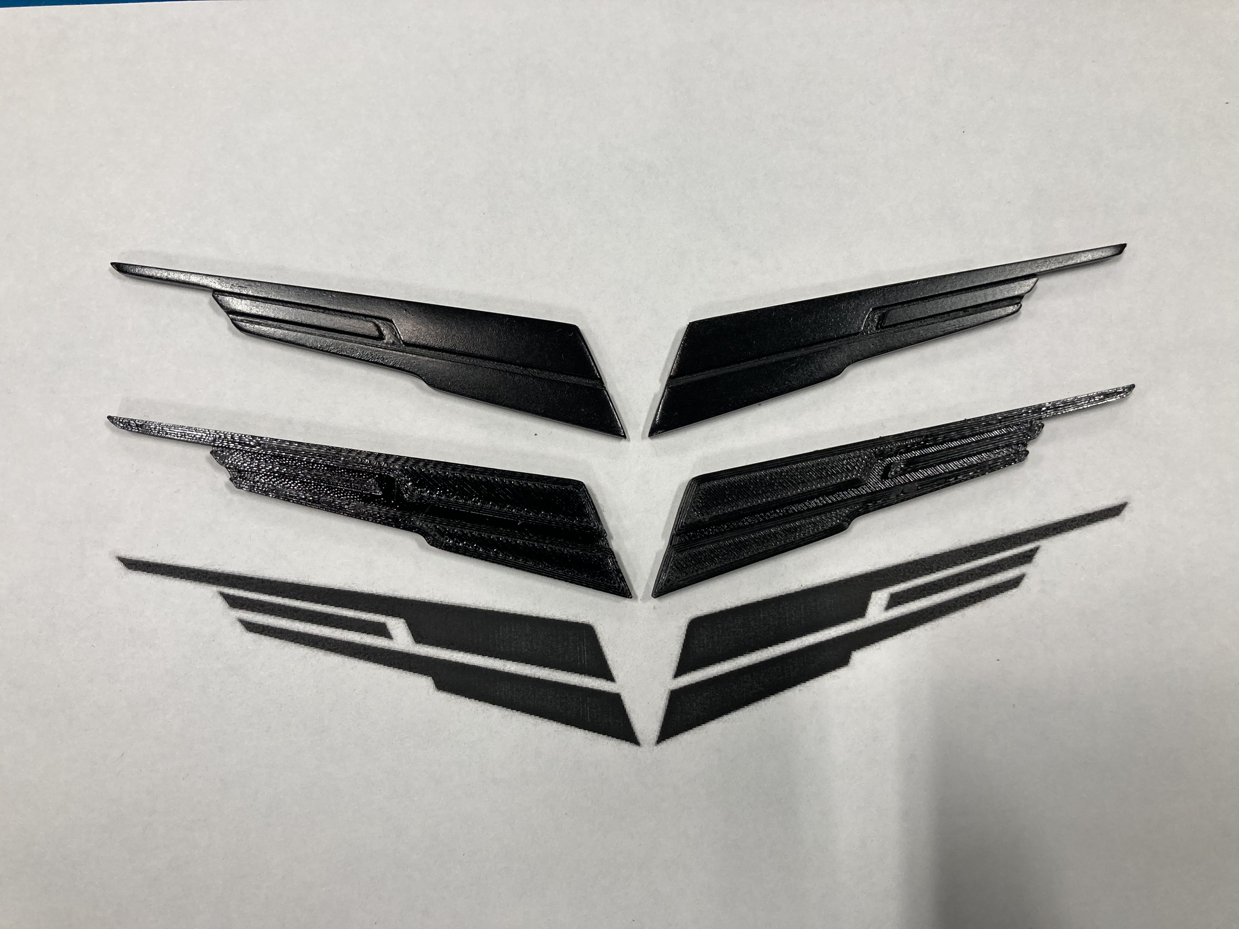

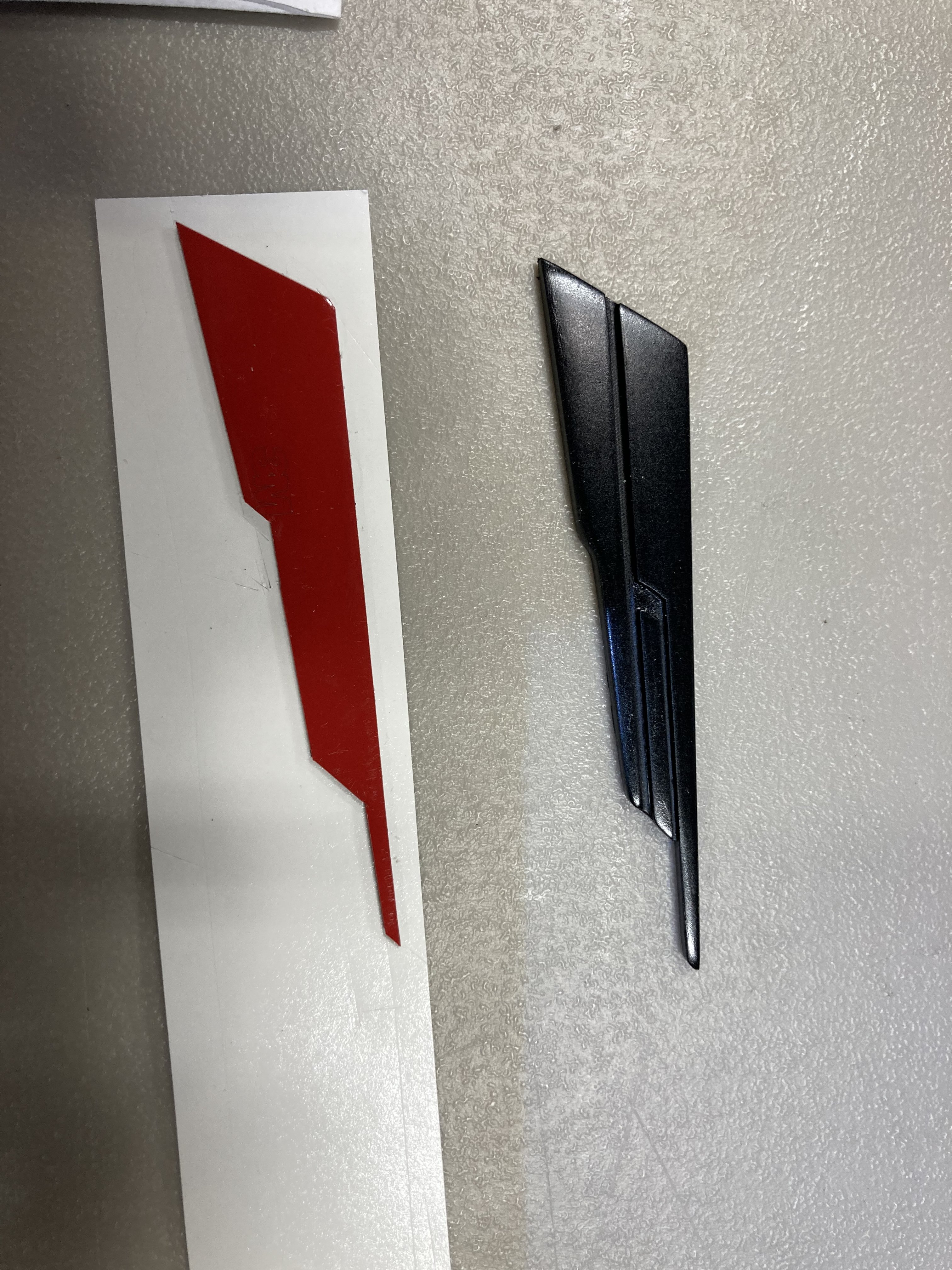

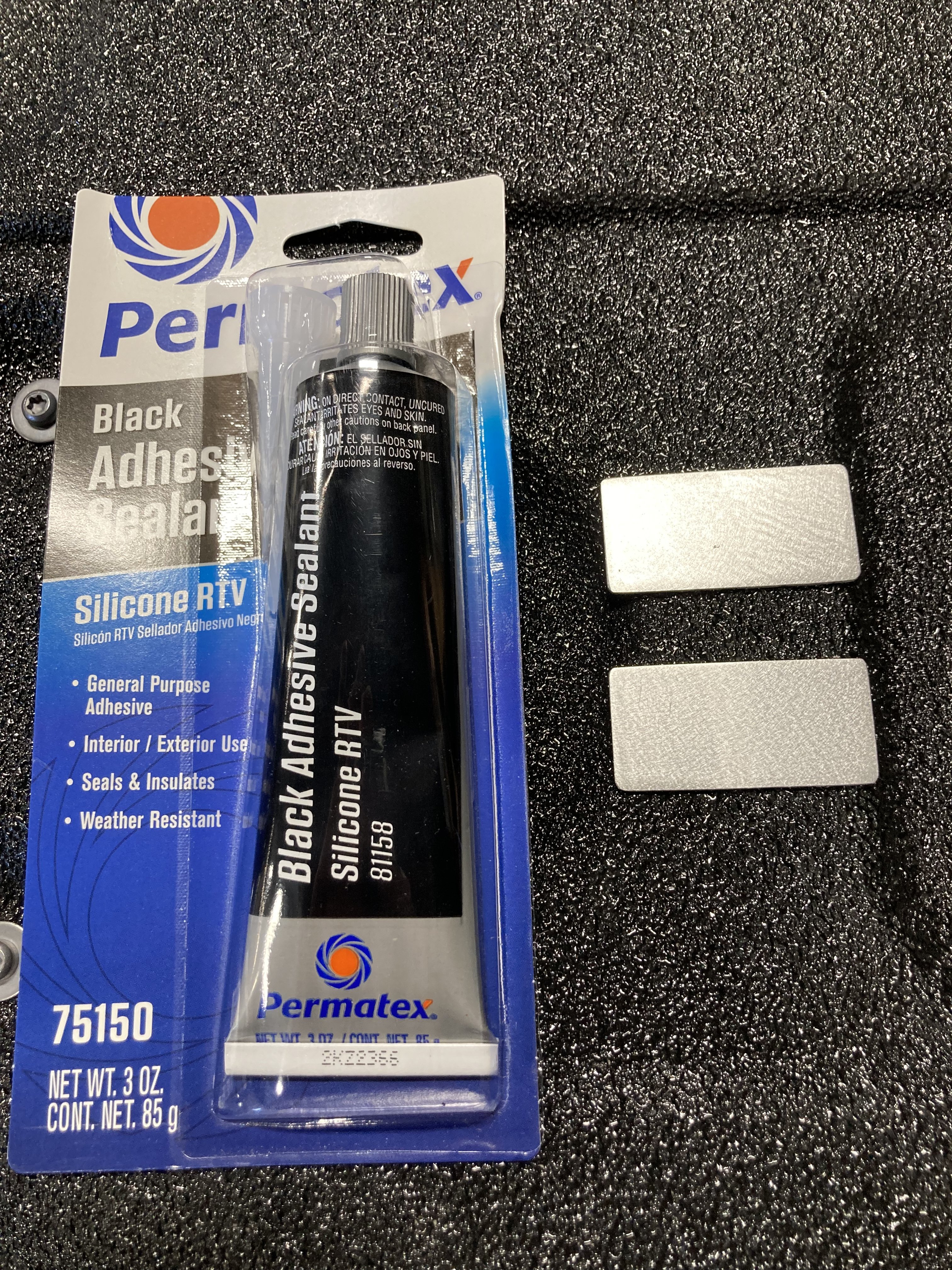

I had a local 3D printer make them out of plastic. Then I sanded and filled the tooling marks out, then painted. Filled the holes in the trunk as you can see in the pics. Used 3M double sided tape to install. I also removed all the other emblems on the car for a “cleaner“ look. Figured I’d post the details if anyone wanted to do something similar.
