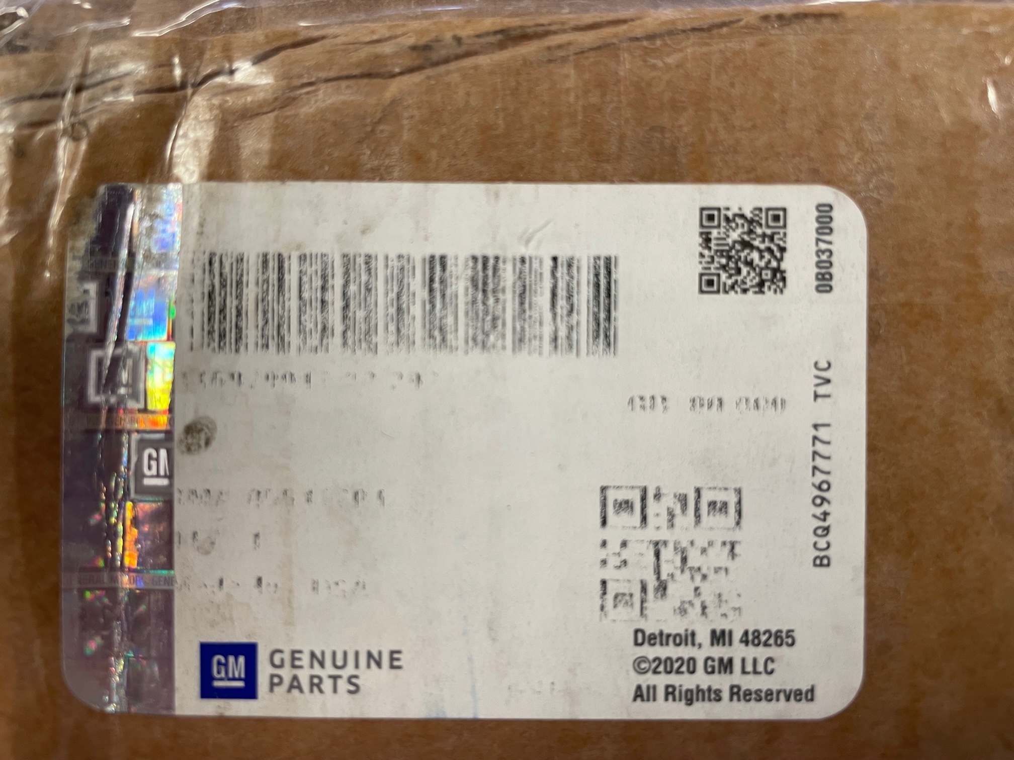

Hi all,
Just bought a used 22 CT5 BW and the dealer had added the CF 1&2. The rear spoiler was backordered and they finally got it and shipped it to me. Just opened it up and there is no template or hardware for it. The part # on it is 85517784. Shows up on a google search as the spoiler for the CT5 but it only costs about $2100 versus the ~$3.2K for part# 85561511 that is listed on the first post.
Anyone know anything about this other part #? Are they really charging over $1000 for the hardware and template? I'm not sure what to do now without the hardware and template. My guess is that this part# is for a replacement spoiler (after a collision?) for a car that came with the Carbon 1 package. Then the holes are already there and you would reuse the hardware.
The dealer won't do anything since I am in Wisconsin and the dealer is in Pennsylvania. Does anyone still have the template and a really good description of the hardware that is included? Would really appreciate it.

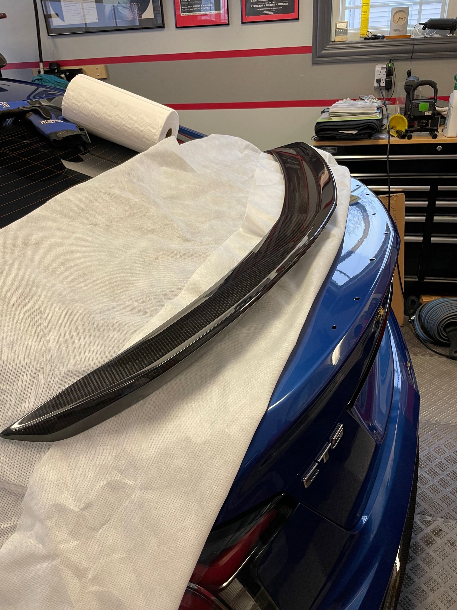

You have to drill the 2 outer holes for the Carbon spoiler. They do not exist unless your car had the Carbon 1 package. I removed the stock one, which is just taped on, and put the new carbon one on using the 5 existing holes to "align" it on the trunk. I then put tape under the 2 bolts needing holes and marked the tape. Set aside the spoiler, center punched it and drilled the holes. Started small and drilled 3 or 4 times up to a 5/16" bit. Spoiler fits great!
Now need to get some info on the hardware and paint the hole edges before it gets installed for good. No hurry since the weather here is crap for awhile.

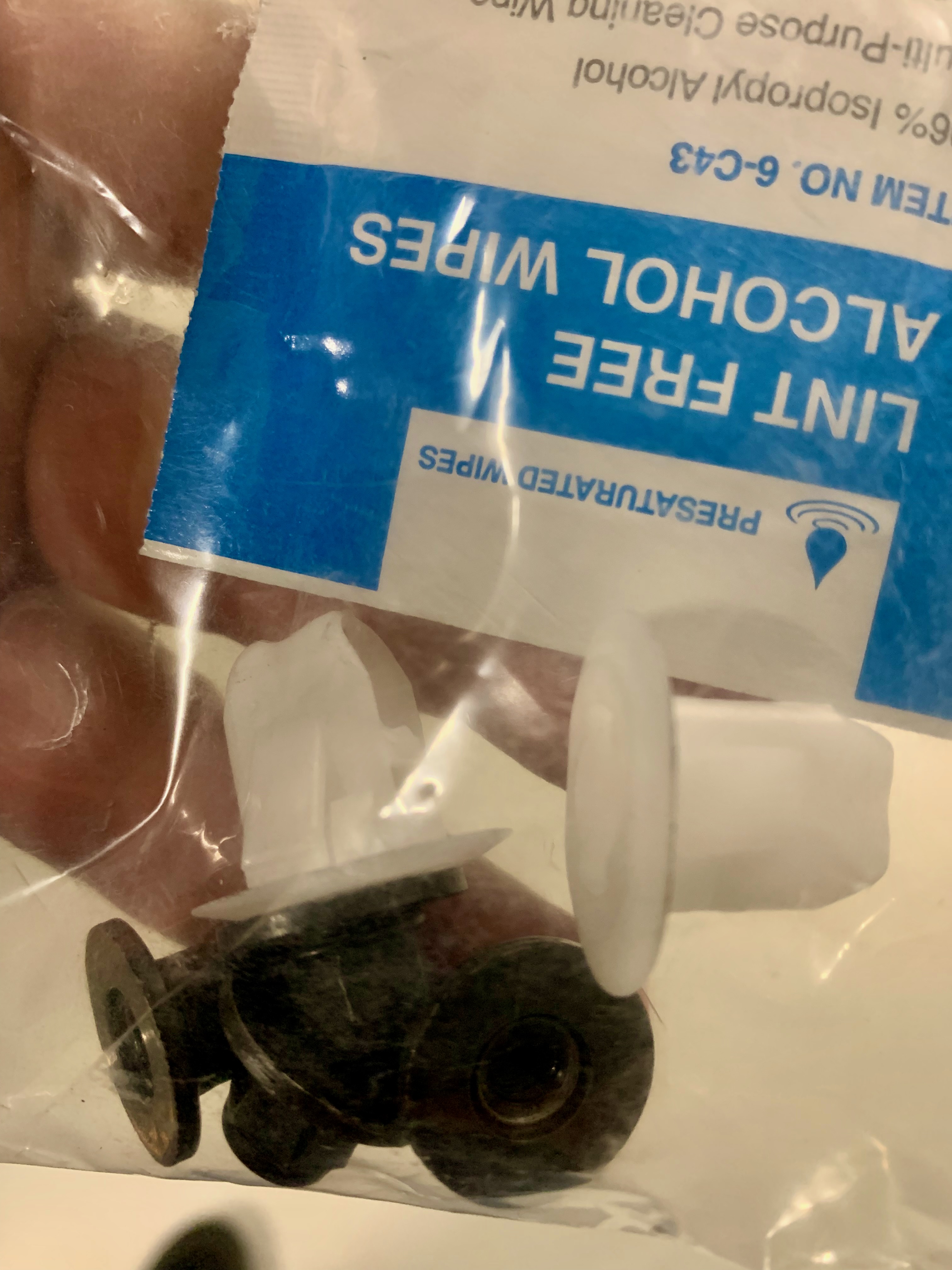

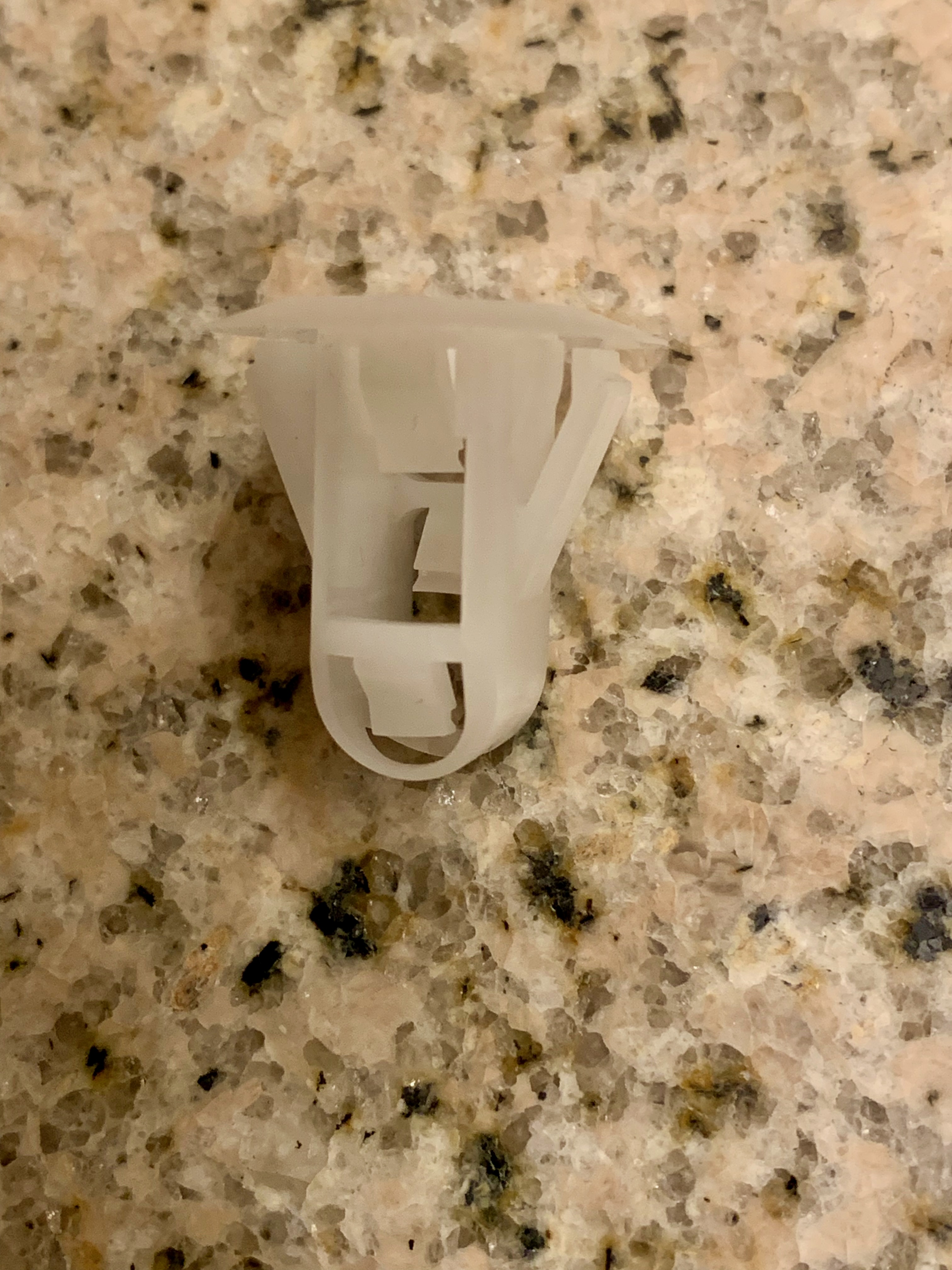

I bought the current available expensive CF rear spoiler kit. I got a special one time buyer price deal, so I paid a lot less than $3200 and sorry, it can't be repeated. On the back side of the spoiler, it does have part # 85561511, the kit I purchased. Does yours show part # 85517784?

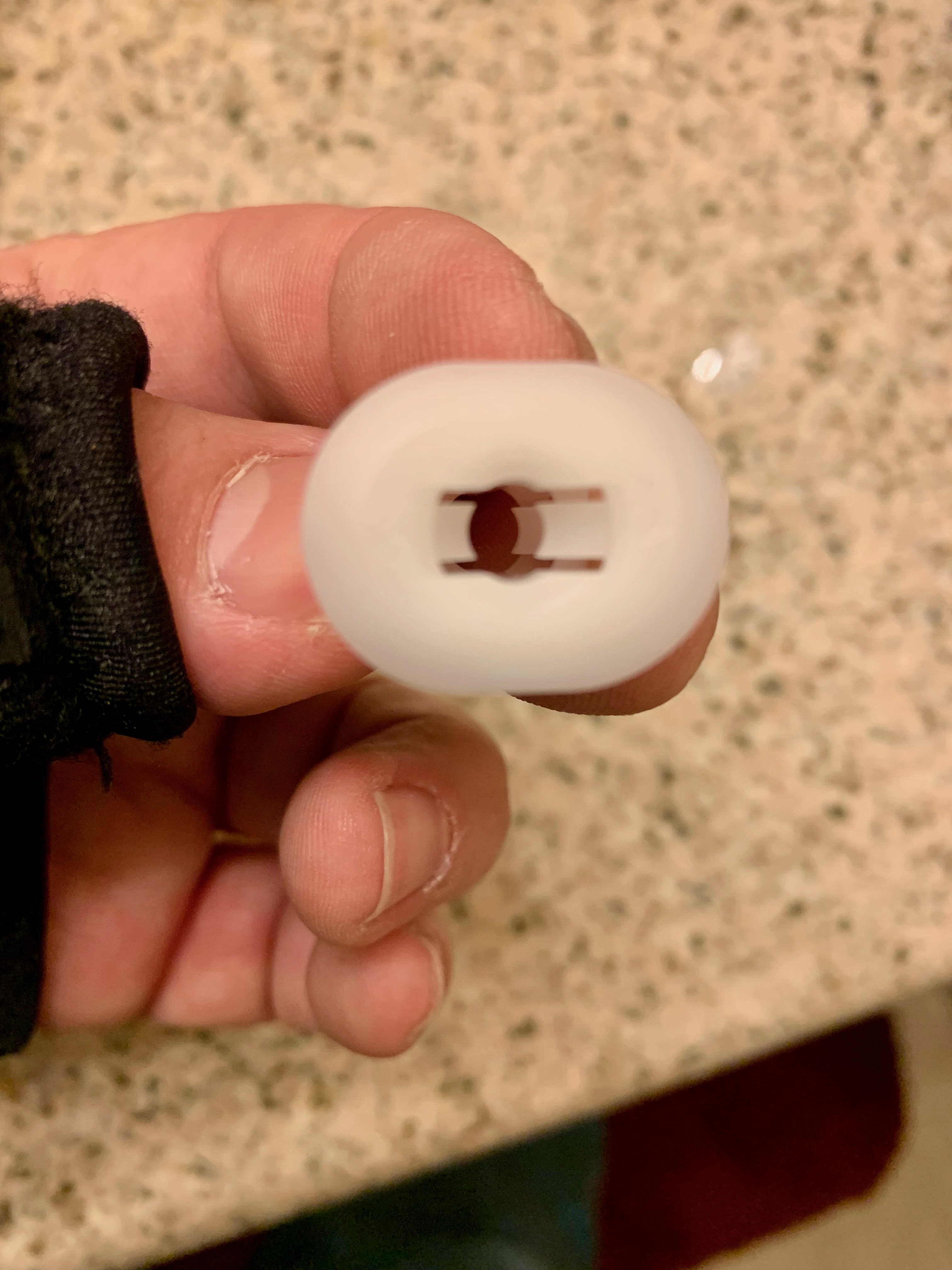

For the two outer holes, GM provides special plastic "push nuts" that require a 15mm or 0.59055 inch hole, just short of a 5/8" (16mm or 0.62992) hole to mount to the trunk lid. It does not need to be an oval hole. It appears to be extreme difficult if not impossible to reach through the inside double walled trunk lid to tighten any nut otherwise. The plastic nut locks into the hole and the CF spoiler bolt locks when you push downward. I can't imagine how to remove once installed in the future. For the other 4 bolt holes, GM provide metal nuts that you tighten from the inside of the trunk lid. Easy to reach these. On the far outer two edges of the spoiler, it does have double sided tape to help secure it and I plan to use 3M activator instead of alcohol prep to make adhesive stronger.
I plan to mount over the weekend unless I get interrupted by work. I also plan to use basic touch up paint that I have laying around for any drilled holes as nobody will ever see those areas. I wish I had real tiny hands for the outer holes to drill smaller holes and use metal nuts or that GM would have offered some access holes between the walls. This rear spoiler seemed to be an after thought, lol!

Wow. Thanks for the instructions and the close up pictures of the plastic clips/retainers. Very helpful. Looks like I need to find something similar or figure something else out. Sounds like no access to those outer holes to use nuts.

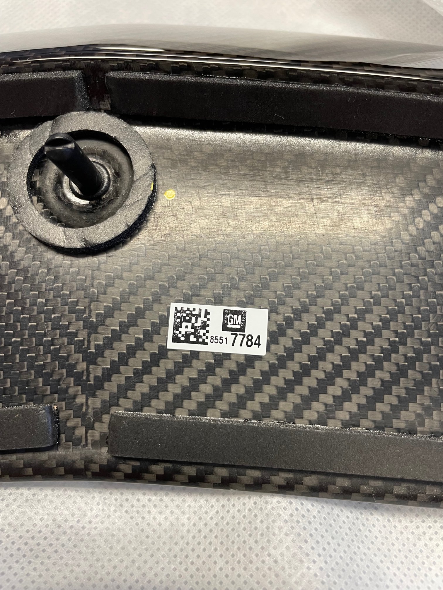

My spoiler does indeed have part # 85517784 on the bottom of the spoiler.

Mind sharing pictures of part#85517784. My dealer sent me that number when I inquired about CF parts, but I sent him the one that was confirmed here. (Dealer/Service sucks so badly, I am at a crossroads at what to do. They have been falling well short in helping me obtain CF, wheels, tires. They ignore me, it's terrible customer service/relationship, they don't care. #sadstory)
Call another dealer. I was told the 784 part number is discontinued.
Here are some pictures.
I ordered those parts (nuts and plastic bushing) from GMPartsGiant. But just got an e-mail from them saying the order has been voided because the part numbers are not available or do not have a shipping date.
Shoot. Oh well, will have to figure out something else.
