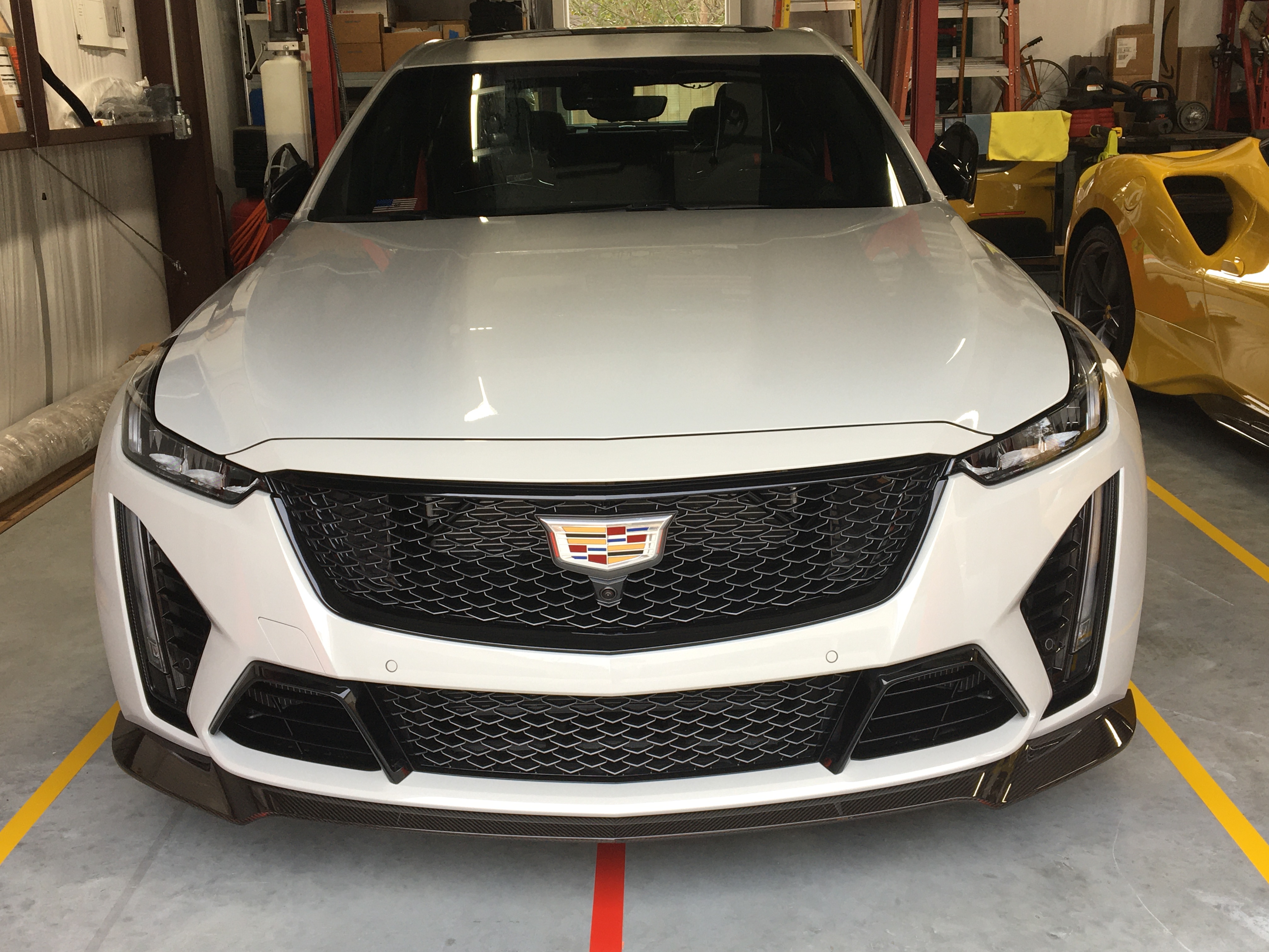

Got the carbon fiber front lip spoiler on yesterday. Really love how the front end looks now !
It was only a hard and time tedious job because I didn't know what to expect or what pieces had to be taken off.

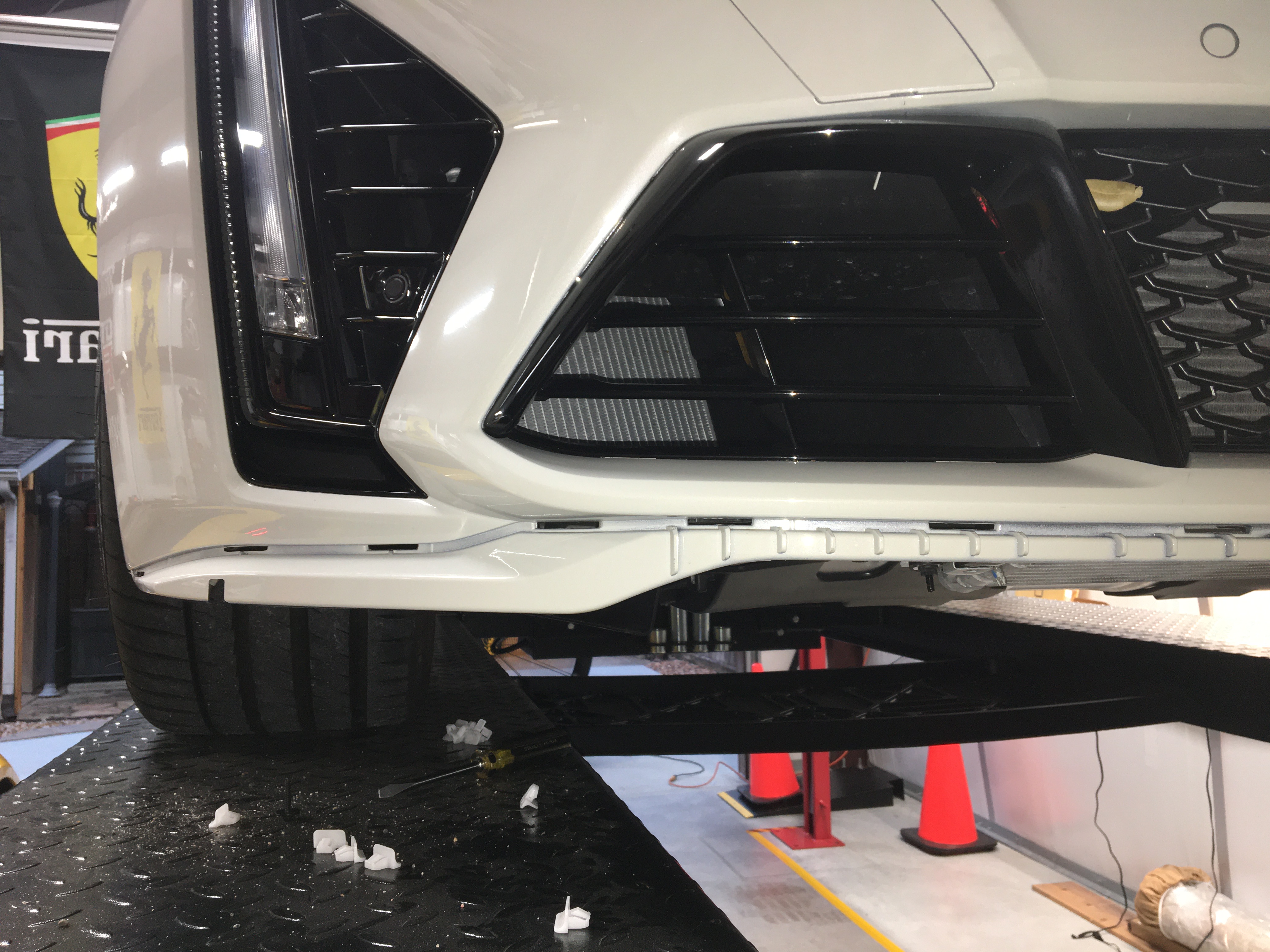

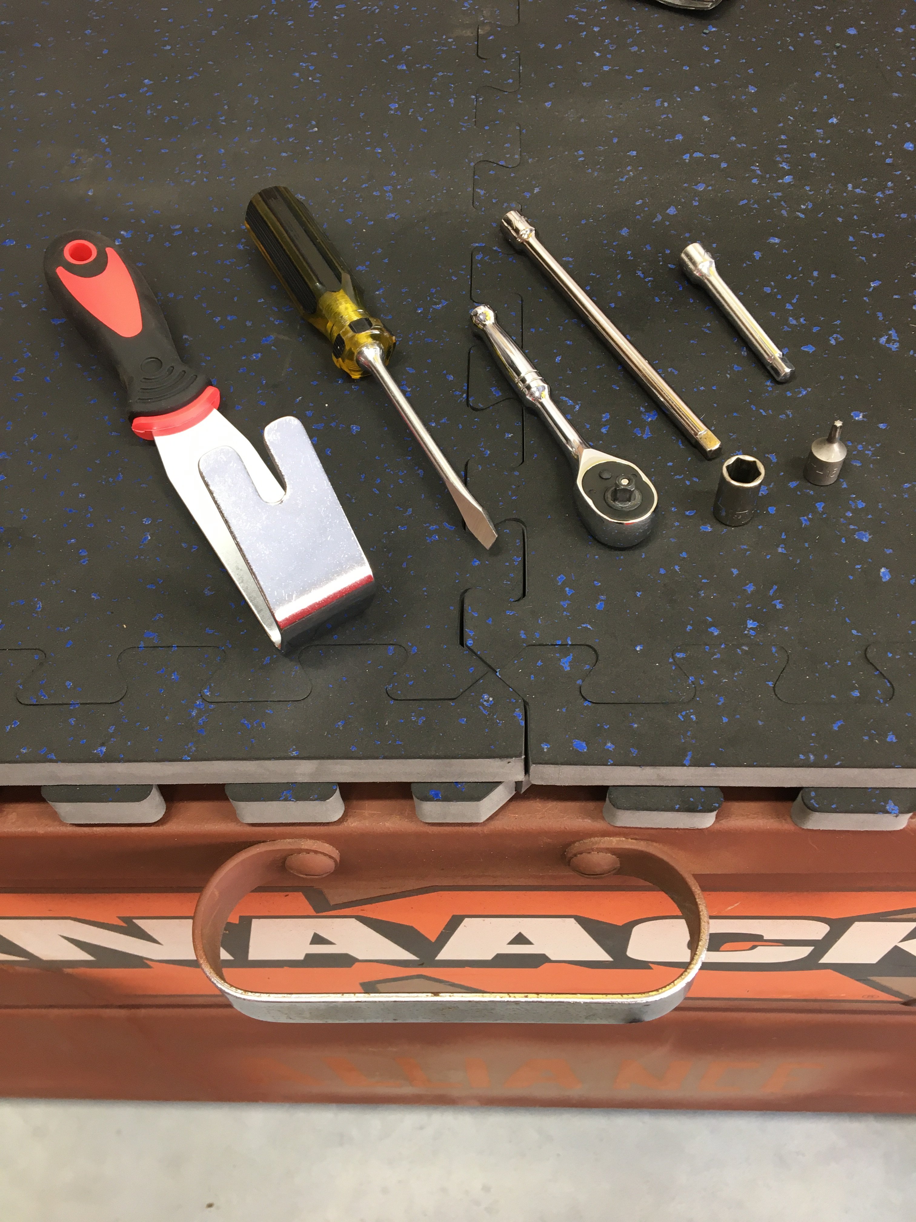

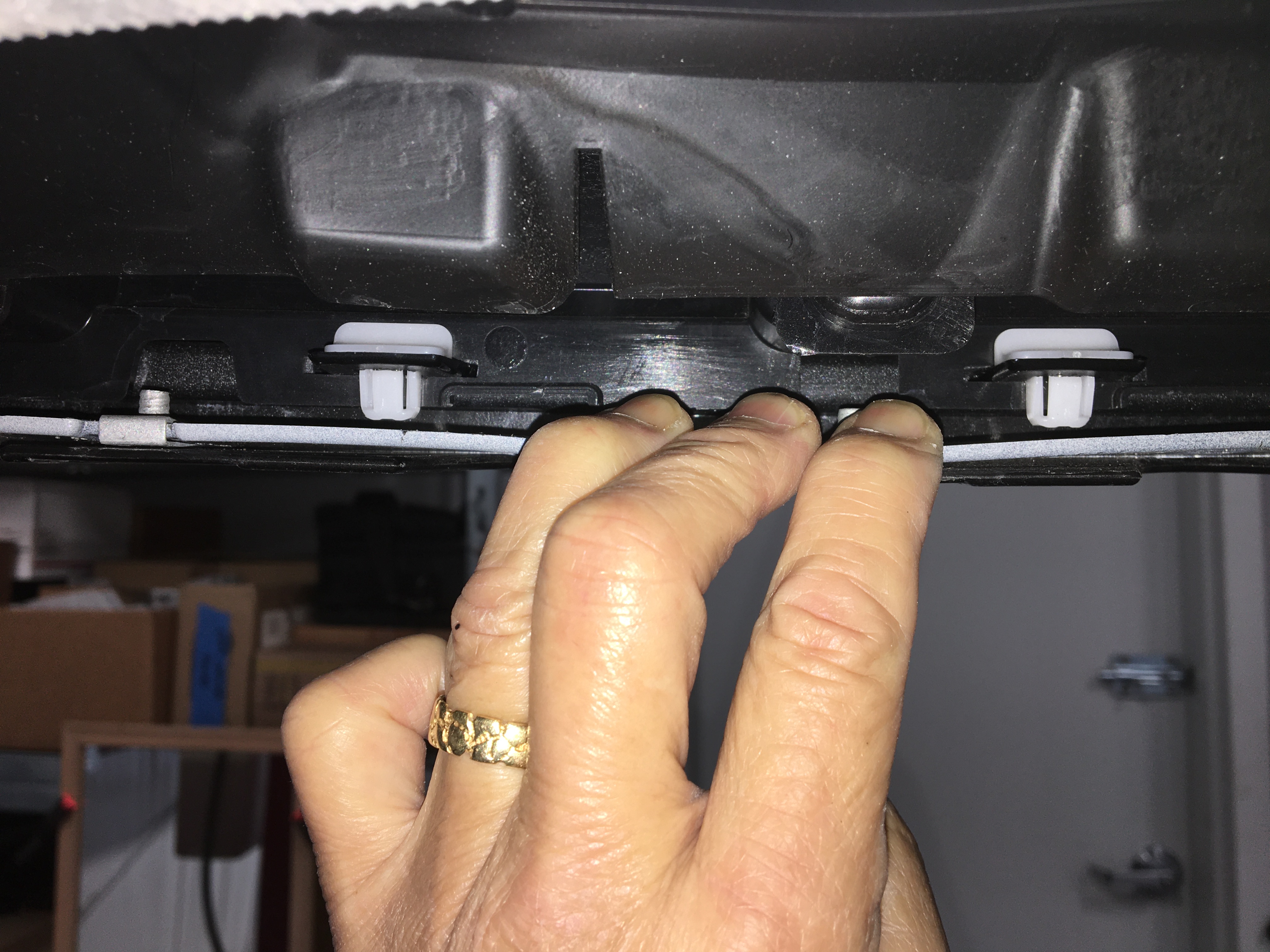

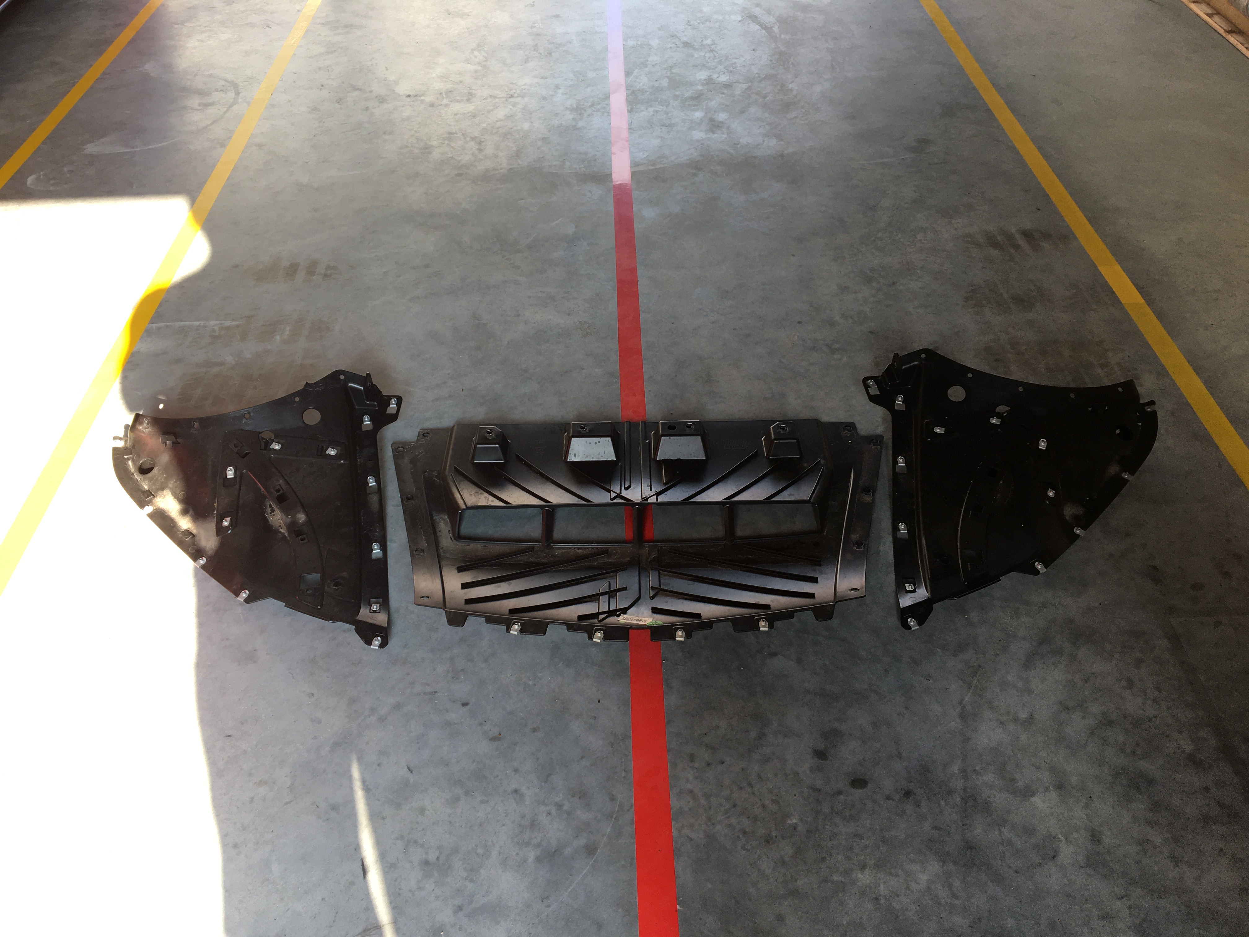

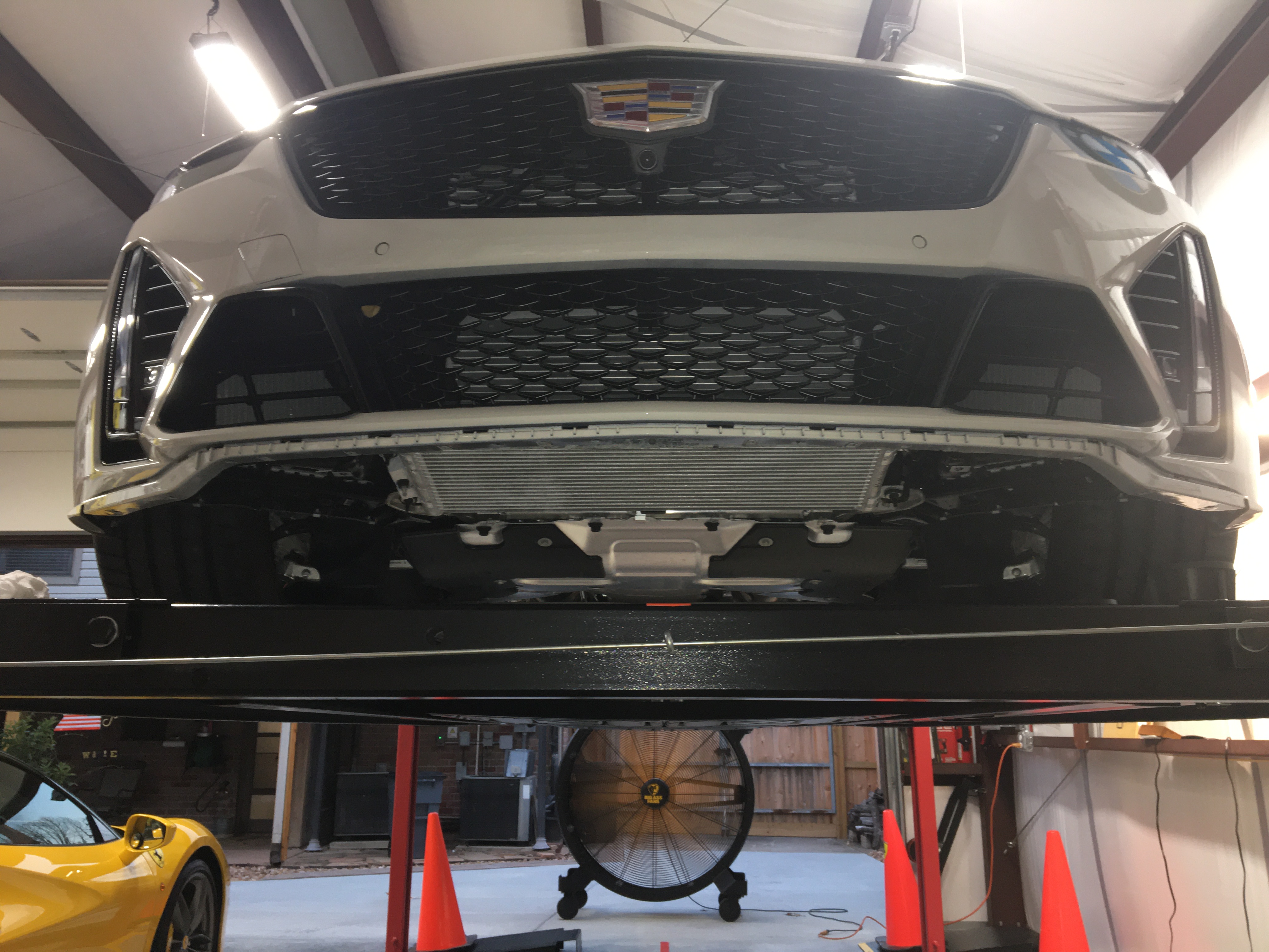

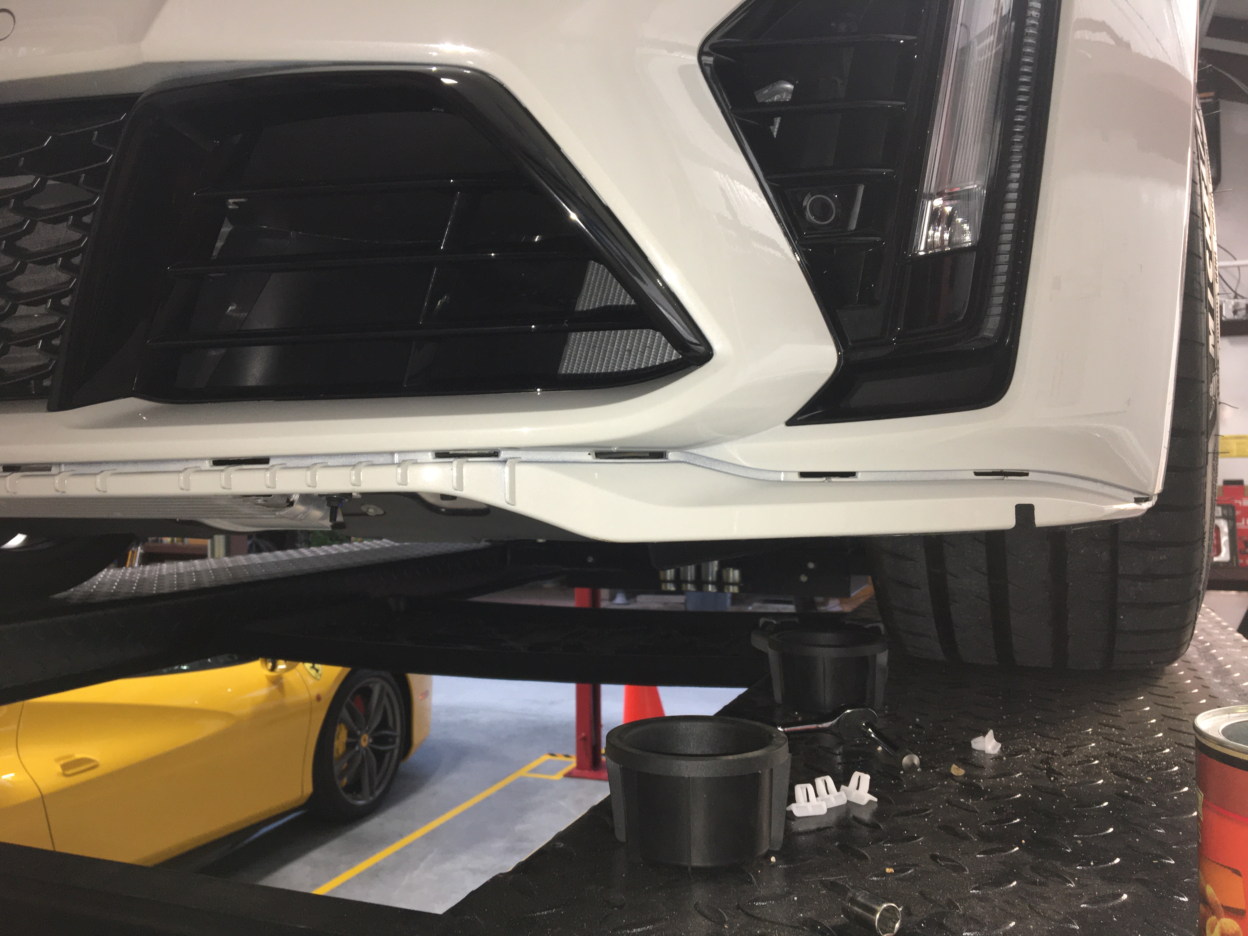

Can you please share this knowledge with us?

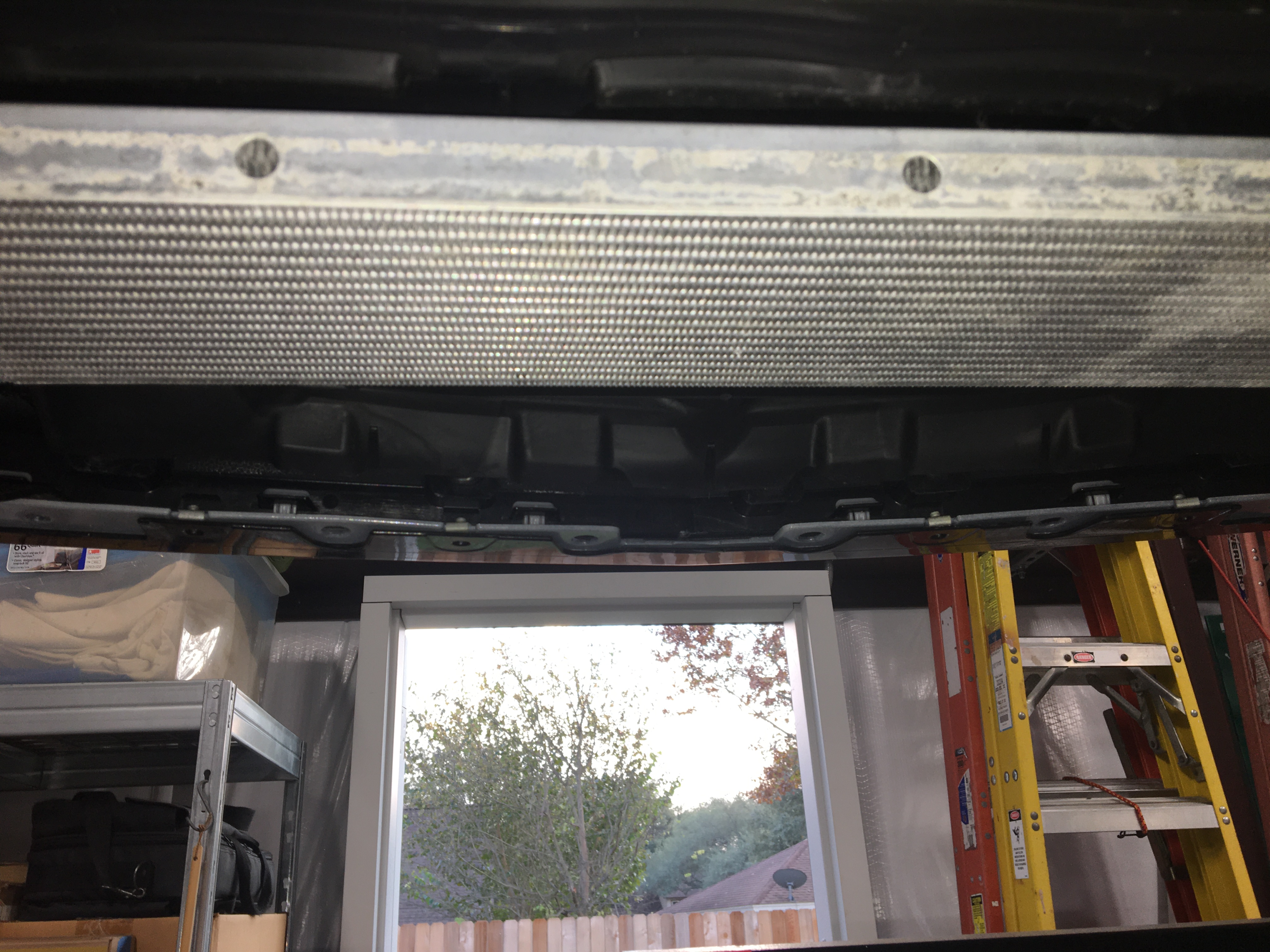

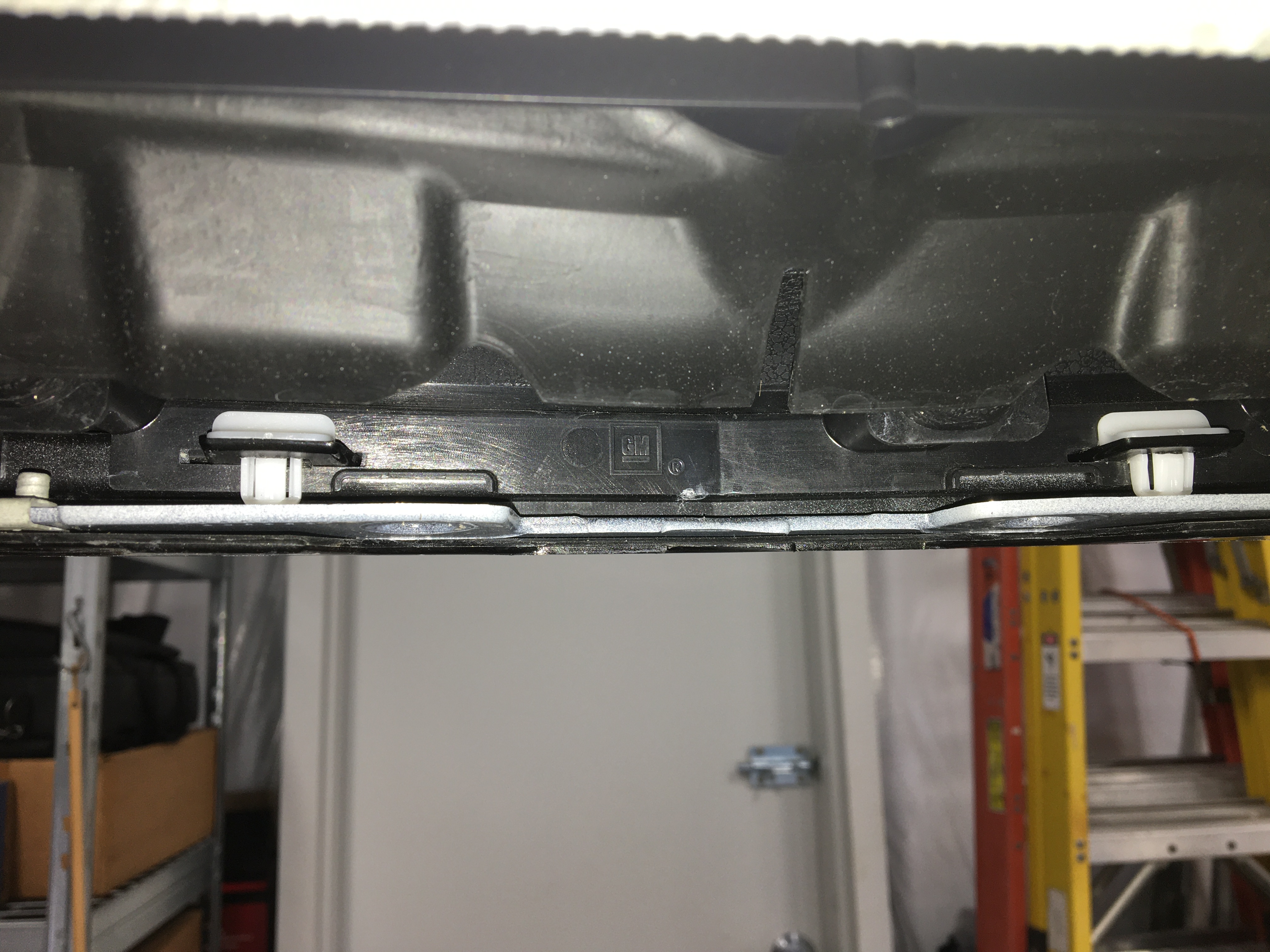

Sure, I'll do what I can. Not many tools needed, a large flat blade screwdriver, a T-15 socket, a 10 mm socket, 4" and 6" extension, a ratchet and a tool to remove (1) trim finishing retainer. All 3 front lower covers have to come off to expose the white plastic clips that hold the front lip on to the lower bumper cover. I had the liberty of my car lift to do the job and would only imagine that if you didn't maybe have this option, you may find yourself using words you only reserve for very strong emotions.
